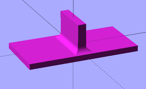

I think you mean that you want to re-create a part like this one, and you
want to be able to do the curved 'fillet' between the main plate and the
raised mount.
The way you can do this is to make the plate and the mount so that they
overlap, and put both inside a union() {.....}
Make the mount wider than you want it to be, by 2x the radius of the fillet
you want.
Translate the parts so that the TOP surface of the plate on Z=0.
Then, you want to take a cylinder with the radius of the fillet you want,
make it easily long enough to be wider than the whole part.  Rotate it over
so that it is in line with the fillet you want to make.
Translate it up to Z=fillet radius, so it is lying on the surface of the
plate. Translate it horizontally so its centre overlaps the EXTRA width of
the mount, and its edges are at the correct width.
Now, copy that cylinder, paste it and translate the copy in Z so it is way
above the  parts.  Then put both inside a hull() {.....}
Use difference() to cut the new cylinder hull out of the union above.  Then
copy-paste the cylinder hull over to the other side to do the same on the
other side.
This should get you what you are after!

Example:
fillet_radius = 10;
mount_width = 15;
            union()
                            //plate
                            translate([0,0,-5])
cube([200,100,10],center=true);
                            //mount
                            translate([0,0,25])
cube([mount_width+fillet_radius*2,75,50],center=true);
            hull()
translate([mount_width/2+fillet_radius,0,fillet_radius])
                                            rotate([90,0,0])
cylinder(200,fillet_radius,fillet_radius,center=true);
translate([mount_width/2+fillet_radius,0,fillet_radius+200])
                                            rotate([90,0,0])
            hull()
translate([-mount_width/2-fillet_radius,0,fillet_radius])
                                            rotate([90,0,0])
translate([-mount_width/2-fillet_radius,0,fillet_radius+200])
                                            rotate([90,0,0])

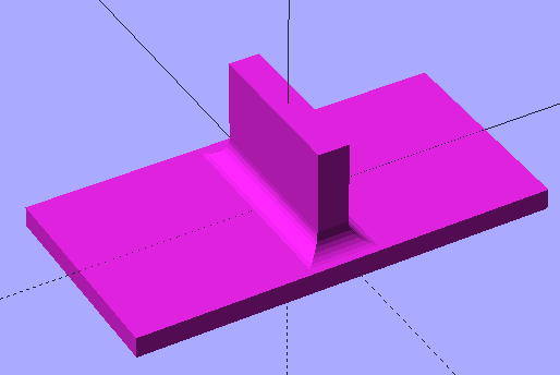

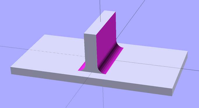

On 2019-11-22 13:36, ats3788 wrote:
How an we do The Soft connection to the plate in OpenSCad
http://forum.openscad.org/file/t2425/Monitor_Mount.jpg
Determine the fillet radius r and add 2*r thickness in all directions to
the parts mentioned below.
Union two "plates" defined as cubes. One for the "horizontal plate" and
one for the "vertical". No holes or cutouts at this stage, but add 2*r
to all directions so we can "machine" away a thickness of r on all sides
later and obtain the correct dimensions.
Create a cube enclosing the unioned parts 100% and subtract the unioned
parts from it. You now have a cube with an internal void shaped by your
object. Run minkowski() on that using a sphere with the required fillet
radius. Subtract the result of minkowski() from your original union. Now
you have two parts with a fillet with given radius between them.
Punch the holes as required.

Here's an example of that.  It's better, as it gives both fillets, if you
want them the same radius:
fillet_radius = 10;
mount_width = 15;
module shape_inflated()
            union()
                            //plate
                            translate([0,0,-5])
cube([200+fillet_radius2,100+fillet_radius2,10+fillet_radius*2],center=tru
e);
                            //mount
                            translate([0,0,25])
cube([mount_width+fillet_radius2,75+fillet_radius2,50+fillet_radius*2],cen
ter=true);
            shape_inflated();
            minkowski()
cube([500,500,500],center=true);
                                            shape_inflated();
                            sphere(fillet_radius);

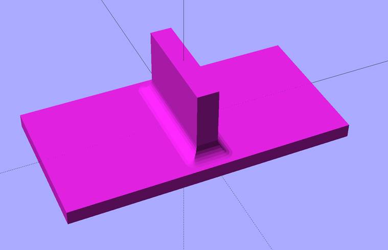

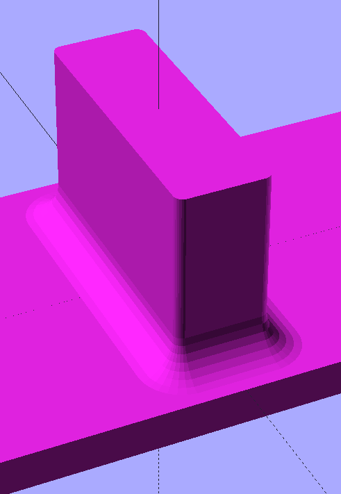

An even cleaner way to code that is below - has the same result but you can
stick any shape you like into 'original_shape' module, and it will get the
same treatment.
fillet_radius = 10;
mount_width = 15;
module original_shape()
            union()
                            //plate
                            translate([0,0,-5])
                            //mount
                            translate([0,0,25])
cube([mount_width,75,50],center=true);
            minkowski()
                            original_shape();
cube([fillet_radius2,fillet_radius2,fillet_radius*2]);
            shape_inflated();
            minkowski()
                                            shape_inflated();

So this works well for square-edged items.  I wanted to check how well my
example would work for  rounded shapes.  Not so well.
In this case the 'mount' is supposed to have rounded ends being the union of
two cylinders.  But the cubes I used to inflate the original piece
overpowered the original shape's radii:

So, If the same is run again, but making sure the radii on the original part
are bigger than the fillet radius, you get something closer to the expected
output - but still distorted:
