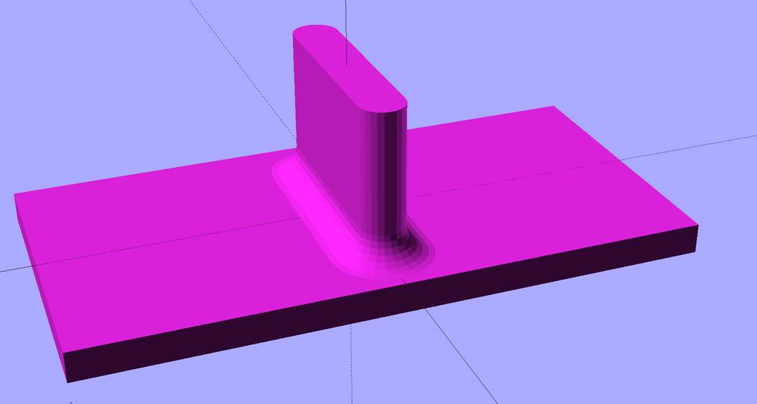

I plowed on in the same vein as the previous example, but using TWO
minkowski spheres, one to inflate, and the next to cut.
After 5 HOURS of rendering, I got the intended result:
Here's the slightly tweaked code:
fillet_radius = 10;
mount_width = 15;
module original_shape()
 union()
       //plate
       translate([0,0,-5])
            cube([200,100,10],center=true);
       //mount
       hull()
            translate([0,75/2-mount_width/2,25])
                 cylinder(50,mount_width/2,mount_width/2,center=true);
            translate([0,-75/2+mount_width/2,25])
module shape_inflated()
 minkowski()
       original_shape();
       sphere(fillet_radius);
 shape_inflated();
 minkowski()
            cube([500,500,500],center=true);
            shape_inflated();
Doing a minkowski with sphere operation on an already completed minkowski
sphere is super intensive to code, so i will be keen to try any other ways
to achieve the same result.!

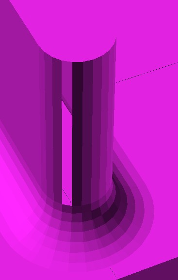

Also, I showed the good side above;  here is the other side, with either a
render defect or a hole in the mesh.!
Alex Gibson

Sun, Nov 24, 2019 2:26 AM
I wrote a module specifically to handle this sort of problem.  My module,
offset_sweep, constructs a polygon from a set of polygons offset from a
given polygon.  You have to supply the starting shape as a point sequence
rather than geometry.  I contributed by function to the BOSL2 library.
Here's the code:
include<BOSL2/std.scad>
include<BOSL2/rounding.scad>
fillet_radius = 10;
mount_width = 15;
mount_length = 75;
rectangle = square([mount_width, mount_length],center=true);
round_rectangle = round_corners(rectangle, measure="radius",
size=mount_width/2,$fn=64);
cuboid([200,100,10],anchor=TOP);
offset_sweep(round_rectangle, height=50,
bottom=os_circle(r=-fillet_radius));
And here's the result, which previews in 1s and renders in 3s on my machine.
http://forum.openscad.org/file/t2477/round_thing.png
