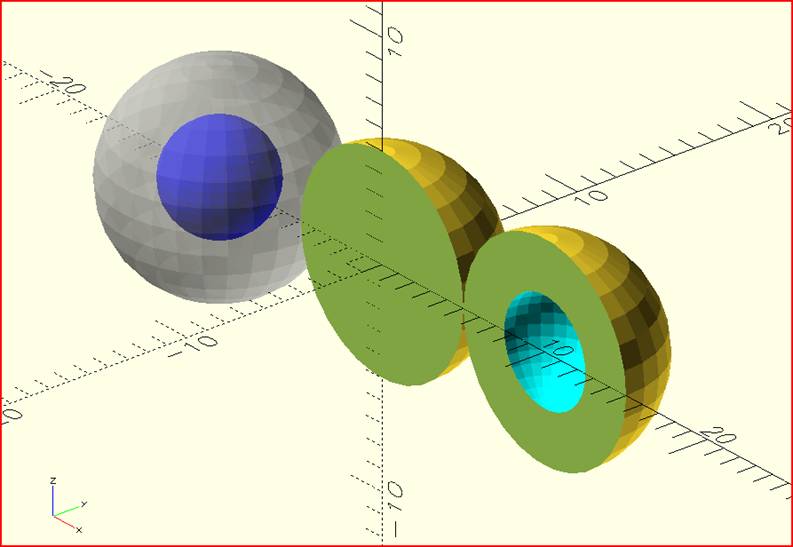

Michael Marx (spintel)
Sat, May 30, 2026 3:43 AM
that a closed surface and a solid object are not quite the same thing,
i.e. that a manifold STL is inherently hollow.
That is if you focus on surface, as a thin layer, it is not, the surface is a boundary.
Consider the green insides below, in the middle. It IS the solid, defined by the boundary.
It is different to the right side hollow cyan space, inside a solid.
So hollow must be created, by differencing. That is absence of solid.
Re Glenn's winding, the winding of the cyan is reversed, so the inside face is the hollow surface facing inwards.
Code:
$fs=0.2;
translate([-10,0,0])
hollowSphereShow(10,5,"blue");
sphere(d=10);
translate([-15,-30,-15])
    cube([30,30,30]);
translate([10,0,0])
    hollowSphere(10,5,"cyan");
        cube([30,30,30]);
module hollowSphere(outD,inD,colIn=undef) {
    sphere(d=outD);
    color(colIn) sphere(d=inD);
module hollowSphereShow(outD,inD,colIn=undef) {
    %sphere(d=outD);

Lee, the technical mathematical definition of a 2-dimensional manifold is
a surface that looks locally like a plane at every point, or more formally,
one where you can map a neighborhood of every point continuously into the
plane.  In 3d modeling we are using the 2d manifold to define a 3d object
by specifying its boundary.  If the manifold is bounded (and orientable--a
technical condition) then it has an inside and an outside and the points
inside will form a well-behaved bounded 3d solid.  (Examples of unbounded
manifolds: plane, paraboloid, infinitely long cylinder.  Bounded: sphere,
torus.  Bounded but not orientable: klein bottle.)

The explanation of what “manifold”, the geometric concept, means, that I
learned and seems simple and understandable, is that an ant walking on the
surface will never fall off an edge, and will never be presented with
multiple choices of which surface to walk on next. A bit more formally,
every edge is connected to exactly two faces, and the surface never
intersects itself.
With respect to Manifold, the library, and CGAL: OpenSCAD supports those
two libraries for doing geometric operations like unions, differences, and
so on.  CGAL is the library that it has used for many years; Manifold is a
newer and far faster library.  Manifold (or perhaps the way that OpenSCAD
uses it) seems to be more tolerant of imperfection.

(A picture would be worth a thousand words, but if I could draw the picture in OpenSCAD, I wouldn’t be asking the question. 😊)
Picture an arbitrary bounded non-planar surface hovering above a plane. Projection gives you its “shadow” on that plane (X/Y by convention). What I want is to fill the space between the surface and the shadow in the Z direction to produce a solid.
Maybe a better way to describe it is a 3D extrusion, although even that assumes the surface, and by extension the derived solid, is convex in Z.
And yet another conceptual picture: in CorelDraw,  draw a square and then draw a non-linear curve through it, forming two new 2D shapes. Fill one of them and export as an SVG. (“Smart Fill” in Corel creates a new filled 2D object, I assume Inkscape has a similar function.) I just want to extend that concept to 3D.

I don't understand the question you're asking, or the description in the 3rd paragraph.  If you slice a cube into two pieces....it's two pieces...and...?  If you project a manifold onto an arbitrary plane you'll get a set of points on the plane.  Then what...?  You want a triangle mesh for the projection?
On Sat, May 30, 2026 at 11:35 AM Lee DeRaud via Discuss <discuss@lists.openscad.org mailto:discuss@lists.openscad.org > wrote:
Yeah, we’re kinda getting into some theoretical weeds here…
Change of perspective: consider slicing a cuboid into two pieces using an arbitrary surface. And by arbitrary, I mean like a bounded chunk of mesh or surface points coming from a 3D scanner.
Alternatively, consider it as a 3D extension of ‘projection()’ from an arbitrary non convex surface. I can compute a ‘line’ (more precisely a sequence of points) projecting from any given point on the surface to an arbitrary base plane. Repeating at any desired density eventually gives me a dense, more-or-less solid point-cloud. But how do I then generate a triangle mesh that wraps that quasi-solid?
(Note: I have no real confidence that OpenSCAD can handle either case. Most likely  I’d end up using something like open3d.)
draw the picture with pen and paper, post a photo, or scan.
if you are thinking that the non-planar surface is 2d, I've no idea how
you work with that in a 3d world. If it is the surface of a 3d object,
then linear extrude the projection, and difference the object.
convex in Z.

I’ve attached an example surface. What I want is to fill the volume between it and the XY plane. I realize that creating this particular shape as the top surface of a cuboid can be done easily: that’s how I generated it in the first place. But I’m looking for a generalized that works with a surface extracted from a 3D scan.
And yes, I understand that this kind of surface is not 2D. Linear extruding the projection of it works right up until you get to  the lower bound of the surface. If you go past that point, the extrusion wipes out part of the surface, if you stop there, there will be gaps between the extrusion and the surface. Difference is zero help, as it just leaves a cuboid with a surface-shaped slice through it and no way to separate the two disjoint portions.
that concept to 3D.
for the projection?
