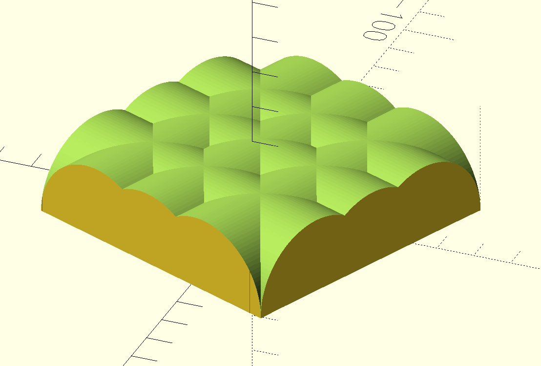

Here you go.
Pretty generic, but parameters, trial and error, or calculate. Based on
Adrian's stacked slices, no bosl2. You may or may not get z fighting
with other shapes.

On 30/05/2026 20:14, Lee DeRaud via Discuss wrote:
I’ve attached an example surface. What I want is to fill the volume
between it and the XY plane. I realize that creating this particular
shape as the top surface of a cuboid can be done easily: that’s how I
generated it in the first place. But I’m looking for a generalized
that works with a surface extracted from a 3D scan.
And yes, I understand that this kind of surface is not 2D. Linear
extruding the projection of it works right up until you get to  the
lower bound of the surface. If you go past that point, the extrusion
wipes out part of the surface, if you stop there, there will be gaps
between the extrusion and the surface. Difference is zero help, as it
just leaves a cuboid with a surface-shaped slice through it and no way
to separate the two disjoint portions.

Here you go. Pretty generic, but parameters, trial and error, or calculate. Based on Adrian's stacked slices, no bosl2. You may or may not get z fighting with other shapes. module one(){ import("C:/Users/ray/Desktop/TestSurface.stl"); } // Parameters t = 0.9;    // Thickness of each thin layer (allow for overlap) layers = 40; // Number of layers to stack slice=30; //level to slice //////////////////////// module some(){ // Stack the layers to make a solid union() {     for (i = [0:layers-1]) {       translate([0, 0, i * t])       one();     }   } } module prof(){    projection(cut=true)translate([0,0,-slice])some(); } module base(){    linear_extrude(slice)prof(); } module under(){   difference(){    scale([0.999,0.999,0.999])base(); //to avoid z fighting    some();  } } under(); On 30/05/2026 20:14, Lee DeRaud via Discuss wrote: > > I’ve attached an example surface. What I want is to fill the volume > between it and the XY plane. I realize that creating _this_ particular > shape as the top surface of a cuboid can be done easily: that’s how I > generated it in the first place. But I’m looking for a generalized > that works with a surface extracted from a 3D scan. > > And yes, I understand that this kind of surface is not 2D. Linear > extruding the projection of it works right up until you get to  the > lower bound of the surface. If you go past that point, the extrusion > wipes out part of the surface, if you stop there, there will be gaps > between the extrusion and the surface. Difference is zero help, as it > just leaves a cuboid with a surface-shaped slice through it and no way > to separate the two disjoint portions. > > *From:*Raymond West via Discuss <discuss@lists.openscad.org> > *Sent:* Saturday, May 30, 2026 11:37 AM > *To:* Lee DeRaud via Discuss <discuss@lists.openscad.org> > *Cc:* Raymond West <raywest@raywest.com> > *Subject:* [OpenSCAD] Re: beginners question > > On 30/05/2026 18:30, Lee DeRaud via Discuss wrote: > > (A picture would be worth a thousand words, but if I could draw > the picture in OpenSCAD, I wouldn’t be asking the question. 😊) > > draw the picture with pen and paper, post a photo, or scan. > > Picture an arbitrary bounded non-planar surface hovering above a > plane. Projection gives you its “shadow” on that plane (X/Y by > convention). What I want is to fill the space between the surface > and the shadow in the Z direction to produce a solid. > > if you are thinking that the non-planar surface is 2d, I've no idea > how you work with that in a 3d world. If it is the surface of a 3d > object, then linear extrude the projection, and difference the object. > > Maybe a better way to describe it is a 3D extrusion, although even > that assumes the surface, and by extension the derived solid, is > convex in Z. > > And yet another conceptual picture: in CorelDraw,  draw a square > and then draw a non-linear curve through it, forming two new 2D > shapes. Fill one of them and export as an SVG. (“Smart Fill” in > Corel creates a new filled 2D object, I assume Inkscape has a > similar function.) I just want to extend that concept to 3D. > > *From:*Adrian Mariano via Discuss <discuss@lists.openscad.org> > <mailto:discuss@lists.openscad.org> > *Sent:* Saturday, May 30, 2026 9:35 AM > *To:* OpenSCAD general discussion Mailing-list > <discuss@lists.openscad.org> <mailto:discuss@lists.openscad.org> > *Cc:* Adrian Mariano <avm4@cornell.edu> <mailto:avm4@cornell.edu> > *Subject:* [OpenSCAD] Re: beginners question > > I don't understand the question you're asking, or the description > in the 3rd paragraph.  If you slice a cube into two pieces....it's > two pieces...and...? If you project a manifold onto an arbitrary > plane you'll get a set of points on the plane.  Then what...?  You > want a triangle mesh for the projection? > > On Sat, May 30, 2026 at 11:35 AM Lee DeRaud via Discuss > <discuss@lists.openscad.org> wrote: > > Yeah, we’re kinda getting into some theoretical weeds here… > > Change of perspective: consider slicing a cuboid into two > pieces using an arbitrary surface. And by arbitrary, I mean > like a bounded chunk of mesh or surface points coming from a > 3D scanner. > > Alternatively, consider it as a 3D extension of ‘projection()’ > from an arbitrary non convex surface. I can compute a ‘line’ > (more precisely a sequence of points) projecting from any > given point on the surface to an arbitrary base plane. > Repeating at any desired density eventually gives me a dense, > more-or-less solid point-cloud. But how do I then generate a > triangle mesh that wraps that quasi-solid? > > (Note: I have no real confidence that OpenSCAD can handle > either case. Most likely  I’d end up using something like open3d.) > > *From:*Adrian Mariano via Discuss <discuss@lists.openscad.org> > *Sent:* Saturday, May 30, 2026 7:10 AM > *To:* OpenSCAD general discussion Mailing-list > <discuss@lists.openscad.org> > *Cc:* Adrian Mariano <avm4@cornell.edu> > *Subject:* [OpenSCAD] Re: beginners question > > Lee, the technical mathematical definition of a 2-dimensional > manifold is a surface that looks locally like a plane at every > point, or more formally, one where you can map a neighborhood > of every point continuously into the plane.  In 3d modeling we > are using the 2d manifold to define a 3d object by specifying > its boundary. If the manifold is bounded (and orientable--a > technical condition) then it has an inside and an outside and > the points inside will form a well-behaved bounded 3d solid.  > (Examples of unbounded manifolds: plane, paraboloid, > infinitely long cylinder.  Bounded: sphere, torus.  Bounded > but not orientable: klein bottle.) > > On Fri, May 29, 2026 at 10:35 PM Lee DeRaud via Discuss > <discuss@lists.openscad.org> wrote: > > One thing about this subject in general: my brain persists > in the illusion(?) that a closed surface and a solid > object are not *quite* the same thing, i.e. that a > manifold STL is inherently hollow. > Is this a distinction without a difference? > > -----Original Message----- > From: Glenn Butcher via Discuss <discuss@lists.openscad.org> > Sent: Friday, May 29, 2026 6:03 PM > To: discuss@lists.openscad.org > Cc: Glenn Butcher <glenn.butcher@gmail.com> > Subject: [OpenSCAD] Re: beginners question > > I recently finished writing code to do a specific sort of > mesh, stone walls, and ran into all the fussiness of > making 'manifold' meshes.  I then wrote a short blog post > on why STL files are problematic representing object > boundaries: > > https://glenn.pulpitrock.net/blog/posts/2025-12-21-whats-so-bad-about-stl-files/ > > Tried to make it understandable; anyone has questions, > post them here. > > Glenn > > On 5/29/2026 5:29 PM, Jordan Brown via Discuss wrote: > > The explanation of what “manifold”, the geometric > concept, means, that I learned and seems simple and > understandable, is that an ant walking on the surface will > never fall off an edge, and will never be presented with > multiple choices of which surface to walk on next. A bit > more formally, every edge is connected to exactly two > faces, and the surface never intersects itself. > > > > With respect to Manifold, the library, and CGAL: > OpenSCAD supports those two libraries for doing geometric > operations like unions, differences, and so on.  CGAL is > the library that it has used for many years; Manifold is a > newer and far faster library. Manifold (or perhaps the way > that OpenSCAD uses it) seems to be more tolerant of > imperfection. > > _______________________________________________ > > OpenSCAD mailing list > > To unsubscribe send an email to > discuss-leave@lists.openscad.org > _______________________________________________ > OpenSCAD mailing list > To unsubscribe send an email to > discuss-leave@lists.openscad.org > _______________________________________________ > OpenSCAD mailing list > To unsubscribe send an email to > discuss-leave@lists.openscad.org > > _______________________________________________ > OpenSCAD mailing list > To unsubscribe send an email to discuss-leave@lists.openscad.org > > > > _______________________________________________ > > OpenSCAD mailing list > > To unsubscribe send an email todiscuss-leave@lists.openscad.org > > > _______________________________________________ > OpenSCAD mailing list > To unsubscribe send an email todiscuss-leave@lists.openscad.org

If you have a surface with an edge defined as a point list it's a simple matter in openscad to make that into a solid by extending it down to the xy plane---assuming that no points on the surface are below the bounding edge by building a polyhedron for your original surface and then adding edges and a base.  BOSL2 provides textured_tile() and plot3d() that can do this directly and handle the annoying bookkeeping of building the polyhedron.  You can also potentially have more flexibility (and more work) with vnf_vertex_array().
If you don't have the surface as a point list then it's going to be a lot more difficult, especially in the general case.  The shape you posted you could do by taking the union of a bunch of translated copies.  Other folks are better at figuring out complex ways to get stuff done in vanilla OpenSCAD....  But that shape also looks like it was (or could be) constructed mathematically  in which case it would be ideally suited to using textured_tile() or plot3d().
Here's the method of translated copies:
include<BOSL2/std.scad>
module thing(){
import("TestSurface.stl");
zcopies(n=30,spacing=.9) thing();
down(20)linear_extrude(height=30)projection()thing();
I’ve attached an example surface. What I want is to fill the volume between it and the XY plane. I realize that creating this particular shape as the top surface of a cuboid can be done easily: that’s how I generated it in the first place. But I’m looking for a generalized that works with a surface extracted from a 3D scan.
And yes, I understand that this kind of surface is not 2D. Linear extruding the projection of it works right up until you get to  the lower bound of the surface. If you go past that point, the extrusion wipes out part of the surface, if you stop there, there will be gaps between the extrusion and the surface. Difference is zero help, as it just leaves a cuboid with a surface-shaped slice through it and no way to separate the two disjoint portions.
From: Raymond West via Discuss  mailto:discuss@lists.openscad.org discuss@lists.openscad.org
Sent: Saturday, May 30, 2026 11:37 AM
To: Lee DeRaud via Discuss  mailto:discuss@lists.openscad.org discuss@lists.openscad.org
Cc: Raymond West  mailto:raywest@raywest.com raywest@raywest.com
(A picture would be worth a thousand words, but if I could draw the picture in OpenSCAD, I wouldn’t be asking the question. 😊)
Picture an arbitrary bounded non-planar surface hovering above a plane. Projection gives you its “shadow” on that plane (X/Y by convention). What I want is to fill the space between the surface and the shadow in the Z direction to produce a solid.
if you are thinking that the non-planar surface is 2d, I've no idea how you work with that in a 3d world. If it is the surface of a 3d object, then linear extrude the projection, and difference the object.
Maybe a better way to describe it is a 3D extrusion, although even that assumes the surface, and by extension the derived solid, is convex in Z.
And yet another conceptual picture: in CorelDraw,  draw a square and then draw a non-linear curve through it, forming two new 2D shapes. Fill one of them and export as an SVG. (“Smart Fill” in Corel creates a new filled 2D object, I assume Inkscape has a similar function.) I just want to extend that concept to 3D.
From: Adrian Mariano via Discuss  mailto:discuss@lists.openscad.org discuss@lists.openscad.org
Sent: Saturday, May 30, 2026 9:35 AM
To: OpenSCAD general discussion Mailing-list  mailto:discuss@lists.openscad.org discuss@lists.openscad.org
Cc: Adrian Mariano  mailto:avm4@cornell.edu avm4@cornell.edu
I don't understand the question you're asking, or the description in the 3rd paragraph.  If you slice a cube into two pieces....it's two pieces...and...?  If you project a manifold onto an arbitrary plane you'll get a set of points on the plane.  Then what...?  You want a triangle mesh for the projection?
On Sat, May 30, 2026 at 11:35 AM Lee DeRaud via Discuss <discuss@lists.openscad.org mailto:discuss@lists.openscad.org > wrote:
Change of perspective: consider slicing a cuboid into two pieces using an arbitrary surface. And by arbitrary, I mean like a bounded chunk of mesh or surface points coming from a 3D scanner.
Alternatively, consider it as a 3D extension of ‘projection()’ from an arbitrary non convex surface. I can compute a ‘line’ (more precisely a sequence of points) projecting from any given point on the surface to an arbitrary base plane. Repeating at any desired density eventually gives me a dense, more-or-less solid point-cloud. But how do I then generate a triangle mesh that wraps that quasi-solid?
(Note: I have no real confidence that OpenSCAD can handle either case. Most likely  I’d end up using something like open3d.)

Sun, May 31, 2026 12:50 AM
On 5/29/2026 8:34 PM, Lee DeRaud via Discuss wrote:
One thing about this subject in general: my brain persists in the illusion(?) that a closed surface and a solid object are not quite the same thing, i.e. that a manifold STL is inherently hollow.
I don't think so.  I think the difference starts to matter when you
start trying to really support color, because then you have the question
of whether colors apply to the surfaces, or also to the space inside the
shape.  For most 3D graphics what you're interested in is the color on
the surface, but I think that for 3D printing what you're interested in
is the color of the volume. (And then it gets even harder if you try to
overlap at the boundaries for better strength.)
On 5/29/2026 8:34 PM, Lee DeRaud via Discuss wrote: > One thing about this subject in general: my brain persists in the illusion(?) that a closed surface and a solid object are not *quite* the same thing, i.e. that a manifold STL is inherently hollow. > Is this a distinction without a difference? I don't think so.  I think the difference starts to matter when you start trying to really support color, because then you have the question of whether colors apply to the surfaces, or also to the space inside the shape.  For most 3D graphics what you're interested in is the color on the surface, but I think that for 3D printing what you're interested in is the color of the volume. (And then it gets even harder if you try to overlap at the boundaries for better strength.)
Sun, May 31, 2026 12:52 AM
It doesn't (yet?) work for OpenSCAD data, only for imported data, but
what you described is the surface() operation.  Well, at least when the
surface is defined as a grid.
Mostly, it shouldn't be too hard to build an appropriate polyhedron.
Just, as always when building polyhedra, tedious.
On 5/30/2026 11:30 AM, Lee DeRaud via Discuss wrote: > > (A picture would be worth a thousand words, but if I could draw the > picture in OpenSCAD, I wouldn’t be asking the question. 😊) > > Picture an arbitrary bounded non-planar surface hovering above a > plane. Projection gives you its “shadow” on that plane (X/Y by > convention). What I want is to fill the space between the surface and > the shadow in the Z direction to produce a solid. > It doesn't (yet?) work for OpenSCAD data, only for imported data, but what you described is the surface() operation.  Well, at least when the surface is defined as a grid. Mostly, it shouldn't be too hard to build an appropriate polyhedron.  Just, as always when building polyhedra, tedious.
