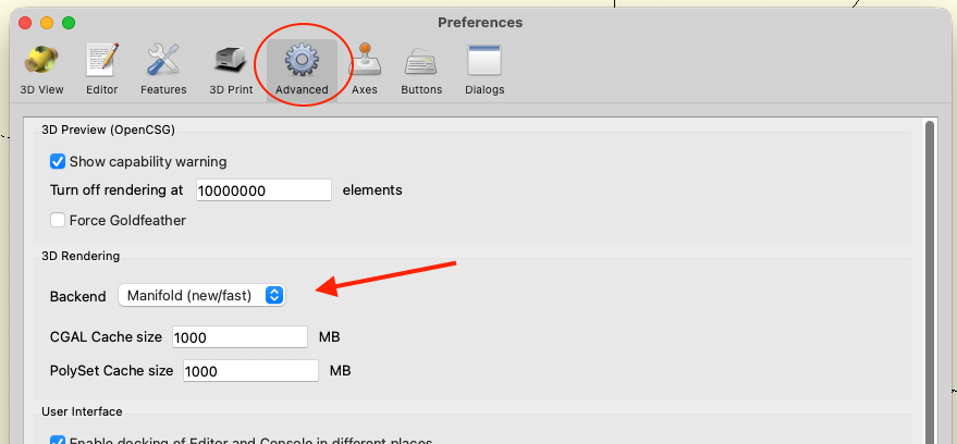

Fri, May 29, 2026 5:57 AM
[image: Screenshot 2026-05-28 at 10.56.17 PM.png]
OpenSCAD version 2025.05.30 (git f0e24928c)

If you switch to "manifold" as opposed to CGAL you get a few benefits.
  1. It is orders of magnitude faster in some cases.(*)
  2. it accepts many of the STLs that CGAL doesn't.
You need to move to a reasonably recent openscad, and possibly
go into the preferences to enable manifold.
On my version it is  edit -> preferences -> features -> Manifold.

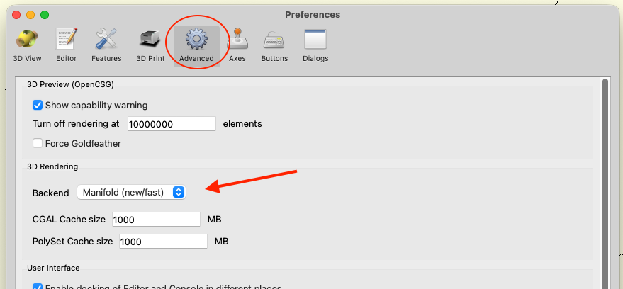

[image: Screenshot 2026-05-28 at 10.56.17 PM.png] OpenSCAD version 2025.05.30 (git f0e24928c) On Thu, May 28, 2026 at 10:52 PM Karl Exler via Discuss < discuss@lists.openscad.org> wrote: > I am using version 2021.01 .. the german App-Image and in this version > there is no possibility to change between "manifold" and "CGAL".. > > By the way. if there is an german speaking helping hand.. coul someone > explain "manifold" in this context in German ?? > Vielen Dank > Karl > Am 28.05.26 um 17:25 schrieb Rogier Wolff via Discuss: > > On Thu, May 28, 2026 at 04:22:14PM +0200, Karl Exler via Discuss wrote: > > Dear all! > > I found a beautiful cone on Thingiverse and build some changes to use it for > my purposes. F5 works great, but when I print F6 I receive an error message: > > ERROR: The given mesh is not closed! Unable to convert to > CGAL_Nef_Polyhedron. What can I do, that OpenScad renders this object > correctly? many thanks in advance Karl > > OpenScad has, for ages, used the CGAL library for rendering the > geometry that you've defined. > > About two years ago someone started a project to replace CGAL. It is > called "manifold". The openscad programmers, have for a while kept the > feature "included, but disabled by default" to allow for more > testing. I'm not sure if it would be "enabled by default" on the most > recent version or not. That said, if you have the latest stable release > it certainly has it available! > > If you switch to "manifold" as opposed to CGAL you get a few benefits. > > 1) It is orders of magnitude faster in some cases.(*) > 2) it accepts many of the STLs that CGAL doesn't. > > You need to move to a reasonably recent openscad, and possibly > go into the preferences to enable manifold. > On my version it is edit -> preferences -> features -> Manifold. > > Even is the maintainers haven't enabled it by default, I've never seen > a problem caused by manifold, on the contrary I've had big struggles > with exactly the problem you've been having. > > I previously was under the impression that everybody on the internet > was producing and sharing "bad", "broken" STL files. As "manifold" > does accept them, it seems that the problem with those STLs somehow > originate in CGAL. > > Somehow I am under a strong impression that you're still using > CGAL: > > ERROR: ... CGAL_Nef_Polyhedron.... > > Roger. > > (*) It doesn't really matter if your render takes 0.001 or 0.1 > seconds. But once it renders in half a second as opposed to 10 > minutes, you start to appreciate the speed. :-) > > > _______________________________________________ > OpenSCAD mailing list > To unsubscribe send an email to discuss-leave@lists.openscad.org

Jupiduuuu .. I found a newer nighlty built with this settings and now
the file is renderd perfectly.
On my version it is
originate in CGAL.
CGAL:
