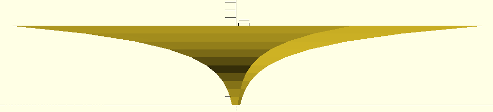

Mon, Dec 16, 2019 3:26 AM
Oops, I accidentally hit send.
I'm going to clean this code up & release it on GitHub, and I haven't
decided on a license yet, but this draft is licensed CC0 & you can use it
in your project if you wish. Attribution would be nice but isn't strictly
necessary.
The module assumes that your model is centred at the origin. It sweeps down
the object, starting from the top, and takes a 2D slice, which it scales to
a particular size. You'll need to write a function that maps the height to
a vector with the size of the 2D bounding box at that height (e.g.
[[height1, [x1, y1,], [height2, [x2, y2]]...] ). You'll want to play with
different values of precision as well. Lower values = more precise.
In the code is a simple example which turns a cylinder into an exponential
flare.
As I said, I haven't tested it extensively, but it appears to be outputting
manifold models.
Cheers,
Max

If you want to scale your model only in XY, say by .9 leaving Z as it
is, you
can use
scale([.9, .9, 1]) model();
but there is no conic (or even more general nonlinear) transformation in
OpenSCAD that will map a cylindric object into a truncated cone object
or
similar.
However you can extrude an object into a truncated cone object, e.g. by
using
linear_extrude(height = 10, scale = 0.9)  myModel2D();
module myModel2D() circle(10);
Oops, I accidentally hit send. I'm going to clean this code up & release it on GitHub, and I haven't decided on a license yet, but this draft is licensed CC0 & you can use it in your project if you wish. Attribution would be nice but isn't strictly necessary. The module assumes that your model is centred at the origin. It sweeps down the object, starting from the top, and takes a 2D slice, which it scales to a particular size. You'll need to write a function that maps the height to a vector with the size of the 2D bounding box at that height (e.g. [[height1, [x1, y1,], [height2, [x2, y2]]...] ). You'll want to play with different values of precision as well. Lower values = more precise. In the code is a simple example which turns a cylinder into an exponential flare. As I said, I haven't tested it extensively, but it appears to be outputting manifold models. Cheers, Max On Sun, Dec 15, 2019 at 7:57 PM Max Bond <max.o.bond@gmail.com> wrote: > Hi Bryan, > > I got nerdsniped by this problem and had a pleasant Sunday evening writing > a solution to it. > > The code needs to be cleaned up, it's slow (because it uses resize()), and > I haven't tested it on complex models yet, but it should do what you want > it to do. > > I'm goin > > On Sun, Dec 15, 2019 at 3:24 PM Max Bond <max.o.bond@gmail.com> wrote: > >> *but it should work. >> >> On Sun, Dec 15, 2019 at 3:23 PM Max Bond <max.o.bond@gmail.com> wrote: >> >>> There's nothing you can do with multmatrix() that you can't do with a >>> series of other transformations (rotate(), translate(), scale(), etc). All >>> it really lets you do is apply multiple transformations at once, which, if >>> you ask me, only serves to obscure the programmer's intentions. Look into >>> Affine transformations if you'd like more information. >>> >>> If Parkinbot's suggeston doesn't work for your particular use case (and >>> it sounds like you're stuck in 3D since you're using import()), you might >>> try cutting your model into pieces by sweeping across it with a thin >>> cube(), and then scaling these pieces & union()'ing them together. It'll be >>> tricky, and you'll have to be careful so as not to create zero-width gaps, >>> but >>> >>> Something to the effect of: >>> >>> function f(h) = ...some function defining your flare (reciprocal >>> function perhaps)... >>> for (i=[0:depth:myModelHeight/depth]) { >>> scale([f(i), f(i), 1]) intersection() { >>> translate([0, 0, i]) cube([modelX, modelY, depth]); >>> myModel(); >>> } >>> } >>> >>> Note this psuedocode doesn't account for zero-width gaps. Depending on >>> the geometry of your model you may have to create small extrusions that >>> join each section together to prevent ZWGs. Another approach might be to >>> sweep the cube() up your model, use projection() to turn that section into >>> 2D, and then use Parkinbot's approach. >>> >>> Cheers, >>> Max >>> >>> On Sun, Dec 15, 2019 at 5:38 AM Parkinbot <rudolf@digitaldocument.de> >>> wrote: >>> >>>> If you want to scale your model only in XY, say by .9 leaving Z as it >>>> is, you >>>> can use >>>> >>>> scale([.9, .9, 1]) model(); >>>> >>>> but there is no conic (or even more general nonlinear) transformation in >>>> OpenSCAD that will map a cylindric object into a truncated cone object >>>> or >>>> similar. >>>> >>>> However you can extrude an object into a truncated cone object, e.g. by >>>> using >>>> >>>> linear_extrude(height = 10, scale = 0.9) myModel2D(); >>>> module myModel2D() circle(10); >>>> >>>> >>>> >>>> >>>> -- >>>> Sent from: http://forum.openscad.org/ >>>> >>>> _______________________________________________ >>>> OpenSCAD mailing list >>>> Discuss@lists.openscad.org >>>> http://lists.openscad.org/mailman/listinfo/discuss_lists.openscad.org >>>> >>>
