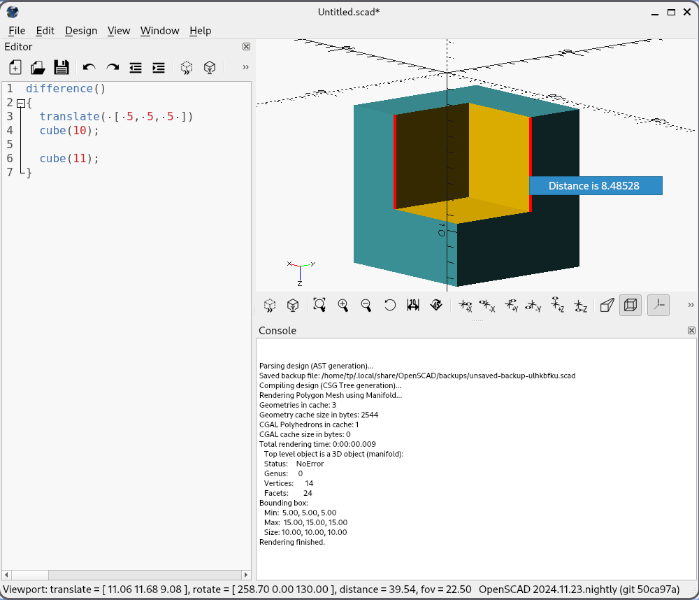

Sun, Nov 24, 2024 3:54 PM
Here's an example where Measure is not working for me on OpenSCAD version
2024.11.23 (git 50ca97a0b)
translate( [ 5, 5, 5 ])
cube(10);
cube(11);
Can someone corroborate this? Thanks.

Sun, Nov 24, 2024 4:08 PM
Nope, works just fine.
- You have to enable Manifold as linked in the previous post
- Measurement works only with F6 mesh render, not F5 preview
See screenshot.
1) You have to enable Manifold as linked in the previous post
2) Measurement works only with F6 mesh render, not F5 preview
See screenshot.

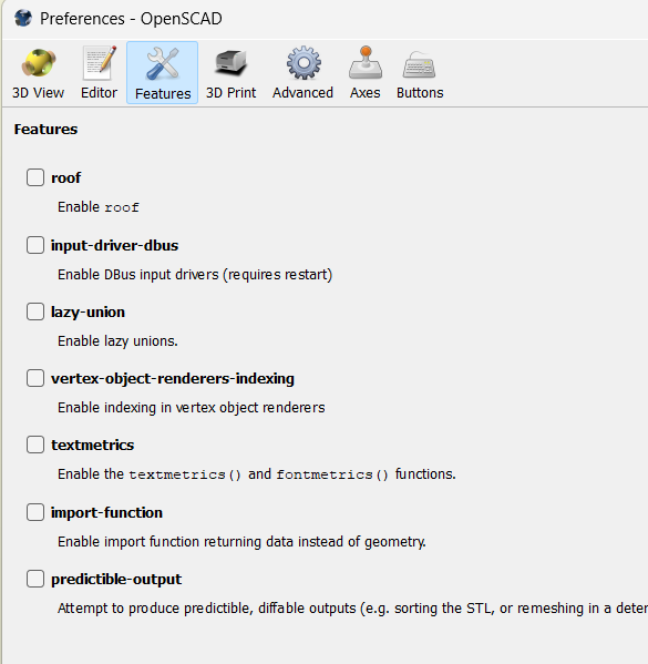

Sun, Nov 24, 2024 4:23 PM
OpenSCAD Version: 2024.11.23 (git 50ca97a0b)
System information: Microsoft Windows 11 (10.0.22631) x86_64 16 CPUs 15.77
GB RAM
User Agent: OpenSCAD/2024.11.23 (git 50ca97a0b) (Microsoft Windows 11
(10.0.22631) x86_64)
Compiler: GCC "13.2.0" 64bit
MinGW build: MingW64
Debug build: No
Boost version: 1_81
Also, manifold is not on the Feature page for me. How do I enable it?
On Sun, Nov 24, 2024 at 10:17 AM Torsten Paul via Discuss <

Sun, Nov 24, 2024 4:27 PM
Quoting https://fosstodon.org/@OpenSCAD/113256867413539398
"Starting with nightly build 2024.09.28, the Manifold geometry backend
is no longer experimental: It’s now possible to choose between the two
geometry backends in Preferences->Advanced->3D Rendering->Backend."

Sun, Nov 24, 2024 4:31 PM
OK, fold manifold. Enabled it, restarted OpenSCAD and Measure mostly works.
For this model, it does not measure to any line where the two cubes meet.
Is that a limitation?
