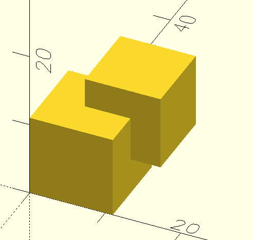

// Value is correct
cube([40,40,40]);
translate([20,20,20])
cube([40,40,40]);
//Calculated value 34.641 mm.
// Check vector
translate([40,-0,0])
rotate([-35,45,0])
#cube([0.1,0.1,34.641]);

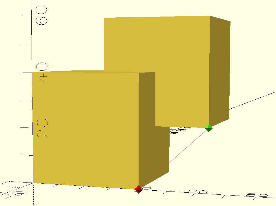

On 24-Nov-24 5:31 PM, Leonard Martin Struttmann via Discuss wrote:
OK, fold manifold.  Enabled it, restarted OpenSCAD and Measure mostly
works.
For this model, it does not measure to any line where the two cubes
meet. Is that a limitation?
