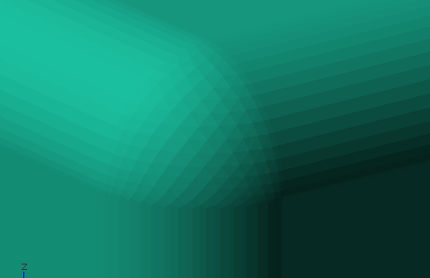

function cornerPatchCP(P0,d,r0=0.5) =
let( dx = d*[1,0,0],
dy = d*[0,1,0],
dz = d*[0,0,1] )
[ [for(j=[0:4]) P0+dx+dy],
cCP([P0+dx+(1-r0)dy, P0+(dx+dy)(1-r0), P0+dx*(1-r0)+dy],r0),
cCP([P0+dx, P0, P0+dy], r0),
cCP([P0+dx+(1-r0)*dz, P0+(1-r0)*dz, P0+dy+(1-r0)*dz],r0),
cCP([P0+dx+dz, P0+dz, P0+dy+dz],r0) ];
function cCP(p,r0=0.5) =
[ p[0],
p[0]+r0*(p[1]-p[0]),
p[1],
p[2]+r0*(p[1]-p[2]),
p[2] ];
This is the fastest strategy I can imagine. The points sampled from the
corner patches are collected in a simple list which will be the vertices of
the fake polyhedron to be hulled. That fake polyhedron has just one face
collecting all the vertex indices. This polyhedron is defective and it is
not a manifold at all but that polyhedron is not really built, just hulled.
The second aspect of the code is that it samples the corner patch in an non
uniform distribution in the parameter space. The sample rate is poor near
the collapsed row of the rectangular patch and increases linearly up to the
opposed patch edge. As the patch is really triangular, the sampling is
geometrically more uniform.
[image: cornerSampling.PNG]
I haven't tried your code yet (although I have borrowed some lines of code
from it :) ) but I believe this last code is faster. It renders the cube in
1s with $fn=50 and in 12s with $fn=100.
Anyway, "fast" is of course always relative, because any further Boolean
operation will take its time with these vertex monsters.
It is not a monster. The number of vertices of the rounded cube is about
the same of one sphere with the same $fn. So, I would not expect anything
worst than the boolean operation with a sphere. In fact, it required just
9s to difference a cylinder crossing a rounded edge with $fn=32.
