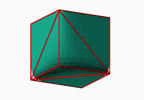

I have made an attempt at the triangular bezier patch.  I do not know if I
have picked parameters that achieve continuous curvature, but the patch is
looking reasonable.  Here is one corner, with control points displayed.
There are 3 control points that appear "free" in some sense---that is, not
falling on the edge with their value already determined to achieve the
continuous curvature edge curve.
http://forum.openscad.org/file/t2477/tribez2.png

I have made an attempt at the triangular bezier patch. I do not know if I have picked parameters that achieve continuous curvature, but the patch is looking reasonable. Here is one corner, with control points displayed. There are 3 control points that appear "free" in some sense---that is, not falling on the edge with their value already determined to achieve the continuous curvature edge curve. <http://forum.openscad.org/file/t2477/tribez2.png> Here's the code. It seems like computing the bezier points is kind of slow, but I don't know if there's a more clever way to do it. h=0.6; corner = [0,0,0]; dx = [-1,0,0]; dy = [0,-1,0]; dz = [0,0,-1]; P1 = corner-dx-dy; P2 = corner-dx-dz; P3 = corner-dy-dz; P12 = corner-dx; P13 = corner-dy; P23 = corner-dz; P2face = corner-h*dx-h*dz; P1face = corner - h*dx-h*dy; P3face = corner-h*dy-h*dz; P = [ [P1, P12+h*(P1-P12), P12, P12+h*(P2-P12), P2], [P13 + h*(P1-P13), P1face, P2face, P23+h*(P2-P23)], [P13, P3face, P23], [P13 + h*(P3-P13), P23 + h*(P3-P23)], [P3] ]; sdx=1/16; pts = ( [for(u=[0:sdx:1]) each [for(v=[0:sdx:1-u]) tribez(P,u,v)]]); echo(len(pts), "points"); fastpointhull(pts); //polyhedron(pts, faces=hull(pts)); function tribez(P,u,v) = len(P) == 1 ? P[0][0] : let( n = len(P)-1, Pu = [for(i=[0:n-1]) select(P[i],[1:len(P[i])-1])], // select(P[i],1,-1)], Pv = [for(i=[0:n-1]) select(P[i],[0:len(P[i])-2])], // select(P[i],0,len(P[i])-2)], Pw = select(P,[1:n]) ) tribez(u*Pu+v*Pv+(1-u-v)*Pw,u,v); %cube(size=[1,1,1]); module fastpointhull(points){ //points = simplify3d_path(points); // colinear points are not on the hull and generate a warning message extra = len(points)%3; list = concat( [[for(i=[0:extra+2])i]], [for(i=[extra+3:3:len(points)-3])[i,i+1,i+2]]); hull() polyhedron(points, faces=list); } function select(vector,indices) = [ for (index = indices) vector[index] ]; -- Sent from: http://forum.openscad.org/

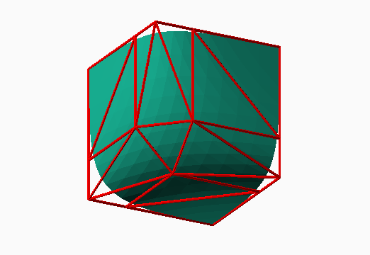

Nice work! I was following the same route but with degree 6 triangular
patch which is, I suppose, the minimum degree to have curvature continuity.
But I could not find a good way to compute curvature for triangular patches
to check my models. Anyway, I am afraid that the 3 CPs you consider free to
shape the surface should have precise positions to get curvature
continuity. I have drawn the triangular grid of your CPs and got the
following image with h=0.3.
As the central triangle is not coplanar with any of the corner planes I
think we would not have zero cross border second derivative at the patch
borders. Perhaps we get zero cross border curvature with h=0 but that is
too much restrictive.
My next step will be to compute the cross border curvature to check the

adrianv <avm4@cornell.edu> wrote: > I have made an attempt at the triangular bezier patch. I do not know if I > have picked parameters that achieve continuous curvature, but the patch is > looking reasonable. Here is one corner, with control points displayed. > There are 3 control points that appear "free" in some sense---that is, not > falling on the edge with their value already determined to achieve the > continuous curvature edge curve. > Nice work! I was following the same route but with degree 6 triangular patch which is, I suppose, the minimum degree to have curvature continuity. But I could not find a good way to compute curvature for triangular patches to check my models. Anyway, I am afraid that the 3 CPs you consider free to shape the surface should have precise positions to get curvature continuity. I have drawn the triangular grid of your CPs and got the following image with h=0.3. As the central triangle is not coplanar with any of the corner planes I think we would not have zero cross border second derivative at the patch borders. Perhaps we get zero cross border curvature with h=0 but that is too much restrictive. My next step will be to compute the cross border curvature to check the surface models.
Fri, Mar 29, 2019 5:23 PM
Looks like a patch, but it doesn't make a smooth connection on rotation ...
translate([-1, -1])fastpointhull(pts);
rotate([0,0,90])
http://forum.openscad.org/file/t887/patch.png
