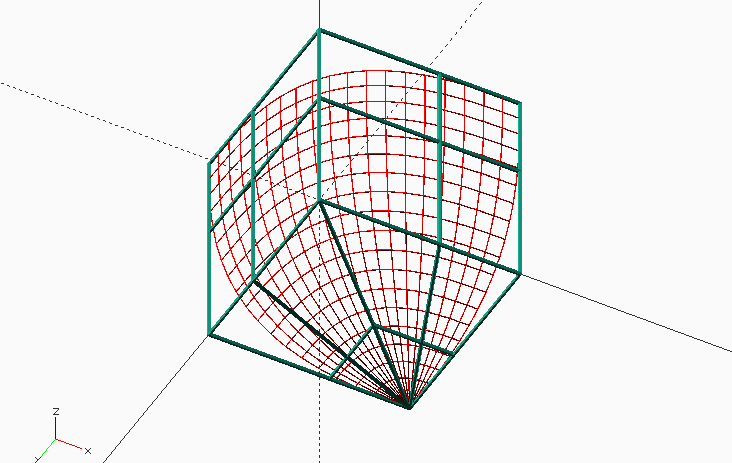

The following image shows the mesh of control points (CPs) compared with
with the patch itself.
[image: cornerRounding-CP.PNG]
As can be seen, all CPs rest on the faces of the cube in an array where one
full row of the mesh is collapsed to a point. Some intermediate rows and
columns of the mesh are movable by changing a shape parameter, others CPs
have immutable positions. The mesh of CPs of a corner were computed by the

Although it is an awkward code, it was easier to be written following the
continuity conditions. The arguments of this function are:
P0 - the coordinates of the corner
d  - the extent of cube corner that will be rounded
r0 - a shape parameter equivalent to the shape parameter of the degree 4
curves with curvature continuity
From the CP matrix, we can sample points on the corner surface by
evaluating BPatchPoint(CPs,u,v) for various values of u and v in the
interval [0,1] and draw isoparametric lines or build a mesh for a
polyhedron call.

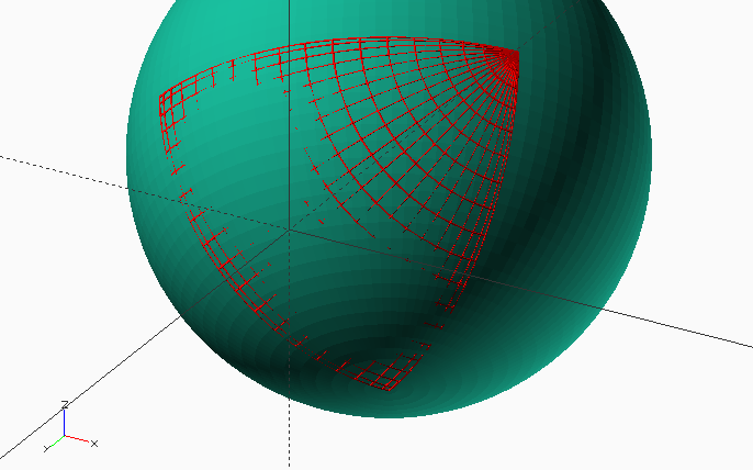

I don't like this solution. The collapse of one CP matrix row creates an
inconvenient asymmetry that can be observed by comparing the corner
rounding surface for r0 = 0.073 with the surface of a sphere:
[image: cornerRounding-sphere.PNG]
The image suggests that we have just one symmetry axis instead of 3 as
would be desirable.
Besides, a regular sample of parameters to compute points on the surface
are very irregular with a high concentration of points in the neighborhood
of the point the row was collapsed. That is a reason to pursuit a solution
based on Bezier triangular patches.

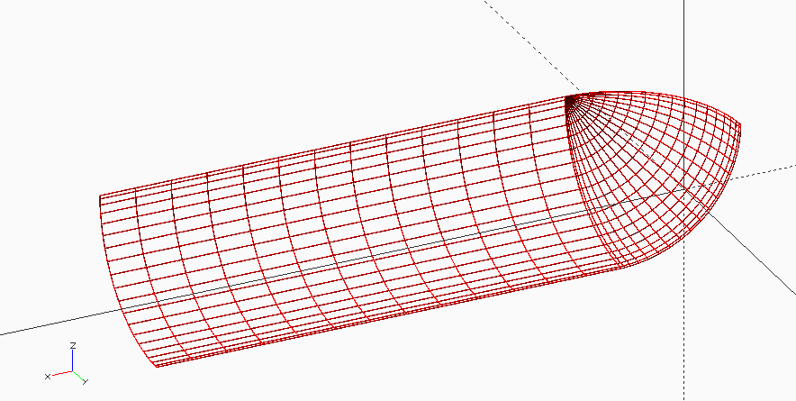

A BezierCube module implementing such a sweep on the basis of your Bezier
functions is shown by the following code. It renders in 0.5s  on my system.
However, the union test with a cube lasts 15s.
http://forum.openscad.org/file/t887/BezierCube2.png
