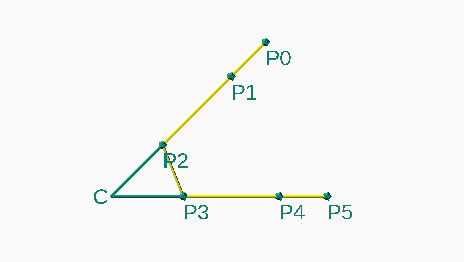

You are right, a degree 3 Bezier arc would at most be zero curvature at one
extreme and tangent continuous at the other. The minimal degree for a zero
curvature at each extremes is really 5. However, I would use a degree 6
Bezier arc because you get too restricted setting p2 to the vertex of the
polygon. I did a experiment with degree 6 with the following strategy.
[image: pc.PNG]
The collinearity of P0, P1 and P2 implies zero curvature of the arc at P0
besides the tangent to segment [C.P0]  (similarly for P5) .
The position of P2 (respect. P3) follows a ratio r0 in the interval (0,1)
in the segment [C,P0] (respect. [C,P5]).
The position of P1 (respect. P4) follows a ratio r1 in the interval (0,1)
in the segment [P2,P0] (respect. [P3,P5]).
This two ratios give some flexibility to the shape of the curve.

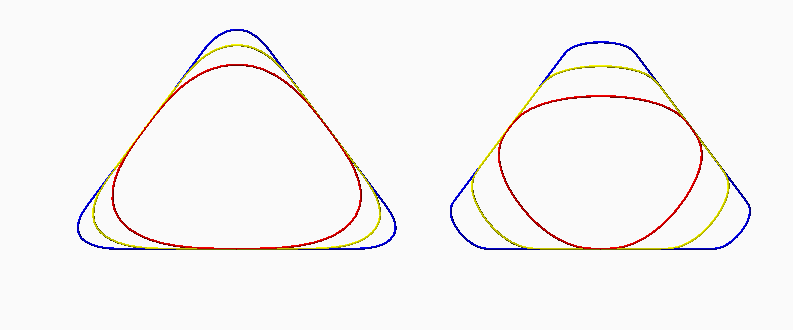

Here is a code that follows that strategy to round a polygon. I haven't
tried with non-convex polygons but it should work fine.
// polygon to be rounded
q = [ [0,0], [30,0], [15,20] ];
color("blue")  roundedPoly(q, 20, 1/5);
color("yellow") roundedPoly(q, 20, 1/3);
color("red")    roundedPoly(q, 20, 1/2);
translate([30,0,0]) {
color("blue")  roundedPoly(q, 20, 1/5, 1/3);
color("yellow") roundedPoly(q, 20, 1/3, 1/3);
color("red")    roundedPoly(q, 20, 1/2, 1/3);
module roundedPoly(p, n=20, r=1/4, r0=2/3, r1=1/2) {
assert(len(p)>2, "polygonal has less than 3 points");
assert(r>0 && r<1, "improper value of argument r");
l = len(p);
q = [for(i=[0:l-1])
let( p0 = (1-r)p[i] + rp[(i+l-1)%l] ,
p1 = p[i],
p2 = (1-r)p[i] + rp[(i+1)%l] )
each BZeroCurvature(p0,p1,p2,n,r0,r1) ];
line(q, closed=true);

I would not expect any good interface for Bezier stuffs could be designed
to solve a large set of problems to justify its implementation in the core
of OpenSCAD. Each modeling problem requires specific codes to be written
and that is easily done in users space if you have the needed mathematical
background. Anyway, to work with Bezier curves and surfaces, even using
other people good libraries, a minimal mathematical background is necessary.
You are right, a degree 3 Bezier arc would at most be zero curvature at one extreme and tangent continuous at the other. The minimal degree for a zero curvature at each extremes is really 5. However, I would use a degree 6 Bezier arc because you get too restricted setting p2 to the vertex of the polygon. I did a experiment with degree 6 with the following strategy. [image: pc.PNG] The collinearity of P0, P1 and P2 implies zero curvature of the arc at P0 besides the tangent to segment [C.P0] (similarly for P5) . The position of P2 (respect. P3) follows a ratio r0 in the interval (0,1) in the segment [C,P0] (respect. [C,P5]). The position of P1 (respect. P4) follows a ratio r1 in the interval (0,1) in the segment [P2,P0] (respect. [P3,P5]). This two ratios give some flexibility to the shape of the curve. Here is a code that follows that strategy to round a polygon. I haven't tried with non-convex polygons but it should work fine. // polygon to be rounded q = [ [0,0], [30,0], [15,20] ]; color("blue") roundedPoly(q, 20, 1/5); color("yellow") roundedPoly(q, 20, 1/3); color("red") roundedPoly(q, 20, 1/2); translate([30,0,0]) { color("blue") roundedPoly(q, 20, 1/5, 1/3); color("yellow") roundedPoly(q, 20, 1/3, 1/3); color("red") roundedPoly(q, 20, 1/2, 1/3); } module roundedPoly(p, n=20, r=1/4, r0=2/3, r1=1/2) { assert(len(p)>2, "polygonal has less than 3 points"); assert(r>0 && r<1, "improper value of argument r"); l = len(p); q = [for(i=[0:l-1]) let( p0 = (1-r)*p[i] + r*p[(i+l-1)%l] , p1 = p[i], p2 = (1-r)*p[i] + r*p[(i+1)%l] ) each BZeroCurvature(p0,p1,p2,n,r0,r1) ]; line(q, closed=true); } // a Bezier arc of degree 5 from p0 to p2, tangent to // [p0,p1] at p0, tangent to [p1,p2) at p2 and // with zero curvature at p0 and p2 // n = # of points in the arc // r0, r1 - form factors in the open interval (0,1) function BZeroCurvature(p0,p1,p2,n=20,r0=2/3,r1=1/2) = assert(r0>0 && r0<1 && r1>0 && r1<1, "improper value of r0 or r1") let( p = [ p0, p0 + r0*(p1-p0)*r1, p0 + r0*(p1-p0), p2 + r0*(p1-p2), p2 + r0*(p1-p2)*r1, p2 ] ) BezierCurve(p,n); // p are the curve control points, the curve degree is len(p)-1 function BezierCurve(p, n=10) = [for(i=[0:n-1]) BezierPoint(p, i/(n-1)) ]; function BezierPoint(p, u) = (len(p) == 2)? u*p[1] + (1-u)*p[0] : u*BezierPoint([for(i=[1:len(p)-1]) p[i] ], u) + (1-u)*BezierPoint([for(i=[0:len(p)-2]) p[i] ], u); module line(p,closed=false,w=0.1) for(i=[0:len(p)-(closed? 1:2)]){ hull(){ translate(to3d(p[i])) sphere(w); translate(to3d(p[(i+1)%len(p)])) sphere(w); } } function to3d(p) = len(p)==3 ? p : [p.x,p.y,0]; [image: roundedPoly.PNG] I would not expect any good interface for Bezier stuffs could be designed to solve a large set of problems to justify its implementation in the core of OpenSCAD. Each modeling problem requires specific codes to be written and that is easily done in users space if you have the needed mathematical background. Anyway, to work with Bezier curves and surfaces, even using other people good libraries, a minimal mathematical background is necessary.

I missed to mention that the argument r of roundedPoly() controls how much
of the corners are rounded. It has an effect similar to radius when
circular arcs are used.
one
I'm a little puzzled.  Maybe you are using the word degree differently than
I think?  I was thinking a degree 3 Bezier is a cubic polynomial and has 4
control points.  It can be set to zero curvature at both ends but has only
one degree of freedom, which just controls the size of the curve.  That
isn't enough.  It appears to me that degree 4, with 5 control points, is
sufficient.  Yes, you do need to put p2 on the vertex.  This doesn't seem to
cause any undesirable restriction, and it is definitely possible to satisfy
the zero curvature condition.  One parameter remains that controls the
degree of curvature, as I noted in my previous message.  Having fewer
parameters is often better than more, so I'm not sure about what the value
of more degrees of freedom is of going to the case with 6 control points
(which is a 5th degree polynomial).  I did experiment a bit with your code
and you can get some rather sharp cornered results.  It seemed like r1
usually had little effect.

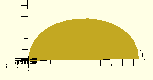

On Wed, Mar 13, 2019 at 12:52:07PM +0100, Rogier Wolff wrote:
On Wed, Mar 13, 2019 at 11:41:30AM +0000, nop head wrote:
Isn't it just some for loops and list comprehension? I don't think it is
much harder than sweep if you want a regular array of surface points.
Hmm.. Ok. Maybe it's doable... I'll give it a go later on. Maybe this
weekend. Feel free to remind me. I might forget.
[... I already wrote .. ]
wrong!
I started over. I now have a bezier curve in 2D. This is at $fn = 15,
the parameter has not yet been added to the function.
