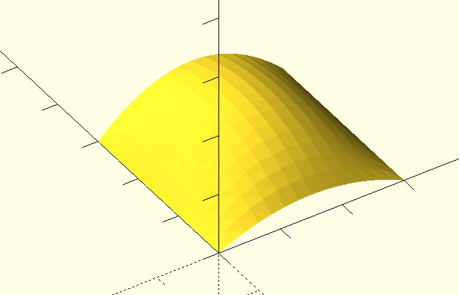

I now have a bezier patch in 3d: <see attachment>

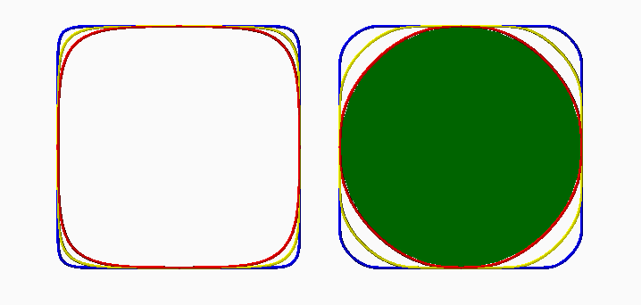

You are right regarding the degrees. I wrongly said 5 instead of 4 and 6
instead of 5. A degree n Bezier curve has n+1 control points.
However I disagree that you could meet the zero curvature constraint at
both end with degree 3 curves. To have a zero curvature at the beginning of
the arc, the first 3 control points should co-linear. The same is true for
the ending point. If we require zero curvature at both ends all four
control points should be co-linear and the arc reduces to a straight
segment.
Degree 4 is in fact the minimal degree for zero curvature at both ends for
a non-straight line Bezier arc. However degree 5 solution give us not only
more degrees of freedom but a better arc shape as will see bellow. Degree 4
solution produces an arc with a greater curvature variation and a more
pointed arc. Degree 5 shape is able to produce arcs that resemble circular
arcs.

And got the following image:
[image: roundedPoly2.PNG]
At left we have the arcs of degree 4 and at right the degree 5 alternative
for similar form factors. With r=1, which means that the straight lines
between arcs reduce to a point, drawn here with red lines, the degree 4
solution keeps the middle point of each arc much nearer to the polygon
vertex. With degree 5 on the other hand it is possible to get a good
approximation of a circular arc with r1~= 17/32, a value I got empirically.

It appears that your degree 4 code can also generate a nearly circular arc:
just set r1 very small, like .01 and you get something visually
indistinguishable from a circle.  In fact, it looks very similar to your
empirically determined 17/32 value.  I wonder what are the parameters for
the order 5 bezier that reduce it to the order 4.
On the left is order 4 with r1=0.01 and on the right, order 5 with r1=17/32.
http://forum.openscad.org/file/t2477/round2.png
r1=17/32.

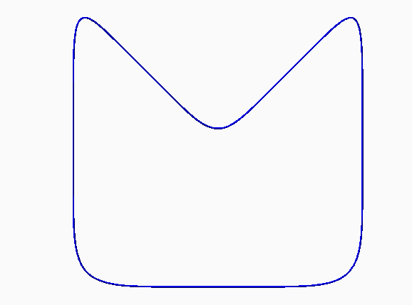

Finally, I have checked that my code works well even with not convex
polygons as can be seen in the image.
