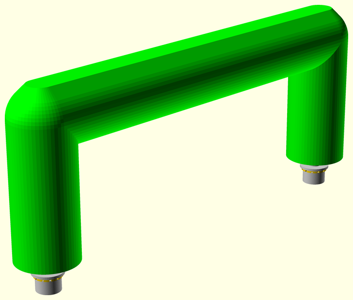

Fri, May 3, 2019 11:10 AM
I use an inverted truncated rotate_extruded teardrop on the bottom edges
of my rounded objects so they don't need support when printing. I assume
that is what a "teardrop edge" is.

Fri, May 3, 2019 3:32 PM
Yes, what I meant by "teardrop" is an edge which combines 45 degrees of a
circular arc with a bevel at 45 deg so that the edge can be 3d printed
without support---with the bevel down there are no unsupported areas at
lower than a 45 deg angle.
edges of my rounded objects so they don't need support when printing. I
assume that is what a "teardrop edge" is.
[image: handle.png]
