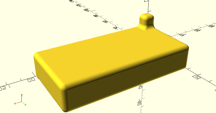

I have been experimenting with Minkowski rounding of this simple shape.
To preserve the original dimensions I use my version of sphere with poles
and equator and I inflate, erode by twice as much and inflate again to
round both the concave and convex corners. This took 45 minutes with $fn =
24. Curiously it stopped LibraOffice starting until it finished rendering.
I think time increases exponentially with $fn.
4 6
8 39
12 120
16 500
20 814
24 2745
Minkowski of a convex shape should be as fast as hull because all it needs
to do is take the hull of the the vertices of one shape offset by each of
the vertices of the other shape. For a concave shape it needs to decompose
it into convex shapes, Minkowski each in turn and union the resulting
hulls. The trouble is even union with lots of vertices is very slow with
CGAL. And when you erode inwards the shape is always going to be concave.
