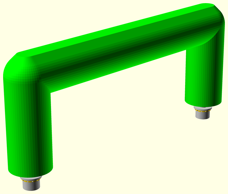

Fri, Apr 26, 2019 7:21 PM
Yes the built in sphere is missing the poles, so the base would be lifted a
bit. I would never notice because I never use a full sphere at the base
because it starts too horizontal. I use inverted rotate_extruded teardrops
when I need a rounded base, so that starts at 45 degrees. And I never use
such low values of $fn. For example this handle, which is printed flat side
down.
[image: handle.png]
Not perfectly rounded but comfortable enough to hold and easy to print. It
previews in less than a second and renders in 3 seconds. I had to avoid
implicit union inside the hull to get that speed.
