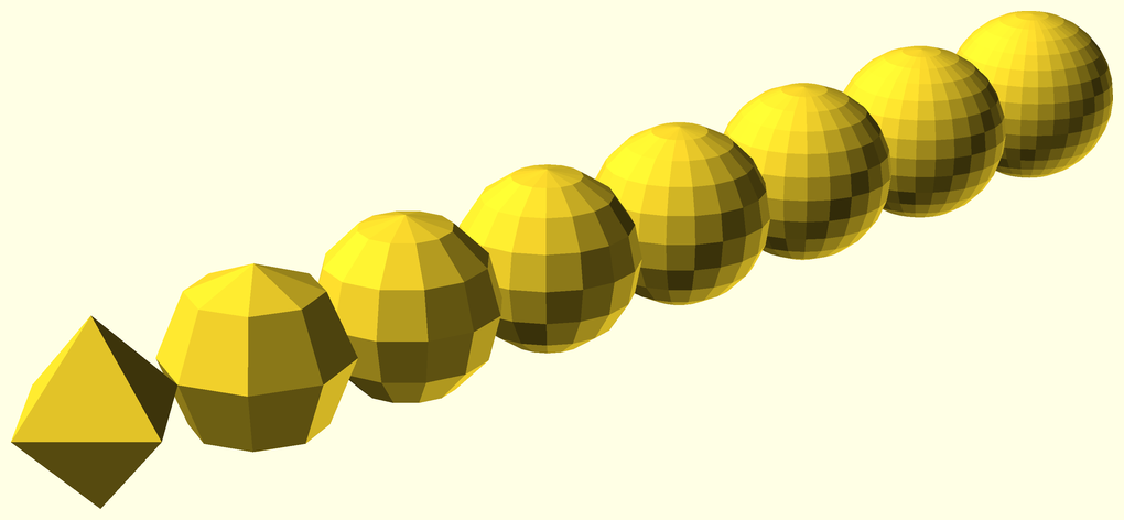

Spheres can be made exact by rotate extruding a semi circle with $fn a
multiple of 4. I redefine sphere myself to be that.
// Replicate OpenSCAD logic to calculate number of sides from radius
function r2sides(r) = $fn ? $fn : ceil(max(min(360/ $fa, r * 2 * PI / $fs),
5));
// Round up number of sides to multiple of 4 to ensure points on all axes
function r2sides4n(r) = floor((r2sides(r) + 3) / 4) * 4;
// Circle with multiple of 4 vertices
module Circle(r, d = undef) {
R = is_undef(d) ? r : d / 2;
circle(R, $fn = r2sides4n(R));
// Semi circle
module semi_circle(r)
Circle(r);
    sq = r + 1;
    translate([-sq, 0])
        square([2 * sq, sq]);
// Sphere that has vertices on all three axes. Has the advantage of giving
correct dimensions when hulled
module sphere(r = 1, d = undef) {
rotate_extrude($fn = r2sides4n(R))
rotate(-90)
semi_circle(R);
[image: spheres.png]
That's a nice idea.
Note, however, that it only makes hulls exact for faces parallel to the
coordinate planes.  In my example problem of the pyramid it's going to be
very difficult to figure out the effective radius of the "sphere" in the
direction of each face so that you can position them exactly right to get a
hull that actually has the exact dimensions desired.
