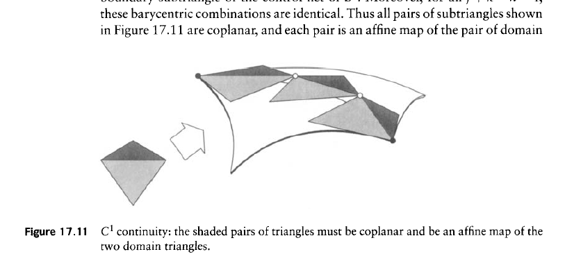

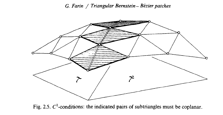

The C1 continuity (first derivative) between two adjacent triangular
patches involves the co-planarity of some triangle pairs adjacent to the
common border (see fig. 1). It is in some sense an extension of the

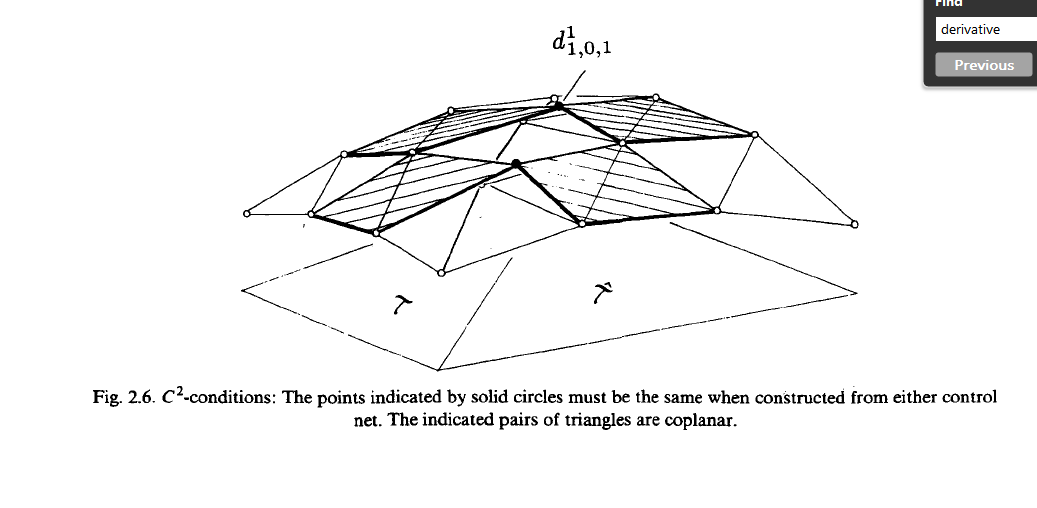

condition that holds for curves. The C2 continuity (second order) requires
the coindicence of some points extending from some triangles in a second
row away from the common border (see fig. 2). The figures were taken from
Farin's paper found at
http://citeseerx.ist.psu.edu/viewdoc/download?doi=10.1.1.413.7346&rep=rep1&type=pdf.
Although this is the main reference on the subject, its nomenclature is
hard to follow. I have tried without success, to express by triangular
patches the cylindrical surface of an edge rounded with the degree 4 curve.
That would help me to try meeting the necessary C2 continuity.

I have not been successful thus far at deciphering the C2 condition from the
paper.

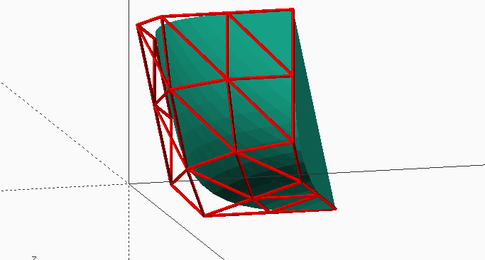

The cylindrical shape of a rounded edge (a sweep of the degree 4 border
curve) may be modeled by:
function cylindricalPatchCP(p0, p1, p2, d, r0) =
let(  cv = curveG2CP([p0,p1,p2],r0),
bs = BzSubdiv(cv,1/2) )
[ [bs[4]+d],
[ bs[3]+3d/4, bs[5]+3d/4 ],
[ bs[2]+d/2, 2*(bs[4]+d/2)-(bs[2]+bs[6]+d)/2 , bs[6]+d/2 ],
[ bs[1]+d/4, (cv[1]+cv[2])/2+d/4, (cv[2]+cv[3])/2+d/4, bs[7]+d/4 ],
cv
// our well known degree 4 curve
function curveG2CP(p,r0=0.5) =
[ p[0], p[0]+r0*(p[1]-p[0]), p[1], p[2]+r0*(p[1]-p[2]), p[2] ];
// Bezier subdivision of CP p
function BzSubdiv(p,u) =
len(p) == 2 ? [p[0], (1-u)p[0]+up[1], p[1]] :
[ p[0],
each BzSubdiv([for(i=[0:len(p)-2]) (1-u)p[i]+up[i+1]],u),
p[len(p)-1] ];
That patch makes a clear C1 joint with its mirror image along axis x. This
two patches satisfy the planarity condition at the common border even with
a degree elevation.

[image: graphs.PNG]
where the grids in blue represent the specific arranges the down projection
of the graph CP should have and the grids in red show the graph of each
coordinate of adrian surface. Besides, I mirror the graphs in order to
check the C1 conditions. It is clear from the image that just the
coordinate z has a C1 joint with it mirror image. Both coordinates X and Y
fails to have C1 continuity at those joints.
Based on that considerations we could try to build a patch that meets the
C1 condition (and perhaps the C2 condition) at the joints. However, what we
really need is G1 and G2 continuity, that is a geometric differentiabilty
and not a parametric one. Hard stuff!

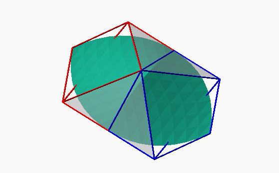

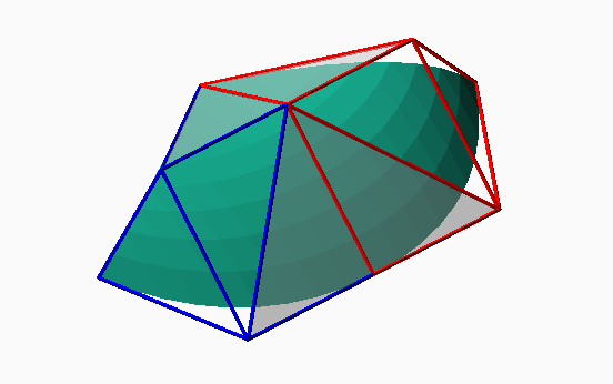

Well, I have a good news and a definitely bad one. I have found in Farin's
book ("Curves and Surfaces for CAGD") the full condition for a C1 joint
between to tripatches. Besides the co-planarity condition it is required
that any pair of CP grid triangle adjacent to the meeting border of the two
patches is an affine image of the other pairs. This affine transform should
not include any reflection, just translations, rotations and positive
scales. The following image shows the C1 joint of a degree 2 patch with its
mirror image:
[image: C1joint.PNG]
The grid in red is a mirror image of the grid in blue. The transparent
pairs of triangles satisfy the conditions of being co-planar and each one
is an affine transform of the other pair without any reflection. The joint
is C1. For patches of degree n the number of pairs to be considered will be
n.  Note that the condition excludes reflections as a possible affine
transform and the following image shows what happens when the affine
transform between pairs does not meet that requirement:
[image: NonC1joint.PNG]
In this example the adjacent pairs of triangles although co-planar does not
meet the affine condition restriction. The joint is clearly not C1.

Can you elaborate a bit on the condition?  In the first example, it appears
the two top triangles are not coplanar.  Is that just a rendering issue?
The condition for a C1 joint between two tripatches I have found in Farin's
book was just that small reference:
[image: C1Farin.PNG]
It is clear that if the pair is an affine map of the domain then each pair
is an affine map the other pairs. Although the text does not say it, I have
found in my experiments that the affine map in that condition cannot
include any reflection but just translations, rotations and positive
scales. The second example of my previous message corroborates that. I have
not checked whether shears are allowed.
In my examples, the pairs of triangles meeting at the border are all
coplanars. The view angle I used to generate the images might not have
being the best. You may experiment and check my conclusions playing with
the code I have used to produce the images:

Yes, they can but mapping the triangle of a patch in the triangle of the
other patch. In the code above, I changed one of the patches in order to
make this clearer. The two patches now are not the mirror image of each
other.
