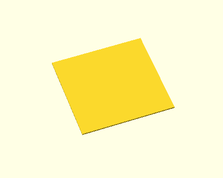

Using the following lines of OpenSCAD I have been able to draw a square
which perfectly corresponds to the intersection:

On 21.07.19 02:20, Alex Gibson wrote:
2)      A way to get OpenSCAD to output the corner co-ordinates?
Export as SVG, that gives:
M 428.88,-301.882 L 382.211,-348.552 L 335.542,-301.883 L 382.212,-255.214 z
Note that the Y coordinates are negated due to SVG coordinate
system having the origin top left.

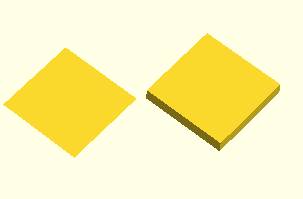

Fantastic, thanks Torsten, I was just thinking on similar lines...
I remembered an online STL to OpenSCAD converter.
So I did a Linear_extrude of my intersection and got:
Then used this dead useful tool https://jsfiddle.net/Riham/yzvGD/ to get:

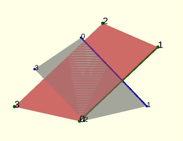

.which are exactly the same co-ordinates you got with rounding error of
0.001mm so that's verified nicely via 2 methods!

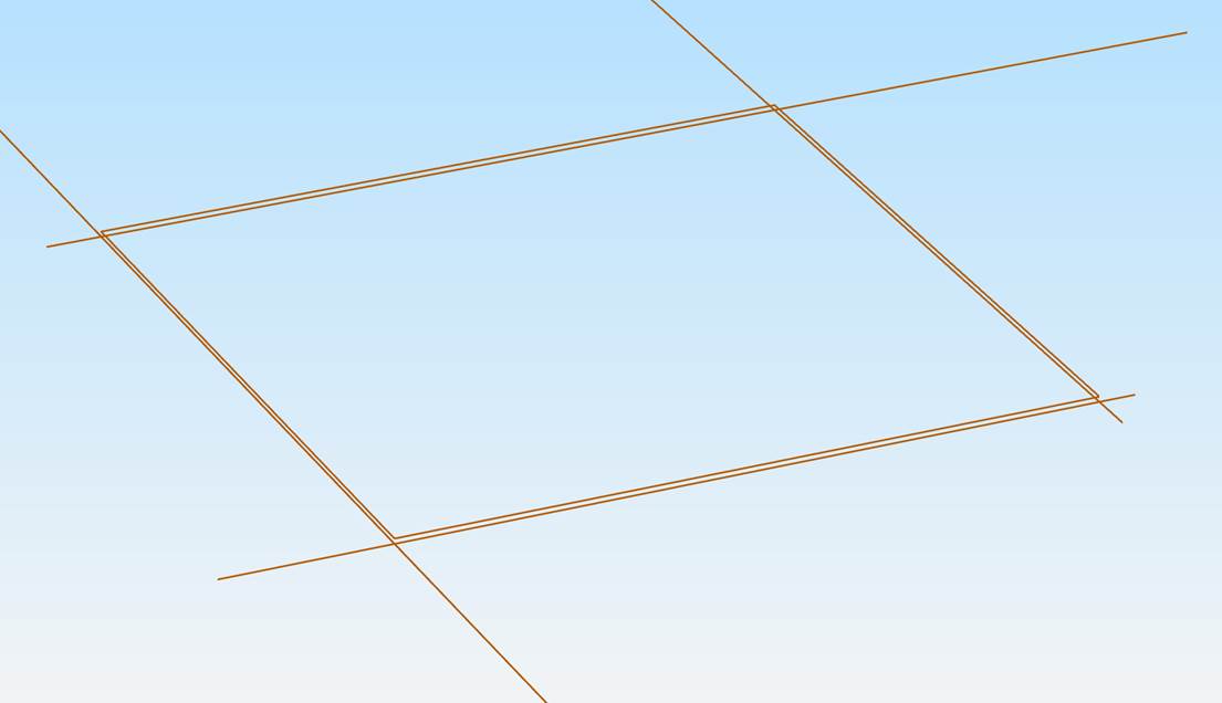

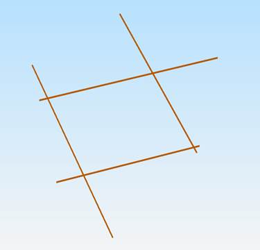

Yep - playing the GCODE back in Simplify3D gets a perfect square:
That is:
G92 E0
G1 X378.546 Y352.217
G1 X458.698 Y272.065 E76.6848 ;
G1 X457.434 Y271.615
G1 X384.642 Y252.783
G1 X324.204 Y313.221 E144.1098 ;
G1 X323.103 Y312.381
G1 X379.141 Y252.143
G1 X470.219 Y343.221 E58.8828 ;
G1 X469.321 Y343.146
G1 X403.880 Y370.221
G1 X301.294 Y267.635 E129.3704 ;
; layer 717, Z = 359.250
G1 Z359.250
G1 X382.211 Y348.552
G1 X428.88 Y301.883 E76.6848 ;
G1 X382.211 Y255.214 E144.1098 ;
G1 X335.542 Y301.883 E58.8828 ;
G1 X382.211 Y348.552 E129.3704 ;

But I'm still interested in solving with maths,
Plus https://rosettacode.org/wiki/Find_the_intersection_of_two_lines should be hints enough?
p1=[[378.546,352.217],[458.698,272.065],[384.642,252.783],[324.204,313.221]];
p2=[[379.141,252.143],[470.219,343.221],[403.88,370.221],[301.294,267.635]];
intersection()
%polygon(p1);
#polygon(p2);
plot(p1,size=1.5);
plot(p2,size=2,c="green");
line(p1[0], p1[1]);
line(p2[0], p2[1], c="green");
module line(a,b,thick=1,c="blue") {
color(c)
hull() {
  translate(a) circle(thick);
  translate(b) circle(thick);
module plot(v,size=1,c="blue") { // v=[ [x,y,z] or [x,y], ... ]
d3=(len(v[0])==3);
for(j=[0:len(v)-1]) {
i=v[j];
translate([i.x,i.y,d3 ? i.z : 0]) { //echo(i,j);
  color(c)
    if (d3)
      sphere(size,$fn=12);
    else
      circle(size,$fn=8);
  %color("black")
    translate([0,-1,0.1])
      if (d3)
        linear_extrude(height=1)
          text(str(j),size=size*4);
      else
That is:
G92 E0
G1 Z359.250
module object1(scale) {polyhedron(
points=[[382.211,348.552,0],[428.88,301.883,0],[382.211,255.214,0],[382.211,348.552,0],[382.211,255
.214,0],[335.542,301.883,0],[382.211,255.214,10],[428.88,301.883,10],[382.211,348.552,10],[335.542,
301.883,10],[382.211,255.214,10],[382.211,348.552,10],[382.211,348.552,0],[428.88,301.883,10],[428.
88,301.883,0],[382.211,348.552,0],[382.211,348.552,10],[428.88,301.883,10],[335.542,301.883,0],[382
.211,348.552,10],[382.211,348.552,0],[335.542,301.883,0],[335.542,301.883,10],[382.211,348.552,10],
[382.211,255.214,0],[335.542,301.883,10],[335.542,301.883,0],[382.211,255.214,0],[382.211,255.214,1
0],[335.542,301.883,10],[428.88,301.883,0],[382.211,255.214,10],[382.211,255.214,0],[428.88,301.883
,0],[428.88,301.883,10],[382.211,255.214,10] ],
faces=[[0,1,2],[3,4,5],[6,7,8],[9,10,11],[12,13,14],[15,16,17],[18,19,20],[21,22,23],[24,25,26],[27
,28,29],[30,31,32],[33,34,35]]);}
translate([200,0,0])
object1(1);
Which if I strip it down a bit gets:
module object4(scale) {polyhedron(
[428.88,301.883,0],
[335.542,301.883,0]],
faces=[[0,1,2,3]]);}
object4(1);
.which are exactly the same co-ordinates you got with rounding error of 0.001mm so that's verified
Thanks very much!!!
