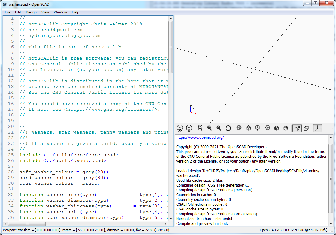

Sun, Jun 13, 2021 11:36 PM
Your original message went in my spam folder and the image is too small to
read. You shouldn't get an error opening vitamins/washer.scad, it should
simply do nothing. This is what it looks like on my machine.
washer.scad is in NopSCADlib/vitamins/washer.scad so ../utils/sweep.scad
should get you NopSCADlib/utils/sweep.scad.

Thanks. I had tried that ... but forgot to change the separators '' to
So the following now works:
//include <../utils/core/core.scad>
//include <../utils/sweep.scad>
// My latest attempt now works
include</NopSCADlib/utils/sweep.scad>
include</NopSCADlib/utils/core/core.scad>
However ... I don't see why the first one doesn't fail! Its path looks
wrong: core.scad is not in \utils, it's in \core:
C:\Users\terry\Dropbox\3D
Printer\OpenSCAD\LIBRARIES\NopSCADlib\utils\core\core.scad
Yet if I change it to what seems the correct path
include</NopSCADlib/core/core.scad>
it fails, with that same message.

I can't diagnose your original problem because your screenshot is too low
resolution. As long as you have OPENSCADPATH=C:/Users/terry/Dropbox/3D
Printer/OpenSCAD/LIBRARIES it should work without any changes. I also don't
understand how it can work with paths starting with /.
What version of OpenSCAD are you using?

Well, I tried it again with the same result:
// Those two give errors. My changes below do not, with or without the first
//include<NopSCADlib/utils/sweep.scad>
//include<NopSCADlib/utils/core/core.scad>
I've uploaded the file here:
https://www.dropbox.com/s/bzt7vh61l13t7nt/washer_Errors.scad?raw=1
