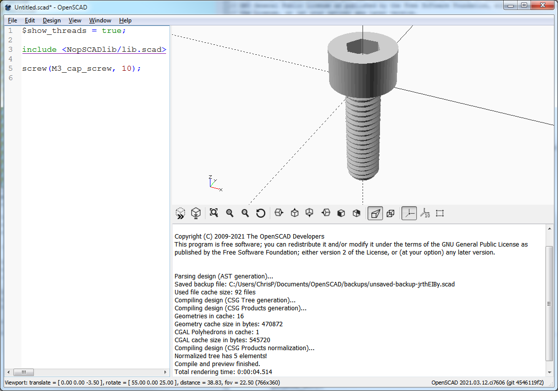

This works fine:
washer(M3_washer); // Draws a washer.
But what is the equivalent for an M3 bolt (or screw) please, my practical
objective?
screw(M3_hex_screw);
or screw(M3_cap_screw);
When you look at the documentation for screws it has a picture of all the
screws available and below is a list of all the module calls to draw them.
https://github.com/nophead/NopSCADlib#Screws

Actually those screw calls should include a length, as per the
documentation.

I thought you opened  C:\Users\terry\Dropbox\3D
Printer\OpenSCAD\LIBRARIES\NopSCADlib\vitamins\screw.scad in the GUI,
therefore the first place it should look for files is starting from
NopSCADlib/vitamins, so relative paths should work from there and they do
on my Win7 machines and on Ubuntu and for all the other users of the
library. Nobody else has said they need to start modifying the library file
paths.
I don't use C:\Program Files\OpenSCAD\ to hold my library files and it
works for me. Any file should be able to include another relative to
itself, no matter where it is placed. The "or in the library folder of the
OpenSCAD installation
" means if it doesn't find it in the first place it
will look in the library folder.

I tried your screw code. No errors but no thread:
Still unsure whether you prefer links or embedded images?
http://forum.openscad.org/file/t3184/M3-Screw-1-NoThread-SCAD.jpg

Threads are not shown in the GUI by for speed. They are shown when it makes
the assembly drawings.
You can turn them on using $show_threads = true but that probably only
works in OpenSCAD versions up to May 1st.
It then takes 4.5 seconds to draw the screw.

Thanks, that works fine here in OpenSCAD version 2021.01. I now have a proper
bolt!
