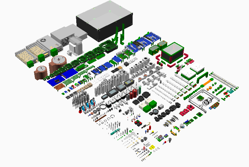

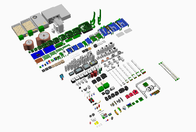

Thu, Jan 14, 2021 12:38 PM
When I preview all of my library it still draws at a good framerate but a
lot of it is missing.
It should look like this:
I don't see any pattern in what is missing and the normalised tree size is
the same 8823 elements. There are a lot more cached CGAL polyhedra. I think
this version is based on an old master and may have some bugs that have
been fixed.
Or is there a limit to the number of elements it can draw with vbos?

Thu, Jan 14, 2021 12:45 PM
Turning off the vbo features gets the missing objects back but turning them
on again still draws everything, so not sure what is going on.
