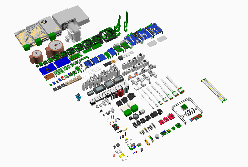

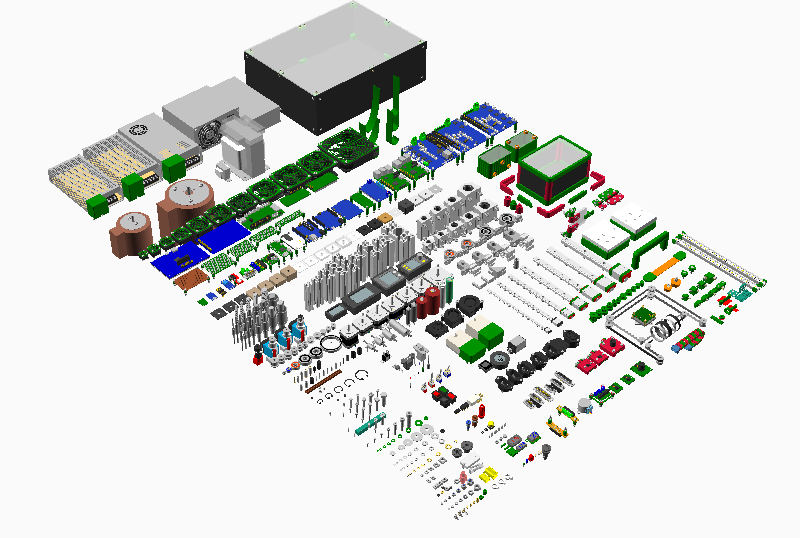

When I preview all of my library it still draws at a good framerate but a
lot of it is missing.
It should look like this:
I don't see any pattern in what is missing and the normalised tree size
is the same 8823 elements. There are a lot more cached CGAL polyhedra. I
think this version is based on an old master and may have some bugs that
have been fixed.
Or is there a limit to the number of elements it can draw with vbos?
