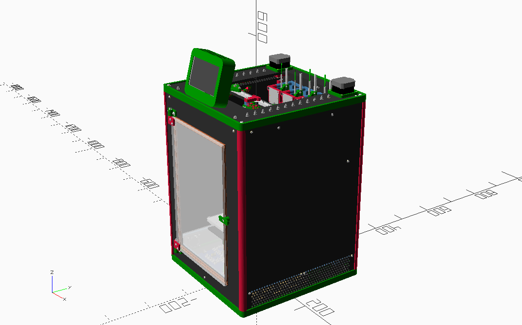

I am also having a love hate relationship with my new M1.
The primary purpose of buying a new computer was to reduce the long CGAL
rendering (F6) times of some of my larger models (WW2 Spitfire Cockpit
Instruments) on my 2012 I7 Macbook.  Some can take 40+ minutes.
A lot of this could possibly be down to the way that I use OpenScad and not
understanding any of the tuning options.
The M1 will F6 render faster than the i7 at around 175% so good news there.
However the big problem that I have is that trying to change the viewpoint
in preview mode on my more complex models has dropped from around 4 or 5fps
to around 2 seconds per frame making it totally unusable.
Any thoughts or suggestions ?

Try wrapping it in render(). It will take time to make the first frame but
be fast to draw after that.
If you post the code I could probably make it faster as it doesn't look
like it should take 2s per frame. I get that sort of frame rate on my
laptop with this model but it has about 2000 parts.

In addition to the other suggestions, you can register
this new feature:
https://github.com/openscad/openscad/pull/1935
Once it's merged, which may happen in the next couple of
days, try out the snapshot version (and enable the new
display features in Preferences).
http://forum.openscad.org/file/t3083/Screenshot_2021-01-09_at_10.png
