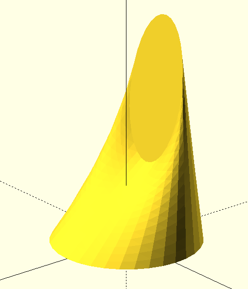

also i think if the 2 sections are not in parallel plane, minimum length
system may not work.
e.g. this is produced with area minimizing option
[image: Screenshot 2023-01-22 at 9.37.51 PM.png]

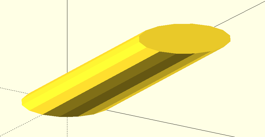

You may want to experiment with the displacement issue.  The simplest
test is to use two “circles” and a range of displacements.  Perfect
alignment yields a perfect cylinder.  Displacement causes a crease to
appear.  The limiting case is two cones sharing a single edge.

If you don’t get 2 cones with circles displaced by a diameter, then you
are not minimizing area.

I remain baffled about the idea that displacement causes problems.  I
used 2 circles and every displacement produces a reasonable result.  No
clue what you mean about 2 cones sharing an edge.  Are you saying all the
points from one circle map to a single point on the other circle?  That's
impossible in my code because it isn't an onto mapping from the source
shape to the target shape.  (Note: source shape is the one with more
vertices, or either one in case of identical vertex count.)  In fact, the
only way the mapping can "fail" when you have the same number of points on
each shape is by introducing a twist, which will have a larger distance, so
it won't be the optimal solution.  The only candidate mappings are twists
of each other in this situation.  It sounds like you're maybe talking
about a very simple method that locally picks the closest point on the
other shape, not a global optimization that minimizes the distance summed
over all pairs of matched points, with the constraint that every point is
in a pair.

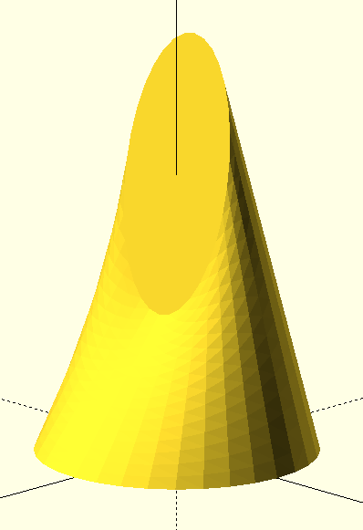

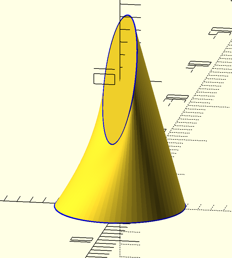

Sanjeev, I don't understand why using minimum length should be any less
robust than minimum area.  I think the difference in results of the two
methods, at least in the context of my implementation, would be very
small.  And it would be especially small in the case like the one you
show, where the triangles are long and thin, because in that case, length
(distance) is a good approximation for area.

If you go for the nearest point with the top circle sharply inclined it the
lower points could be nearer the back of the base than the correct point
which is more distant at the back of the top.
in a pair.

nophead, he didn't mean two cones meeting at a point.  He meant two
(skewed) cones intersecting at an edge, with one cone apex on the top
circle and one cone apex on the bottom circle.
My method is global.  It is not going for a single nearest point, but
minimizing the distance of all the points jointly.  So the fact that there
is an obvious way to get a single point in bad correspondence doesn't show
that the full solution will actually come out that way.    If you use the
arc-length approach you have to pick a starting point, and there you could
run into trouble if you don't use a global approach of some sort to do it.
Here's the case you describe, where the bottom of the ellipse is closer to
the back of the circle, and the solution is by distance minimization.  That
doesn't lead it to map to the back of the circle.

I think this minimum distance approach should be equally good.
