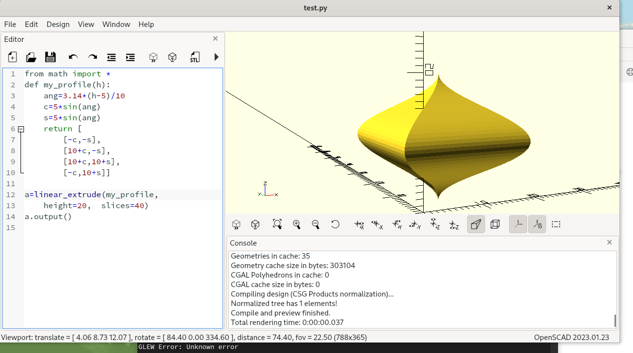

Right now i am developing linear_extrude with an ARBRITARY profile (with
help of python)
possible application might look like this:
hoping that this can become baseline sometime in the future.
working locally already here :)

If I have to import my python library openscsd1.py and use, how will that
work.
Also would not like to overwrite the native openscad modules.

It sounds like you are writing a function that duplicates the skin()
function found originally in list-comprehension-demos and expanded in
BOSL2, though if you truly mean arbitrary shapes it will be interesting.
So you can connect 4 rings to a single hexagon, say?
For your example, it can be done without python:
include<BOSL2-fork/std.scad>
function prof(h) =
let(
ang = 180*(h-5)/10,
c=5sin(ang),
s=5
sin(ang)
[[-c,-s,h],[10+c,-s,h],[10+c,10+s,h],[-c,10+s,h]];
profiles = [for(i=[0:1/2:20]) prof(i)];
skin(profiles,slices=0);

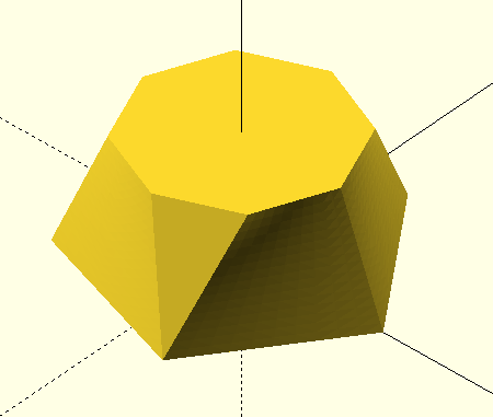

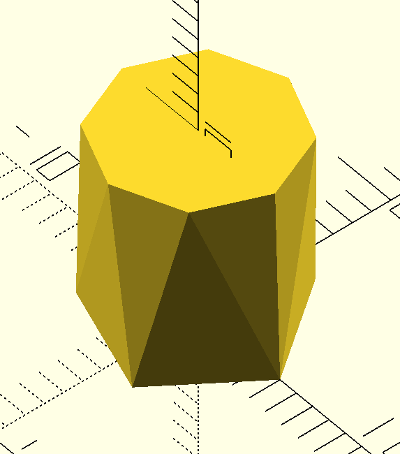

For producing a polyhedron, the number of points in different levels needs
to be same is what I assume. If there is any other way, I am not sure.
In the example shared, points were made same with ray intersection method.
From the center of the sections, lines were drawn in circular orientation
to find intersections.
Since these are 360 lines, the points in each section were 360. But in this
case vertex to vertex mapping is not possible.
The other method I use is nearest point mapping method depending on the
shape of the 2 sections and most of the time this works if the sections are
convex.
Now with the new minimum distance orientation solution, this new method of
[sec1]×len(sec2) and [sec2]×len(sec1) can be used. This cannot be directly

My approach is to duplicate points, so if you want to match a pentagon to a hexagon, you duplicate one of the pentagon's points so that you have a pentagon with 6 points. Then the points can be aligned. Then you resample the edges of the points, and linearly interpolate to generate the desired number of slices. This generates a polyhedron with some degenerate faces, which can then be discarded automatically. So when I'm doing a distance optimization, that optimization is done on the 5 points of the pentagon and 6 points of the hexagon, not on the resampled curves. This ensures that the corners align with each other, which (I think) produces the best outcome. I don't think I understand what you mean about [sec1]×len(sec2) and [sec2]×len(sec1). If I don't want to use the minimum distance method, but instead want to use the arc length based approach, then I resample (or originally generate) the curves so that they have the same number of points, uniformly spaced in length along the curve. Then it's a question of deciding where to start. I do this by considering every possible starting position (rotations of the point lists of one of the curves) and computing the total distance between all pairs. Choosing the one with minimum total distance gives a good starting position. My other approach, which I think resembles your rays approach is as follows: given one curve and a point to map, find a tangent plane at that point on the curve such that the tangent plane also intersects the other curve in a single point. That defines the mapping. I never understood how your rays method works when the curves are in 3 space, not parallel to each other. On Mon, Jan 23, 2023 at 5:50 PM Sanjeev Prabhakar <sprabhakar2006@gmail.com> wrote: > For producing a polyhedron, the number of points in different levels needs > to be same is what I assume. If there is any other way, I am not sure. > > In the example shared, points were made same with ray intersection method. > > From the center of the sections, lines were drawn in circular orientation > to find intersections. > Since these are 360 lines, the points in each section were 360. But in > this case vertex to vertex mapping is not possible. > > The other method I use is nearest point mapping method depending on the > shape of the 2 sections and most of the time this works if the sections are > convex. > > Now with the new minimum distance orientation solution, this new method of > [sec1]×len(sec2) and [sec2]×len(sec1) can be used. This cannot be directly > used though, all the similar points needs to be grouped together to work. > > > On Tue, 24 Jan, 2023, 2:49 am Adrian Mariano, <avm4@cornell.edu> wrote: > >> Sanjeev, I make no assumption that the number of points in both sections >> are the same. It didn't look like you were making this assumption: in >> your example with the star the number of points is different. >> >> But I assume that there is only one contour at each layer, so you cannot >> have a ring, because that has two contours. You would have to handle that >> by modeling the hole separately from the outside of the object. >> >> >> _______________________________________________ > OpenSCAD mailing list > To unsubscribe send an email to discuss-leave@lists.openscad.org >
Mon, Jan 23, 2023 11:59 PM
following is the code in python which matches a pentagon with an octagon
with minimum distance method without any slices:
sec1=circle(5,s=6)
sec2=circle(7,s=9)
sec3=c2t3(concatenate(array([sec1]*len(sec2)).transpose(1,0,2)))
sec4=translate([0,0,10],concatenate(array([sec2]*len(sec1)).transpose(1,0,2)))
sol=align_sec(sec3,sec4)
with open('/Users/sanjeevprabhakar/iCloud Drive
(Archive)/Documents/Download/openscad/trial.scad','w+') as f:
f.write(f'''
{swp(sol)}
function c2t3 converts a 2d to 3d by adding 0 in place of 'z' axis.
function translate is used to translate a 2d section up by 10 units in this
case and hence making it 3d
function align_sec is for aligning the points
you can notice the grouping of points with python numpy functions
following result is produced:
[image: Screenshot 2023-01-24 at 5.28.03 AM.png]
Align function is written yesterday and is not checked for any possible
bugs yet, but it works as of now in various similar cases
other.
following is the code in python which matches a pentagon with an octagon with minimum distance method without any slices: sec1=circle(5,s=6) sec2=circle(7,s=9) sec3=c2t3(concatenate(array([sec1]*len(sec2)).transpose(1,0,2))) sec4=translate([0,0,10],concatenate(array([sec2]*len(sec1)).transpose(1,0,2))) sol=align_sec(sec3,sec4) with open('/Users/sanjeevprabhakar/iCloud Drive (Archive)/Documents/Download/openscad/trial.scad','w+') as f: f.write(f''' {swp(sol)} ''') function c2t3 converts a 2d to 3d by adding 0 in place of 'z' axis. function translate is used to translate a 2d section up by 10 units in this case and hence making it 3d function align_sec is for aligning the points you can notice the grouping of points with python numpy functions following result is produced: [image: Screenshot 2023-01-24 at 5.28.03 AM.png] Align function is written yesterday and is not checked for any possible bugs yet, but it works as of now in various similar cases On Tue, 24 Jan 2023 at 04:48, Adrian Mariano <avm4@cornell.edu> wrote: > My approach is to duplicate points, so if you want to match a pentagon to > a hexagon, you duplicate one of the pentagon's points so that you have a > pentagon with 6 points. Then the points can be aligned. Then you resample > the edges of the points, and linearly interpolate to generate the desired > number of slices. This generates a polyhedron with some degenerate faces, > which can then be discarded automatically. > > So when I'm doing a distance optimization, that optimization is done on > the 5 points of the pentagon and 6 points of the hexagon, not on the > resampled curves. This ensures that the corners align with each other, > which (I think) produces the best outcome. > > I don't think I understand what you mean about [sec1]×len(sec2) and > [sec2]×len(sec1). If I don't want to use the minimum distance method, but > instead want to use the arc length based approach, then I resample (or > originally generate) the curves so that they have the same number of > points, uniformly spaced in length along the curve. Then it's a question > of deciding where to start. I do this by considering every possible > starting position (rotations of the point lists of one of the curves) and > computing the total distance between all pairs. Choosing the one with > minimum total distance gives a good starting position. > > My other approach, which I think resembles your rays approach is as > follows: given one curve and a point to map, find a tangent plane at that > point on the curve such that the tangent plane also intersects the other > curve in a single point. That defines the mapping. I never understood how > your rays method works when the curves are in 3 space, not parallel to each > other. > > > >
Tue, Jan 24, 2023 12:13 AM
This is my result for pentagon to octagon.  It has two obviously curved
faces.  (All faces are somewhat curved.)
On Mon, Jan 23, 2023 at 7:00 PM Sanjeev Prabhakar sprabhakar2006@gmail.com
sec1=circle(5,s=6)
sec2=circle(7,s=9)
f.write(f'''
{swp(sol)}
