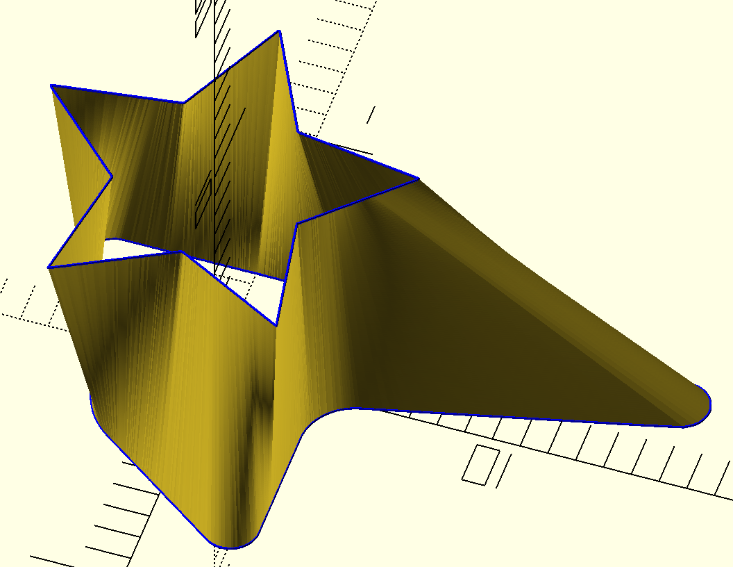

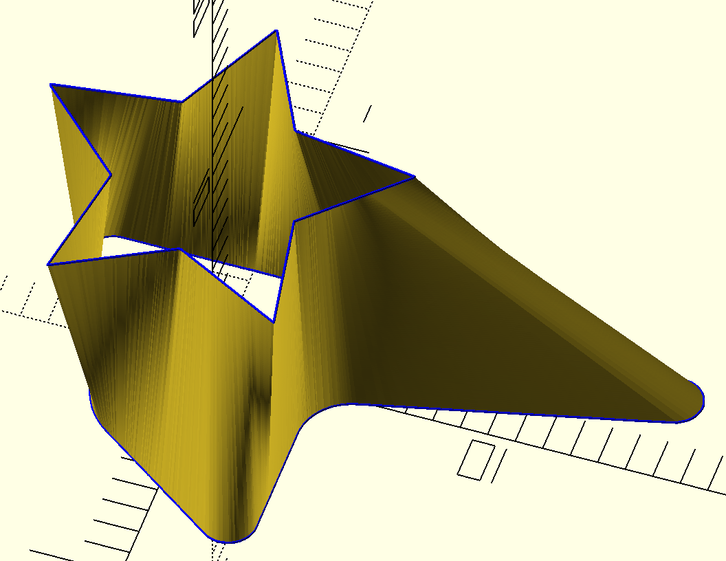

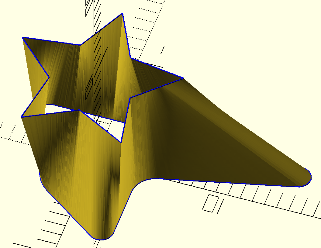

On Jan 21, 2023, at 21:09, Sanjeev Prabhakar sprabhakar2006@gmail.com
for nearest points mapping center of the 2 sections should almost match in
case of convex shapes
arc lengths i think is a very complicated idea.
here is an example of 2 concave shapes joined with points with approach 2
mentioned in my previous post.
<Screenshot 2023-01-22 at 8.24.24 AM.png>
this is made by intersection of 720 rays and around 100 slices
execution time is 1.5 sec in python, i dont know how long will it take in
pure openscad code.
On Sun, 22 Jan 2023 at 07:47, Adrian Mariano avm4@cornell.edu wrote:
I think you need to think carefully and define what you mean by "nearest
point mapping".  It will NOT always work for convex shapes if by nearest
point you mean take one shape (one with more points) and map every point to
the nearest point.  Trivial example:  square in right half plane map to a
shape in the left half plane:  all the points of the right hand shape map
to the single right-most point of the left hand shape.  You don't get a
valid mapping.
To make this concept rigorous you need to assure that you use all the
points of both shapes.  I did this in my skin() method by looking for the
mapping that maps all points from the larger shape onto the points of the
smaller shape while assuring that every point in the smaller shape is
covered.  But now you no longer have a simple concept like "nearest point"
to do the mapping.  Instead a complicated optimization arises.  This
optimization is solved in my skin() algorithm.  But as I am saying, it's
complicated.  When I started trying to write skin() I had no idea how
complicated it was going to end up being.  This optimization produces great
results, I think, as long as the shapes are "discrete", like polygons with
few edges.  If you want to map two curved shapes to each other, the results
are not great, and the run time also becomes uncomfortably long, since the
algorithm has O(N^3) run time.
For your second concept, given two polygons located in 3-space, perhaps
not parallel to each other, how do you define the rays?  I don't know how
to do that.  I did devise a method maybe sort of like what you are
imagining that involves tangent planes.  It produces reasonable results for
continuous shapes, though I think very often results that can also be
easily produced by other means.

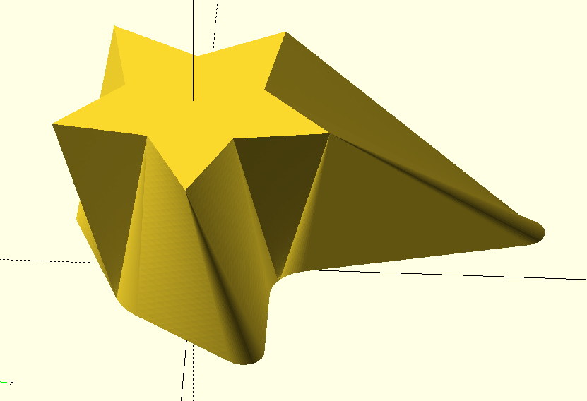

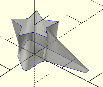

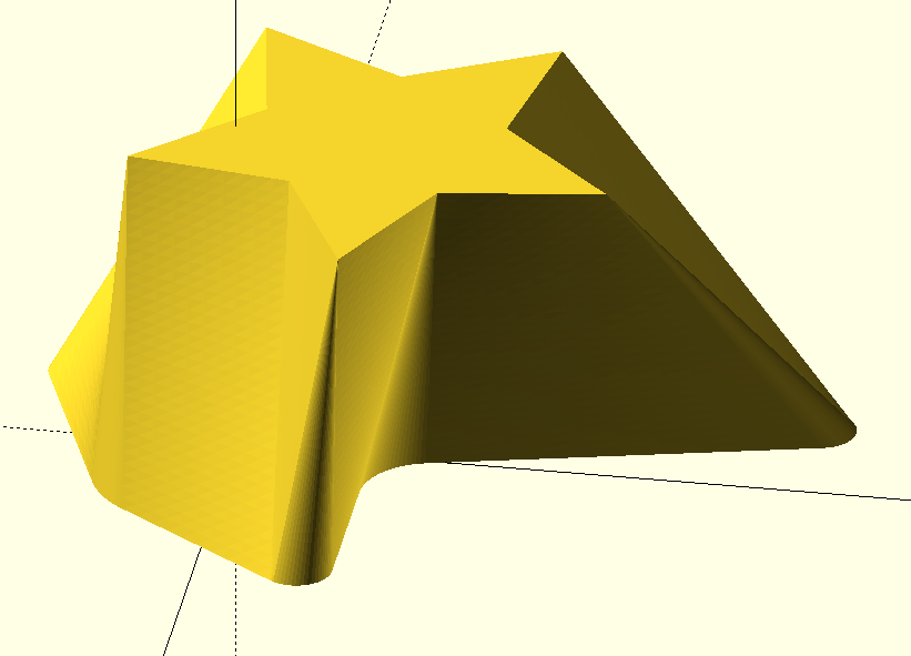

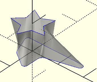

nearest point approach will be produce this result:
<Screenshot 2023-01-22 at 6.32.31 AM.png>
rays emanating from center and intersection approach will produce this
result:
<Screenshot 2023-01-22 at 6.35.04 AM.png>
in the 2nd approach 360 lines were intersected in the example.
morelines will produce much refined results and should work in most of the
cases

So anybody who didn't believe me that the problem is complicated can read the paper, which is 31 pages long. I just briefly skimmed over it to see what was in there, and it looks like the majority is focused on the problem of "correspondence" and "branching" which both have to do with the case of multiple contours mapping to single contours. I completely ignored this case, but presumably an OpenSCAD built-in would need to address it. So I only tried to address the "tiling" problem, which I thought was hard enough, especially within OpenSCAD. Fig 2 looks like a diagram I drew when devising my approach. My method is a global optimization over all the mappings of the vertices from the first contour to the second. If f maps a vertex from C1 to C2 then I minimize the sum over all v in C1 of d(v,f(v)), where d() is Euclidean distance. The method you propose is exactly what I was referring to as the arc length method, and I agree that it will generally produce a good result for mappings between continuous curves. But for shapes with corners, I think usually you want to map the corners to each other somehow---at least I think that looks better, in the absence of any guidance from details of the application. On Sat, Jan 21, 2023 at 10:29 PM Kenneth Sloan <kennethrsloan@gmail.com> wrote: > Jumping in the middle here, but... > > This is an old problem. I wrote several papers on this in the previous > century. A seminal paper is by Fuchs, Kedem & Uselton (CACM, perhaps Nov. > 1977). You can find a few small conference papers with my name on them - > and one major paper that handled all sorts of stuff you probably con't care > about. Start here: > https://scholar.google.com/citations?view_op=view_citation&hl=en&user=elhUt8QAAAAJ&citation_for_view=elhUt8QAAAAJ:u-x6o8ySG0sC > > Most of what you need is in the references found there. > > A lot depends on your assumptions, and how much attention you want to pay > to "features" in the two shapes. > > When faced with a new instance of this problem, I usually start with a > simple method: > > a) find one "obvious" match between a point on A and a point on B > b) normalize the two 2D curves to have length 1.0, with both 0.0 and 1.0 > at the > matching points found in a) > c) connect a point on A to the point on B which is closest in normalized > arc length > > This method does a better job of handling non-convex shapes than the > method you seem to be using here (also an old, well-known, method). > > As a classic example of how assumptions matter, consider two shapes which > are both perfect circles, with one small bump - but the bump is rotated by > 30 degrees in A compared with the orientation in B. > Do you want the resulting shape to have a single bump in A which > disappears as you move to B, while a different bump appears? Or, to you > want a cylinder with a smaller cylinder wrapped around it? > > In your example, suppose you have 2 5-pointed stars, but they are rotated > slightly with respect to each other. Do you want the points of the stars > to connect? or not? > > And so on... > > > > -- > Kenneth Sloan > KennethRSloan@gmail.com > Vision is the art of seeing what is invisible to others. > > > > > > On Jan 21, 2023, at 21:09, Sanjeev Prabhakar <sprabhakar2006@gmail.com> > wrote: > > for nearest points mapping center of the 2 sections should almost match in > case of convex shapes > > arc lengths i think is a very complicated idea. > > here is an example of 2 concave shapes joined with points with approach 2 > mentioned in my previous post. > > <Screenshot 2023-01-22 at 8.24.24 AM.png> > > this is made by intersection of 720 rays and around 100 slices > execution time is 1.5 sec in python, i dont know how long will it take in > pure openscad code. > > On Sun, 22 Jan 2023 at 07:47, Adrian Mariano <avm4@cornell.edu> wrote: > >> I think you need to think carefully and define what you mean by "nearest >> point mapping". It will NOT always work for convex shapes if by nearest >> point you mean take one shape (one with more points) and map every point to >> the nearest point. Trivial example: square in right half plane map to a >> shape in the left half plane: all the points of the right hand shape map >> to the single right-most point of the left hand shape. You don't get a >> valid mapping. >> >> To make this concept rigorous you need to assure that you use all the >> points of both shapes. I did this in my skin() method by looking for the >> mapping that maps all points from the larger shape onto the points of the >> smaller shape while assuring that every point in the smaller shape is >> covered. But now you no longer have a simple concept like "nearest point" >> to do the mapping. Instead a complicated optimization arises. This >> optimization is solved in my skin() algorithm. But as I am saying, it's >> complicated. When I started trying to write skin() I had no idea how >> complicated it was going to end up being. This optimization produces great >> results, I think, as long as the shapes are "discrete", like polygons with >> few edges. If you want to map two curved shapes to each other, the results >> are not great, and the run time also becomes uncomfortably long, since the >> algorithm has O(N^3) run time. >> >> For your second concept, given two polygons located in 3-space, perhaps >> not parallel to each other, how do you define the rays? I don't know how >> to do that. I did devise a method maybe sort of like what you are >> imagining that involves tangent planes. It produces reasonable results for >> continuous shapes, though I think very often results that can also be >> easily produced by other means. >> >> You are overlooking the case which I think tends to be best when a smooth >> curves is involved: connect them by arc length. This in my experience, >> often produces the best result. You have to somehow align them to decide >> on the starting point. Then you resample them by arc length to have the >> same number of points (or generate them that way) and then simply line up >> the points. This can often handle a concave shape, depending on how >> different the shapes are, and it tends to produce a nicer form than the >> tangent plane method. Depending on how you line things up you may get a >> twist---which could be a desirable outcome. >> >> On Sat, Jan 21, 2023 at 8:50 PM Sanjeev Prabhakar < >> sprabhakar2006@gmail.com> wrote: >> >>> I think >>> a. if both the sections are convex the nearest point mapping >>> approach should work >>> >>> b. if one section is convex and the other section is concave again the >>> first approach should work where concave shape should be the primary one >>> >>> c. when both the shapes are concave the 2nd approach should be used >>> >>> when the shape is so concave like an "S" shape, I have a feeling that it >>> would be extremely difficult or may be impossible to match without >>> intersecting lines. You can still do it by matching the number of points, >>> but it may not make any sense of the shape. >>> >>> >>> >>> On Sun, 22 Jan 2023 at 06:58, Adrian Mariano <avm4@cornell.edu> wrote: >>> >>>> The first approach to me looks much better, but you need to add a bunch >>>> of horizontal slices to correctly capture the curvature of the faces. As >>>> shown you have faces that are not coplanar. >>>> >>>> I personally do not like the look of the second approach, where an edge >>>> is split. Personal preference. But also, I think this model is bad >>>> because it has lots of very long skinny triangles. You can model more >>>> efficiently and the result is better, in my opinion, when the triangles are >>>> as close to equilateral as possible. Models like the above produce moire >>>> effects and can be hard to view, and if you decrease the triangle count, >>>> you get rippling across the surfaces. The rippling never goes away---just >>>> gets smaller as you shrink the triangles. A horizontal section of such a >>>> model will show zig-zag edges. >>>> >>>> But I guess the question is what point are you trying to make? Rogier >>>> suggested we should have a built-in OpenSCAD module that does things like >>>> this (maybe?). Another poster suggested joining convex shapes using convex >>>> hulls of cones as a claim that the desired feature already can be >>>> implemented partially. I have argued that a full implementation is complex >>>> because there are multiple way to align shapes and no single correct way, >>>> so you need different algorithms for alignment. I don't see any evidence >>>> to the contrary shown here. My point is not that the problem cannot be >>>> solved in many interesting and useful cases---I have done it. My point is >>>> that the problem is complicated, and it cannot be solved in all cases, so >>>> that makes a built-in seem unlikely to occur. Furthermore, a solution is >>>> necessarily complex in terms of its interface, since there are several ways >>>> we can imagine aligning points. This also makes a built-in seem unlikely. >>>> >>>> We can do lots of nice things with existing libraries and without a >>>> built in, though of course there is the limitation due to the inability to >>>> extract geometrical data from OpenSCAD objects. *THAT* may actually be >>>> fixed in a future version, so that seems like the path forward towards a >>>> generic solution to this kind of model that can work on geometry instead of >>>> path lists. >>>> >>>> >>>> On Sat, Jan 21, 2023 at 8:10 PM Sanjeev Prabhakar < >>>> sprabhakar2006@gmail.com> wrote: >>>> >>>>> nearest point approach will be produce this result: >>>>> <Screenshot 2023-01-22 at 6.32.31 AM.png> >>>>> >>>>> >>>>> rays emanating from center and intersection approach will produce this >>>>> result: >>>>> <Screenshot 2023-01-22 at 6.35.04 AM.png> >>>>> >>>>> in the 2nd approach 360 lines were intersected in the example. >>>>> morelines will produce much refined results and should work in most of the >>>>> cases >>>>> >>>>> >>>>> >>>>> >>>>> On Sun, 22 Jan 2023 at 05:41, Adrian Mariano <avm4@cornell.edu> wrote: >>>>> >>>>>> It is possible to write a generic extruder for the convex case using >>>>>> cones, but there are a couple things that limit this. For most >>>>>> interesting cases, you need many slices to produce the correct form and to >>>>>> avoid producing artifacts on the curved faces that arise. (See Jordan's >>>>>> example.) Where will these slices come from? Note that even with convex >>>>>> endcaps, the resulting shape need not be convex. You will need the point >>>>>> list of the data in order to produce the many needed slices, most likely, >>>>>> since no mechanism for "averaging" geometry exists. Given that you have a >>>>>> point list, simply computing the desired shape as a polyhedron is much more >>>>>> efficient than computing it as the union of 100 overlapping cones. The >>>>>> version I implemented (convex_offset_extrude in BOSL2) flips the cones >>>>>> around to handle the ends, extrema, whether the shape is increasing or >>>>>> decreasing. This all requires access to the actual point list. >>>>>> >>>>>> Note that the direct computation of the polyhedron also already >>>>>> exists in libraries (it's also here now). >>>>>> >>>>>> Many examples can be seen here (though the animated examples look >>>>>> really bad right now for some reason): >>>>>> >>>>>> https://github.com/revarbat/BOSL2/wiki/skin.scad#functionmodule-skin >>>>>> >>>>>> On Sat, Jan 21, 2023 at 5:27 PM nop head <nop.head@gmail.com> wrote: >>>>>> >>>>>>> The points of the cones can be very close to the base so they are >>>>>>> close to being a flat disk. As long as they are inside the hull they get >>>>>>> discarded. >>>>>>> >>>>>>> On Sat, 21 Jan 2023 at 22:11, Jordan Brown < >>>>>>> openscad@jordan.maileater.net> wrote: >>>>>>> >>>>>>>> On 1/21/2023 1:24 PM, Steve Lelievre wrote: >>>>>>>> >>>>>>>> I like the cones because they only involve the one perimeter at the >>>>>>>> wide end so the shape produced is completely 'correct' in geometrical terms. >>>>>>>> >>>>>>>> >>>>>>>> OK, thanks. >>>>>>>> >>>>>>>> Do note that it only works if the two are aligned so that the >>>>>>>> points of the cones fall inside the other end's polygon. >>>>>>>> >>>>>>>> _______________________________________________ >>>>>>>> OpenSCAD mailing list >>>>>>>> To unsubscribe send an email to discuss-leave@lists.openscad.org >>>>>>>> >>>>>>> _______________________________________________ >>>>>>> OpenSCAD mailing list >>>>>>> To unsubscribe send an email to discuss-leave@lists.openscad.org >>>>>>> >>>>>> _______________________________________________ >>>>>> OpenSCAD mailing list >>>>>> To unsubscribe send an email to discuss-leave@lists.openscad.org >>>>>> >>>>> _______________________________________________ >>>>> OpenSCAD mailing list >>>>> To unsubscribe send an email to discuss-leave@lists.openscad.org >>>>> >>>> _______________________________________________ >>>> OpenSCAD mailing list >>>> To unsubscribe send an email to discuss-leave@lists.openscad.org >>>> >>> _______________________________________________ >>> OpenSCAD mailing list >>> To unsubscribe send an email to discuss-leave@lists.openscad.org >>> >> _______________________________________________ >> OpenSCAD mailing list >> To unsubscribe send an email to discuss-leave@lists.openscad.org >> > _______________________________________________ > OpenSCAD mailing list > To unsubscribe send an email to discuss-leave@lists.openscad.org > > > _______________________________________________ > OpenSCAD mailing list > To unsubscribe send an email to discuss-leave@lists.openscad.org >
Sun, Jan 22, 2023 4:19 AM
you can give it a try with these 2 sections
sec1=[[-4.495801703898594, -4.793470460340294],
[-4.491151273898594, -4.8897992103402945],
[-4.477243243898593, -4.985232020340295],
[-4.454206973898594, -5.078881280340294],
[-4.4222567138985935, -5.1698759803402945],
[-4.381689633898594, -5.257369780340294],

[image: Screenshot 2023-01-22 at 9.37.59 AM.png]
in case of convex shapes
pure openscad code.
valid mapping.
smooth curves is involved: connect them by arc length.  This in my
experience, often produces the best result.  You have to somehow align them
to decide on the starting point.  Then you resample them by arc length to
have the same number of points (or generate them that way) and then simply
line up the points.  This can often handle a concave shape, depending on
how different the shapes are, and it tends to produce a nicer form than the
this result:
cases

As I have said, I think getting a good result, if it is possible, probably
requires manual alignment of the shapes.  My best looking automatic output
is this:
and it is also not very good.  Part of the problem is that the star has 10
vertices but the lower shape is a polygon with 5 vertices that have been
rounded.  What needs to happen is the ten vertices of the star mapped to
the 5 vertices of the underlying shape, and then the rounded version mapped
so that the roundings to to their corresponding vertex.  I imagine that
would give the best result.  I don't think an automated method is likely to
find this result, though.  This distance minimizer maps the concave bottom
rounding to an edge, which looks funny, but does OK with the point of the
star in front, which maps to a rounded corner.
I think I get a somewhat better result if I line the star up better with
the other shape.  These results take about 8s to compute in OpenSCAD:
Another method in practice to get a nicer result is to compute more slices
2 mentioned in my previous post.
in pure openscad code.
bunch of horizontal slices to correctly capture the curvature of the
faces.  As shown you have faces that are not coplanar.
edge is split.  Personal preference.  But also, I think this model is bad
this result:
cases

Sun, Jan 22, 2023 8:02 AM
based on the minimum area triangle logic, below is the best orientation.
[image: Screenshot 2023-01-22 at 1.29.27 PM.png]
it takes 10 sec
720 points in each section
100 slices
there is a lot of opportunity to optimise the code as this is a quick try

Sun, Jan 22, 2023 1:03 PM
I tried this minimum area approach and this works.
the optimised model is really quite good.
file can be downloaded here:
https://github.com/sprabhakar2006/openSCAD/blob/main/merging%202%20shapes.scad
