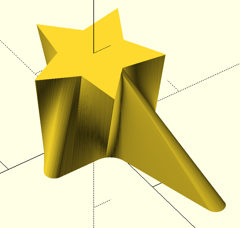

On 1/21/2023 1:24 PM, Steve Lelievre wrote:
I like the cones because they only involve the one perimeter at the
wide end so the shape produced is completely 'correct' in geometrical
terms.
OK, thanks.
Do note that it only works if the two are aligned so that the points of
the cones fall inside the other end's polygon.

Sun, Jan 22, 2023 12:10 AM
It is possible to write a generic extruder for the convex case using cones,
but there are a couple things that limit this.  For most interesting
cases, you need many slices to produce the correct form and to avoid
producing artifacts on the curved faces that arise.  (See Jordan's
example.)  Where will these slices come from?  Note that even with convex
endcaps, the resulting shape need not be convex.  You will need the point
list of the data in order to produce the many needed slices, most likely,
since no mechanism for "averaging" geometry exists.  Given that you have a
point list, simply computing the desired shape as a polyhedron is much more
efficient than computing it as the union of 100 overlapping cones.  The
version I implemented (convex_offset_extrude in BOSL2) flips the cones
around to handle the ends, extrema, whether the shape is increasing or
decreasing.  This all requires access to the actual point list.
Note that the direct computation of the polyhedron also already exists in
libraries (it's also here now).
Many examples can be seen here (though the animated examples look really
bad right now for some reason):
https://github.com/revarbat/BOSL2/wiki/skin.scad#functionmodule-skin

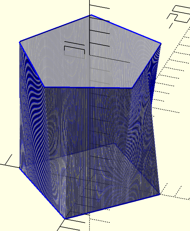

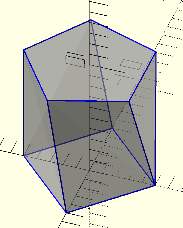

Sun, Jan 22, 2023 1:09 AM
nearest point approach will be produce this result:
[image: Screenshot 2023-01-22 at 6.32.31 AM.png]
rays emanating from center and intersection approach will produce this
result:
[image: Screenshot 2023-01-22 at 6.35.04 AM.png]
in the 2nd approach 360 lines were intersected in the example. morelines
will produce much refined results and should work in most of the cases

Sun, Jan 22, 2023 1:27 AM
The first approach to me looks much better, but you need to add a bunch of
horizontal slices to correctly capture the curvature of the faces.  As
shown you have faces that are not coplanar.
I personally do not like the look of the second approach, where an edge is
split.  Personal preference.  But also, I think this model is bad because
it has lots of very long skinny triangles.  You can model more efficiently
and the result is better, in my opinion, when the triangles are as close to
equilateral as possible.  Models like the above produce moire effects and
can be hard to view, and if you decrease the triangle count, you get
rippling across the surfaces.  The rippling never goes away---just gets
smaller as you shrink the triangles.  A horizontal section of such a model
will show zig-zag edges.
result:

for nearest points mapping center of the 2 sections should almost match in
case of convex shapes
arc lengths i think is a very complicated idea.
here is an example of 2 concave shapes joined with points with approach 2
mentioned in my previous post.
[image: Screenshot 2023-01-22 at 8.24.24 AM.png]
this is made by intersection of 720 rays and around 100 slices
execution time is 1.5 sec in python, i dont know how long will it take in
pure openscad code.

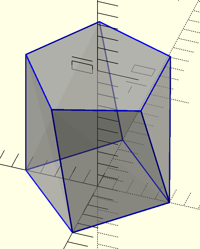

of horizontal slices to correctly capture the curvature of the faces.  As
is split.  Personal preference.  But also, I think this model is bad
because it has lots of very long skinny triangles.  You can model more
efficiently and the result is better, in my opinion, when the triangles are
as close to equilateral as possible.  Models like the above produce moire
effects and can be hard to view, and if you decrease the triangle count,
you get rippling across the surfaces.  The rippling never goes away---just
gets smaller as you shrink the triangles.  A horizontal section of such a
model will show zig-zag edges.

On Sat, Jan 21, 2023 at 8:10 PM Sanjeev Prabhakar <
result:
morelines will produce much refined results and should work in most of the
cases

Sun, Jan 22, 2023 3:30 AM
I would consider that connection a poor one.  The point of the star maps
unnaturally to an arbitrary point in the middle of the curve, for example.
The long protrusion maps oddly to a small segment of the star.  It doesn't
look good to me.  However, I do think that mapping a discrete shape like
the star to a continuous shape may be the more difficult case to produce a
nice looking result, especially in the example you show where the
continuous curve is actually a rounded version of a discrete curve.
For discrete shapes I think the best result is obtained when the mapping is
done before the shape is subsampled, so in the case of the star, you map
the 10 points somewhere, and then
pure openscad code.
result:
cases
cones, but there are a couple things that limit this.  For most
interesting cases, you need many slices to produce the correct form and to
avoid producing artifacts on the curved faces that arise.  (See Jordan's
exists in libraries (it's also here now).
