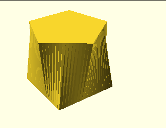

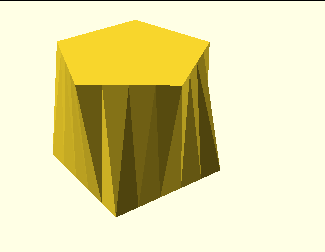

The other thing is that your condition doesn't actually provide an
alignment algorithm that always produces a good result.  For example, in
connecting a pentagon to a square the result of such an algorithm will be
ugly.  You need instead to match up the vertices somehow, and collapse two
pentagon vertices onto one square vertex.
in connecting a pentagon to a square the result of such an algorithm
will be ugly.  You need instead to match up the vertices somehow, and
collapse two pentagon vertices onto one square vertex.
I was curious what a "match up by angle" algorithm would produce, so I
wrote something kind of similar.  It samples both polygons the same
number of times, linearly along the perimeter, and connects them.  The
result is ... interesting.  I don't know that it's right, but I also
don't know that it's wrong.  Most disturbing is that one side ends up
flat while the others end up curved.

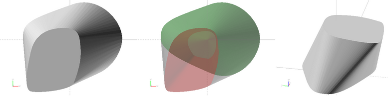

On 2023-01-21 10:38 a.m., Sanjeev Prabhakar wrote:
I mean of both the sections are convex it should be simpler
Indeed. And if I have understood the enhancement being discussed, in the
case of two convex ends you can already achieve the required effect with
current OpenSCAD facilities. That is, if both ends of the extruded shape
are fully convex (continuously convex along the perimeters) then the
required morphing can be achieved using hull of two 'cones', one of
which is inverted. The method requires that both starting 2D shapes must
surround the z axis/x-y origin, but you can use multmatrix afterwards to
skew the 3D shape if you need to have one end outside the z axis.
In the example below, I made the cones from SVG outlines by using
linear_extrude with scale = 0. For an end that is an ordinary polygon, I
would create a cone using the cylinder command with one of the r
parameters set to zero and a suitable $fn value (maybe also rotating it
around z axis to get a nice outline).
hull() {
   linear_extrude(50,scale=0)import("convex1.svg");
translate([0,0,50])mirror([0,0,1])linear_extrude(50,scale=0)import("convex2.svg");
Here, red is the inverted cone, green the upright cone, grey is the
hulled object.
Steve

On 1/21/2023 12:24 PM, Steve Lelievre wrote:
the required morphing can be achieved using hull of two 'cones', one
of which is inverted.
I'm missing what the cone-ness brings to the picture, versus just having
each of them infinitesimally thin and then hulling them.
(But note that hull won't help if the figures aren't convex.)
On 1/21/2023 12:24 PM, Steve Lelievre wrote: > the required morphing can be achieved using hull of two 'cones', one > of which is inverted. I'm missing what the cone-ness brings to the picture, versus just having each of them infinitesimally thin and then hulling them. (But note that hull won't help if the figures aren't convex.)
Sat, Jan 21, 2023 9:07 PM
If you use very thin cylinders you get extra edges very close together,
which can cause issues. Cones avoid that as the base is a single edge
rather than two very close together.

Jordan,
I like the cones because they only involve the one perimeter at the wide
end so the shape produced is completely 'correct' in geometrical terms.
As well, to me the code required is just as simple as it is for flat end
shapes.
And yes, I agree (and also mentioned) that the hulling option is only
valid for convex end shapes. The good thing about it is that it's here now.
Steve
Jordan, I like the cones because they only involve the one perimeter at the wide end so the shape produced is completely 'correct' in geometrical terms. As well, to me the code required is just as simple as it is for flat end shapes. And yes, I agree (and also mentioned) that the hulling option is only valid for convex end shapes. The good thing about it is that it's here now. Steve On 2023-01-21 12:43 p.m., Jordan Brown wrote: > On 1/21/2023 12:24 PM, Steve Lelievre wrote: >> the required morphing can be achieved using hull of two 'cones', one >> of which is inverted. > > I'm missing what the cone-ness brings to the picture, versus just > having each of them infinitesimally thin and then hulling them. > > (But note that hull won't help if the figures aren't convex.)
