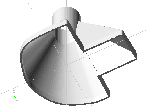

Fri, Jan 20, 2023 4:41 PM
Terry,
I had another thought - simplistic but I think it should be enough for
your needs:
Make a solid object by importing your SVG and using linear_extrude to
convert it into a cone (by setting the scale parameter to 0). Add a
cylinder to match the required inside radius of your hose end and tall
enough to protrude by the distance you need. Add a straight-sided
linear_extruded section at the bottom to make a connector for your
blower end.
Repeat to make a second object, but this time offset the SVG to make it
a bit bigger and also widen the cylinder to the required outer radius.
Take the difference of the two objects, second minus first, to produce a
hollow funnel.
The following sample code does the job. You might have to alter the
bottom outline depending on whether you want your blower to fit inside
or outside the funnel, and for the specific dimensions and connector
lengths you need (and of course, if the exact wall thickness is
important you would have to use minkowski  to form the outer shape.)
file = "footprint.svg";
$fn = 60;
      linear_extrude(100, scale = 0) offset(2) import(file);
      cylinder(100, r = 15 + 2);
      translate([0, 0, -10]) linear_extrude(10) offset(2) import(file);
      linear_extrude(100, scale = 0) import(file);
      cylinder(100, r = 15);
      translate([0, 0, -10])linear_extrude(10) import(file);
And here's a screenshot using an arbitrary footprint.
Cheers,
Steve

I had another thought - simplistic but I think it should be enough for your needs:
Make a solid object by importing your SVG and using linear_extrude to convert it into a cone (by setting the scale parameter to 0). Add a cylinder to match the required inside radius of your hose end and tall enough to protrude by the distance you need. Add a straight-sided linear_extruded section at the bottom to make a connector for your blower end.
Repeat to make a second object, but this time offset the SVG to make it a bit bigger and also widen the cylinder to the required outer radius.
Take the difference of the two objects, second minus first, to produce a hollow funnel.
The following sample code does the job. You might have to alter the bottom outline depending on whether you want your blower to fit inside or outside the funnel, and for the specific dimensions and connector lengths you need (and of course, if the exact wall thickness is important you would have to use minkowski to form the outer shape.)
$fn = 60;
<00AwiOdUczn1Et7F.png>
Cheers,
Steve

Thanks Steve. But why the hollow ‘wedge’ extension? Without that, it
looks like my original intention.
It just means l wasn't quite clear about the shape you wanted.
Steve
