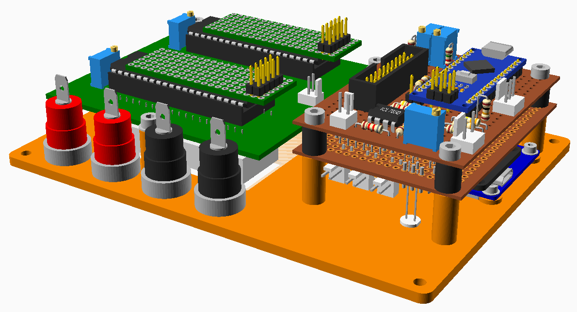

                            Why not the first shape for union as well?  I most often start with the
main body of an object and then union on the twiddly bits. For example a
case panel with added screw pillars.
It would seem a bit odd having to colour the last pillar.

                            In 3D, with full colour objects that have volumetric colour, the only difference between "first wins" and "last wins" in a union is the colour of the points inside the shape. The surface colours are the same in both cases, so you don't see any visible difference in a model like this (where all the shapes are opaque).
That's why I focussed on the 2D case in deciding what design feels most natural. In 2D graphics APIs, it is most common that the last shape you painted on the canvas is the one that "wins", just like applying brush strokes to a canvas in a physical painting.
