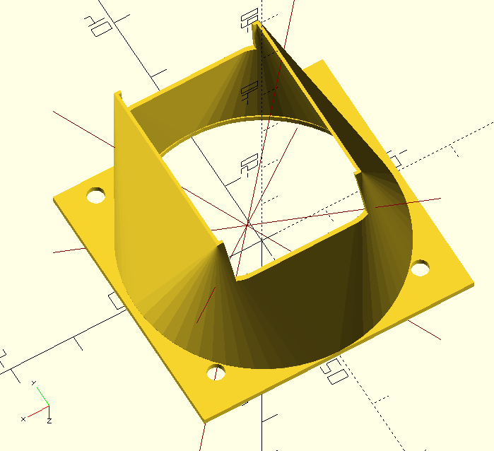

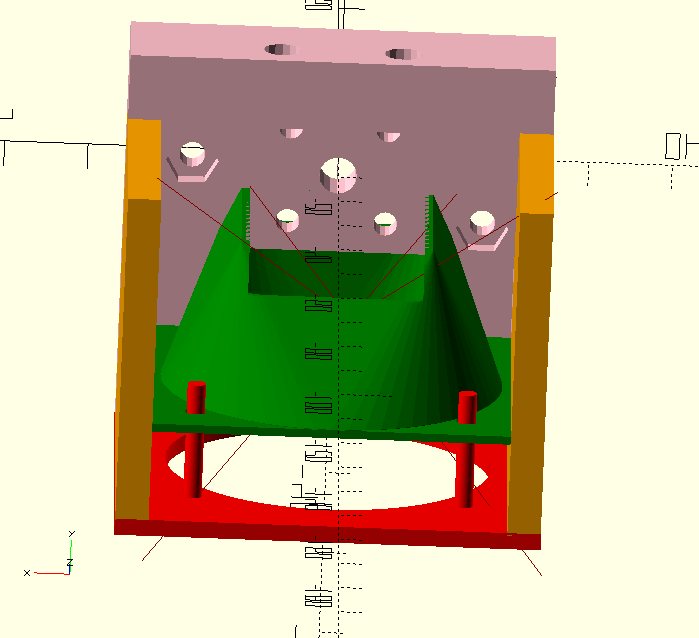

Mon, Nov 21, 2022 4:07 PM
On 11/13/22 18:01, Steve Lelievre wrote:
I'm not entirely clear what shape you're aiming for; is it something
like this? (once adjusted for your exact dimensions)
Steve
   hull(){
      translate([0,0,20 - 1]) cylinder(h = 1, d = 39 + 2, center=true);
      cube([22 + 1, 27 + 1, 1], center=true);
   hull(){
      translate([0,0, 20 - 1]) cylinder(h = 1, d = 39, center=true);
      cube([22, 27, 1], center=true);
I bent, folded, stapled and otherwise mutilated this, got into a couple
days of it not rendering via F6, but I think I have it. test build on
the printer now. I added a more or less square flange to the input
circle, perforated that with some peg holes that match the holes in the
fan, and offset the output rectangle, and added another difference cube,
so it should now fit on the pegs sticking out of the front panel that
locate the fan, this sits on top of the fan and if the last difference
cube is correctly placed, it will be trapped until the heat from the hot
block a mm away, destroys it. Its the fans job to cool it enough that
doesn't happen.
Looks like the attached .png now.
Also a sorta bottom view, where each color is a different part on the
printer.
Thank you very much, Steve, it was, and is now, exactly what I had in mind.
Take care & stay well.
Cheers, Gene Heskett.

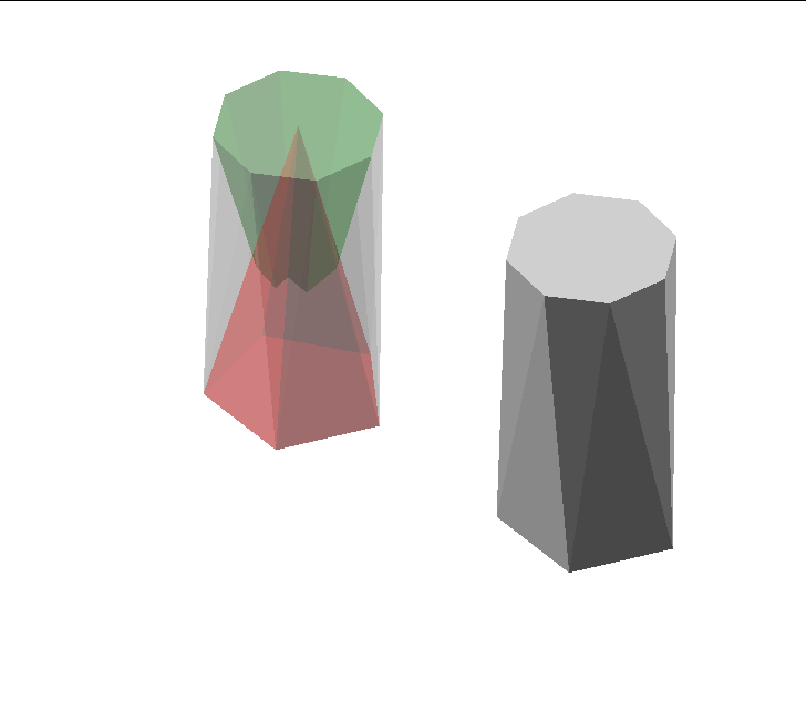

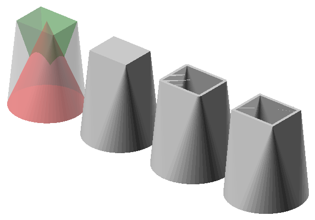

Sun, Dec 11, 2022 10:33 PM
FYI,
I know that this thread is old now so interest will have waned and the
OP's requirement has been solved ... but I just realized that there is a
better way than I suggested in my original post from weeks ago, for
morphing a tube from having a rectangular end to a circular end (which
is what the OP wanted to do for a fan housing.)
The transition can be achieved, both exactly and code-efficiently, by
hulling a cone and an inverted pyramid. I implemented this solution as
the very small module called morph contained in the code pasted after my

More generally, if you want to morph any polygon to any other polygon,
such as a pentagon to octagon as shown here, you just hull together a
cone and an inverted cone, setting the number of sides required for each
cone by supplying $fn parameters.
Cheers,
Steve

// Extending the idea to make a tubular connector:
// Option A. Using Minkowski ensures wall thickness is exactly as
specified when measured in cross section.
// Corners of the rectangular end are rounded accordingly. THe corner
radius is the wall thickness.
module tubeA(h, d, x, y, w) {
   // Creates an open tube by Minkowski addition of a sphere to an
internal shape,
   // followed by trimming back to height and then subtraction of the
internal shape to hollow out the tube.
   // w: wall thickness. This is the thickness in cross section (what
would usually be considered the 'true' value).
   // The other parameters are those used in the morph module.
   sizeLimit = max(d / 2 + w, sqrt((x + w)^2 + (y + d)^2)); // maximum
radius needed for trimming cylinder
         minkowski() {
            morph(h, d, x, y);
            sphere(r = w);
         cylinder(h = h, r = sizeLimit);
      morph(h, d, x, y);
translate([15, 0, 0]) tubeA(30, 25, 15, 12, 1);
// Option B. Subtract inner shape from geometrically similar but
slightly larger outer shape.
// Gives square corners to rectangular end.
// !!! However, in some cases, the wall's cross section will be thinner
than this value !!!
module tubeB(h, d, x, y, w) {
   // w: wall thickness in horizontal section.
      morph(h, d + 2 * w, x + 2 * w, y + 2 * w);
      morph(h, d, x, y);
translate([45, 0, 0]) tubeB(30, 25, 15, 12, 1);
