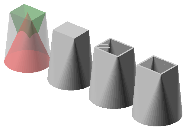

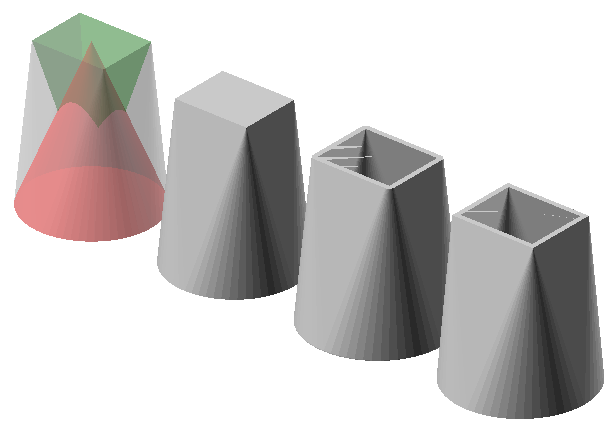

FYI,
I know that this thread is old now so interest will have waned and the
OP's requirement has been solved ... but I just realized that there is
a better way than I suggested in my original post from weeks ago, for
morphing a tube from having a rectangular end to a circular end (which
is what the OP wanted to do for a fan housing.)
The transition can be achieved, both exactly and code-efficiently, by
hulling a cone and an inverted pyramid. I implemented this solution as
the very small module called morph contained in the code pasted after
my signature (feel free to copy/adapt). To convert the morphed shape
to a hollow tube you either use Minkowski or make slightly oversize
version of the same shape, then subtract the original shape to leave
only walls (see the notes in my code.)

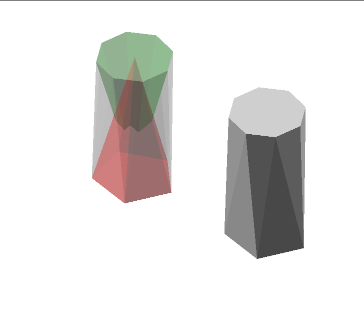

More generally, if you want to morph any polygon to any other polygon,
such as a pentagon to octagon as shown here, you just hull together a
cone and an inverted cone, setting the number of sides required for
each cone by supplying $fn parameters.
Cheers,
Steve
$fn = 60;
module morph(h, d, x, y) {
   // Morphs a rectangle to a circle. By Steve Lelievre, 2022.
   // h: transition height.
   // d: diameter of circular lower end.
   // x: x dimension (length) of rectangular upper end.
   // y: y dimension (width) of rectangular upper end.
   hull() {
      resize([d, d, h]) cylinder(h = 1, r1 = 0, r2 = 1);  // cone
      resize([x, y, h]) rotate(45) cylinder(h = 1, r1 = 1, r2 = 0, $fn
= 4); // inverted pyramid
// Example usage
translate([-15, 0, 0]) morph(30, 25, 15, 12);
// Code snippet to demonstrate how the morph works
translate([-45, 0, 0]) union() {
   color("red", 0.3) resize([25, 25, 30]) cylinder(h = 1, r1 = 0, r2 =
1);  // cone
   color("green", 0.3) resize([15, 12, 30]) rotate(45) cylinder(h = 1,
r1 = 1, r2 = 0, $fn = 4); // inverted pyramid
   color("silver", 0.3) morph(30, 25, 15, 12);
// Extending the idea to make a tubular connector:
// Option A. Using Minkowski ensures wall thickness is exactly as
specified when measured in cross section.
// Corners of the rectangular end are rounded accordingly. THe corner
radius is the wall thickness.
module tubeA(h, d, x, y, w) {
   // Creates an open tube by Minkowski addition of a sphere to an
internal shape,
   // followed by trimming back to height and then subtraction of the
internal shape to hollow out the tube.
   // w: wall thickness. This is the thickness in cross section (what
would usually be considered the 'true' value).
   // The other parameters are those used in the morph module.
   sizeLimit = max(d / 2 + w, sqrt((x + w)^2 + (y + d)^2)); // maximum
radius needed for trimming cylinder
         minkowski() {
            morph(h, d, x, y);
            sphere(r = w);
         cylinder(h = h, r = sizeLimit);
      morph(h, d, x, y);
translate([15, 0, 0]) tubeA(30, 25, 15, 12, 1);
// Option B. Subtract inner shape from geometrically similar but
slightly larger outer shape.
// Gives square corners to rectangular end.
// !!! However, in some cases, the wall's cross section will be
thinner than this value !!!
module tubeB(h, d, x, y, w) {
   // w: wall thickness in horizontal section.
      morph(h, d + 2 * w, x + 2 * w, y + 2 * w);
      morph(h, d, x, y);
translate([45, 0, 0]) tubeB(30, 25, 15, 12, 1);

On 2022-12-11 3:04 p.m., jon wrote:
No need for a cone and a pyramid.  A circle and a square will do.
I need to be told how.
Because hulling 2D shapes to get a 3D shape is not possible, I just
can't see a method to achieve the shape directly from a square and a
circle.
That is, unless you actually mean a very thin disk and very thin cube.
That is what I originally came up with but am replacing because it was a
little more complex and doesn't produce a geometrically-correct transition.
Thanks,
Steve

Sun, Dec 11, 2022 11:37 PM
Yes.  A circle and a square linearly extruded to be 0.01 mm thick.
Interesting that this approach did not work for you.  I wonder why.

= 1);  // cone
1, r1 = 1, r2 = 0, $fn = 4); // inverted pyramid
corner radius is the wall thickness.
internal shape,
the internal shape to hollow out the tube.
(what would usually be considered the 'true' value).
maximum radius needed for trimming cylinder
         minkowski() {
            morph(h, d, x, y);
            sphere(r = w);
      morph(h, d, x, y);
      morph(h, d, x, y);

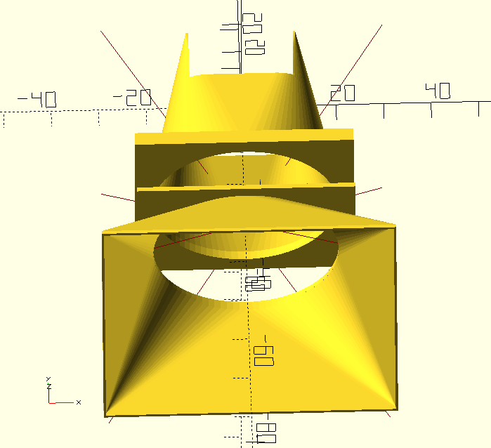

Yes.  A circle and a square linearly extruded to be 0.01 mm thick.  Interesting that this approach did not work for you.  I wonder why. On 12/11/2022 6:36 PM, Steve Lelievre wrote: > Hi, > > On 2022-12-11 3:04 p.m., jon wrote: >> >> No need for a cone and a pyramid.  A circle and a square will do. >> > I need to be told how. > > Because hulling 2D shapes to get a 3D shape is not possible, I just > can't see a method to achieve the shape directly from a square and a > circle. > > That is, unless you actually mean a very thin disk and very thin cube. > That is what I originally came up with but am replacing because it was > a little more complex and doesn't produce a geometrically-correct > transition. > > Thanks, > > Steve > > >> On 12/11/2022 5:33 PM, Steve Lelievre wrote: >>> >>> FYI, >>> >>> I know that this thread is old now so interest will have waned and >>> the OP's requirement has been solved ... but I just realized that >>> there is a better way than I suggested in my original post from >>> weeks ago, for morphing a tube from having a rectangular end to a >>> circular end (which is what the OP wanted to do for a fan housing.) >>> >>> The transition can be achieved, both exactly and code-efficiently, >>> by hulling a cone and an inverted pyramid. I implemented this >>> solution as the very small module called morph contained in the code >>> pasted after my signature (feel free to copy/adapt). To convert the >>> morphed shape to a hollow tube you either use Minkowski or make >>> slightly oversize version of the same shape, then subtract the >>> original shape to leave only walls (see the notes in my code.) >>> >>> >>> >>> More generally, if you want to morph any polygon to any other >>> polygon, such as a pentagon to octagon as shown here, you just hull >>> together a cone and an inverted cone, setting the number of sides >>> required for each cone by supplying $fn parameters. >>> >>> Cheers, >>> >>> Steve >>> >>> >>>>>>>>>>>>>>>>>>>>>>>>>>>>>>>>>>> >>> >>> $fn = 60; >>> >>> >>> module morph(h, d, x, y) { >>>    // Morphs a rectangle to a circle. By Steve Lelievre, 2022. >>>    // h: transition height. >>>    // d: diameter of circular lower end. >>>    // x: x dimension (length) of rectangular upper end. >>>    // y: y dimension (width) of rectangular upper end. >>>    hull() { >>>       resize([d, d, h]) cylinder(h = 1, r1 = 0, r2 = 1);  // cone >>>       resize([x, y, h]) rotate(45) cylinder(h = 1, r1 = 1, r2 = 0, >>> $fn = 4); // inverted pyramid >>>    } >>> } >>> >>> // Example usage >>> translate([-15, 0, 0]) morph(30, 25, 15, 12); >>> >>> // Code snippet to demonstrate how the morph works >>> translate([-45, 0, 0]) union() { >>>    color("red", 0.3) resize([25, 25, 30]) cylinder(h = 1, r1 = 0, r2 >>> = 1);  // cone >>>    color("green", 0.3) resize([15, 12, 30]) rotate(45) cylinder(h = >>> 1, r1 = 1, r2 = 0, $fn = 4); // inverted pyramid >>>    color("silver", 0.3) morph(30, 25, 15, 12); >>> } >>> >>> // Extending the idea to make a tubular connector: >>> >>> // Option A. Using Minkowski ensures wall thickness is exactly as >>> specified when measured in cross section. >>> // Corners of the rectangular end are rounded accordingly. THe >>> corner radius is the wall thickness. >>> >>> module tubeA(h, d, x, y, w) { >>>    // Creates an open tube by Minkowski addition of a sphere to an >>> internal shape, >>>    // followed by trimming back to height and then subtraction of >>> the internal shape to hollow out the tube. >>>    // w: wall thickness. This is the thickness in cross section >>> (what would usually be considered the 'true' value). >>>    // The other parameters are those used in the morph module. >>> >>>    sizeLimit = max(d / 2 + w, sqrt((x + w)^2 + (y + d)^2)); // >>> maximum radius needed for trimming cylinder >>>    difference() { >>>       intersection() { >>>          minkowski() { >>>             morph(h, d, x, y); >>>             sphere(r = w); >>>          } >>>          cylinder(h = h, r = sizeLimit); >>>       } >>>       morph(h, d, x, y); >>>    } >>> } >>> >>> translate([15, 0, 0]) tubeA(30, 25, 15, 12, 1); >>> >>> // Option B. Subtract inner shape from geometrically similar but >>> slightly larger outer shape. >>> // Gives square corners to rectangular end. >>> // !!! However, in some cases, the wall's cross section will be >>> thinner than this value !!! >>> >>> module tubeB(h, d, x, y, w) { >>>    // w: wall thickness in horizontal section. >>>    // The other parameters are those used in the morph module. >>> >>>    difference() { >>>       morph(h, d + 2 * w, x + 2 * w, y + 2 * w); >>>       morph(h, d, x, y); >>>    } >>> } >>> >>> translate([45, 0, 0]) tubeB(30, 25, 15, 12, 1); >>> >>> <<<<<<<<<<<<<<<<<<<<<<<<<<<<<< >>> >>> >>> On 2022-11-13 3:00 p.m., Steve Lelievre wrote: >>>> >>>> I'm not entirely clear what shape you're aiming for; is it >>>> something like this? (once adjusted for your exact dimensions) >>>> >>>> Steve >>>> >>>> >>>> >>>> >>> >>> _______________________________________________ >>> OpenSCAD mailing list >>> To unsubscribe send an email todiscuss-leave@lists.openscad.org
Sun, Dec 11, 2022 11:45 PM
Well they are cubes and cylinders once extruded.
A cone is better because it has one set of edges instead of two sets very
close together. The cone could be very short to make it almost flat.
FYI,
OP's requirement has been solved ... but I just realized that there is a
morphing a tube from having a rectangular end to a circular end (which is
hulling a cone and an inverted pyramid. I implemented this solution as the
very small module called morph contained in the code pasted after my
signature (feel free to copy/adapt). To convert the morphed shape to a
hollow tube you either use Minkowski or make slightly oversize version of
the same shape, then subtract the original shape to leave only walls (see
such as a pentagon to octagon as shown here, you just hull together a cone
and an inverted cone, setting the number of sides required for each cone by
Cheers,
Steve
$fn = 60;
hull() {
resize([x, y, h]) rotate(45) cylinder(h = 1, r1 = 1, r2 = 0, $fn =
// Example usage
1);  // cone
color("green", 0.3) resize([15, 12, 30]) rotate(45) cylinder(h = 1, r1
internal shape,
minkowski() {
morph(h, d, x, y);
sphere(r = w);
morph(h, d, x, y);
// Option B. Subtract inner shape from geometrically similar but slightly
larger outer shape.
// !!! However, in some cases, the wall's cross section will be thinner
than this value !!!
   morph(h, d, x, y);
I'm not entirely clear what shape you're aiming for; is it something like
Steve
Well they are cubes and cylinders once extruded. A cone is better because it has one set of edges instead of two sets very close together. The cone could be very short to make it almost flat. On Sun, 11 Dec 2022 at 23:38, Steve Lelievre < steve.lelievre.canada@gmail.com> wrote: > Hi, > > On 2022-12-11 3:04 p.m., jon wrote: > > No need for a cone and a pyramid. A circle and a square will do. > > I need to be told how. > > Because hulling 2D shapes to get a 3D shape is not possible, I just can't > see a method to achieve the shape directly from a square and a circle. > > That is, unless you actually mean a very thin disk and very thin cube. > That is what I originally came up with but am replacing because it was a > little more complex and doesn't produce a geometrically-correct transition. > > Thanks, > > Steve > > > On 12/11/2022 5:33 PM, Steve Lelievre wrote: > > FYI, > > I know that this thread is old now so interest will have waned and the > OP's requirement has been solved ... but I just realized that there is a > better way than I suggested in my original post from weeks ago, for > morphing a tube from having a rectangular end to a circular end (which is > what the OP wanted to do for a fan housing.) > > The transition can be achieved, both exactly and code-efficiently, by > hulling a cone and an inverted pyramid. I implemented this solution as the > very small module called morph contained in the code pasted after my > signature (feel free to copy/adapt). To convert the morphed shape to a > hollow tube you either use Minkowski or make slightly oversize version of > the same shape, then subtract the original shape to leave only walls (see > the notes in my code.) > > > More generally, if you want to morph any polygon to any other polygon, > such as a pentagon to octagon as shown here, you just hull together a cone > and an inverted cone, setting the number of sides required for each cone by > supplying $fn parameters. > > Cheers, > > Steve > >>>>>>>>>>>>>>>>>>>>>>>>>>>>>>>>>>> > > $fn = 60; > > > module morph(h, d, x, y) { > // Morphs a rectangle to a circle. By Steve Lelievre, 2022. > // h: transition height. > // d: diameter of circular lower end. > // x: x dimension (length) of rectangular upper end. > // y: y dimension (width) of rectangular upper end. > hull() { > resize([d, d, h]) cylinder(h = 1, r1 = 0, r2 = 1); // cone > resize([x, y, h]) rotate(45) cylinder(h = 1, r1 = 1, r2 = 0, $fn = > 4); // inverted pyramid > } > } > > // Example usage > translate([-15, 0, 0]) morph(30, 25, 15, 12); > > // Code snippet to demonstrate how the morph works > translate([-45, 0, 0]) union() { > color("red", 0.3) resize([25, 25, 30]) cylinder(h = 1, r1 = 0, r2 = > 1); // cone > color("green", 0.3) resize([15, 12, 30]) rotate(45) cylinder(h = 1, r1 > = 1, r2 = 0, $fn = 4); // inverted pyramid > color("silver", 0.3) morph(30, 25, 15, 12); > } > > // Extending the idea to make a tubular connector: > > // Option A. Using Minkowski ensures wall thickness is exactly as > specified when measured in cross section. > // Corners of the rectangular end are rounded accordingly. THe corner > radius is the wall thickness. > > module tubeA(h, d, x, y, w) { > // Creates an open tube by Minkowski addition of a sphere to an > internal shape, > // followed by trimming back to height and then subtraction of the > internal shape to hollow out the tube. > // w: wall thickness. This is the thickness in cross section (what > would usually be considered the 'true' value). > // The other parameters are those used in the morph module. > > sizeLimit = max(d / 2 + w, sqrt((x + w)^2 + (y + d)^2)); // maximum > radius needed for trimming cylinder > difference() { > intersection() { > minkowski() { > morph(h, d, x, y); > sphere(r = w); > } > cylinder(h = h, r = sizeLimit); > } > morph(h, d, x, y); > } > } > > translate([15, 0, 0]) tubeA(30, 25, 15, 12, 1); > > // Option B. Subtract inner shape from geometrically similar but slightly > larger outer shape. > // Gives square corners to rectangular end. > // !!! However, in some cases, the wall's cross section will be thinner > than this value !!! > > module tubeB(h, d, x, y, w) { > // w: wall thickness in horizontal section. > // The other parameters are those used in the morph module. > > difference() { > morph(h, d + 2 * w, x + 2 * w, y + 2 * w); > morph(h, d, x, y); > } > } > > translate([45, 0, 0]) tubeB(30, 25, 15, 12, 1); > > <<<<<<<<<<<<<<<<<<<<<<<<<<<<<< > > > On 2022-11-13 3:00 p.m., Steve Lelievre wrote: > > I'm not entirely clear what shape you're aiming for; is it something like > this? (once adjusted for your exact dimensions) > > Steve > > > > > > _______________________________________________ > OpenSCAD mailing list > To unsubscribe send an email to discuss-leave@lists.openscad.org > > _______________________________________________ > OpenSCAD mailing list > To unsubscribe send an email to discuss-leave@lists.openscad.org >
Sun, Dec 11, 2022 11:54 PM
 hull together a cone and an inverted cone, setting the number of
 sides required for each cone by supplying $fn parameters.

       morph(h, d, x, y);
 Steve

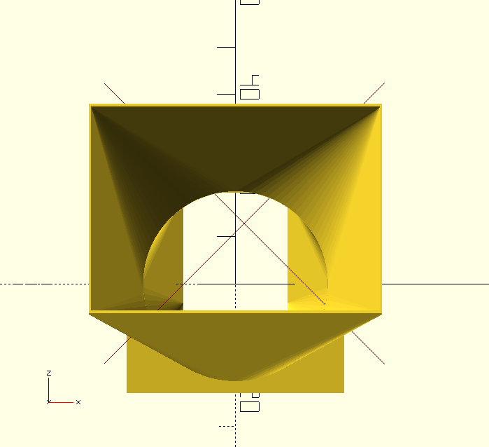

So. back to my fan rig setup that started this thread. I wound up making
the square front thicker so it was the front of the fan box, resulting
in a 10mm longer funnel from circular input to rectangular thru the
cooling fins on the heat break output. Then I put the fan on the front
of the box, not inside it. But it was still too close to the bed and
sucks in all the hair from the extruder, resulting in the fan getting
blocked, stopping and since it wasn't a prusa which  monitors the tach
signal from the fans, the stopped fan burned up the by then plastic
carriage from the heat conducted up thru the fins to the hot ends
mounting.  Since it was the sucked in trash that killed the fan, it
makes sense to raise the intake away from the bed, and increase the
entry cross section to reduce the velocity of the hoover effect, so the
completed rebuild will have another intake snout on the front of the
fan, raising the lower edge of the intake by 20mm, with an even larger
horn about 25mm deep to further slow the air flow. If that does not stop
the suckage, I'll put some plastic screen wire on that horn with a
couple dabs of superglue so I can see the trash collect and pick it off
on the fly. Combined they might weigh 90 grains.
I fix things...  Couple png's attached.
