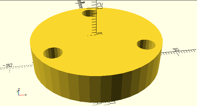

Actually I need to place some holes at a circle:
http://forum.openscad.org/file/t2943/place_holes_on_circle.png
I did with:
diameter = 34.0;
difference () {
    cylinder(h=10, d=diameter + 10);
    cylinder(h=10, d=6);
    translate([0, diameter/2, 0]) {
    rotate (a=120) {
    rotate (a=-120) {
Which results in:
http://forum.openscad.org/file/t2943/place_holes_on_circle_firsttry.png
Is there a better way?

Fri, Aug 28, 2020 1:01 PM
I assume it's slow?
First, you need to translate the differenced cylinders so that they start below the cylinder you're punching holes in, and make them longer so that they poke out part the top.
That should make it render faster
With a FOR loop you only have one set of commands, repated as many times you want around the rim.
(Sorry, don't have time to check the correect syntax right now. I have a CAKE that needs to be eaten... )
And finally, to clean it up a bit, use indentation.
ROTATE ()
TRANSLATE ()
OBJECT();
Notice that there's no need to use the curly brackets because both ROTATE and TRANSLATE expect an object of some sort to follow.

Fri, Aug 28, 2020 1:17 PM
It is faster to do in 2D and then extrude to 3D
diameter = 34.0;
linear_extrude(10)
circle(d = diameter + 10);
    for(i = [-1 : 1])
       rotate(i * 120)
            translate([0, diameter / 2])
                circle(d = 6);

Fri, Aug 28, 2020 3:55 PM
AndyY:
Nophead and Trygve gave some good hints for improvement, but your
original really wasn't all that bad.
What was it that was concerning you about your result?
The only thing I see to complain about in the render that you got is
that the punched-out circles are decagons, and the big circle is still
pretty obviously a polygon.  (It's a 30-gon.)
$fa, $fs, and $fn control the number of sides used for a circle.
https://en.wikibooks.org/wiki/OpenSCAD_User_Manual/Other_Language_Features#$fa,$fs_and$fn
I'd try
$fs = 1;
$fa = 8;
to get a better approximation without going wild.  Mostly, $fs will
control the small circles and $fa will control the large one.

Fri, Aug 28, 2020 4:11 PM
I have a bunch of for_ modules in my main library that provide a simplified
interface to repeated objects
module forN(r=10, N=4, offs=0, M=undef) for($i=[0:(M?M-1:N-1)])
rotate([0,0,offs+$i*360/N])  translate([r,0,0]) children();
module forN(r=10, N=4, offs=0, M=undef) rotN(r, N, offs, M) children();
module forX(dx = 10, N=4) for($x=[0:N-1]) T(-((N-1)/2-$x)*dx) children();
module forY(dy = 10, M=4) for($y=[0:M-1]) Ty(-((M-1)/2-$y)*dy) children();
module forZ(dz = 10, M=4) for($z=[0:M-1]) Tz(-((M-1)/2-$z)*dz) children();
module forXY(dx = 10, N=4, dy = 10, M=4) forX(dx, N) forY(dy, M) children();
with this your code gets:
diameter = 34.0;
linear_extrude(10)
circle(d = 6);
forN(diameter/2, 3) circle(d = 6);
a centered 3 by 4 pattern of objects gets as simple as:
forXY(10, 3, 15, 4) circle(3);
the $ provides access to the iteration variable:
forX(20, 5) text(str($x));

linear_extrude(10) {
        for(i = [-1 : 1])
           rotate(i * 120)
                    circle(d = 6);
Thank you very much! I like it.
In addition to that I know the $fn var. But not the other ones. So I have to
read the wiki for further information concerning this two vars.
Thank you very much for the help! I'm completly new in 3D CAD. Mostly I used it for realized models or some printings. This one should be a holder for a electro magnet. Can someone give me a hint how I can format source code in this forum??? It looks ugly in the normal format. For me this is really a nice solution: ``` $fs = 1; $fa = 8; $fn = 64; diameter = 34.0; linear_extrude(10) { difference() { circle(d = diameter + 10); for(i = [-1 : 1]) rotate(i * 120) translate([0, diameter / 2]) circle(d = 6); } } ``` Thank you very much! I like it. In addition to that I know the $fn var. But not the other ones. So I have to read the wiki for further information concerning this two vars. -- Sent from: http://forum.openscad.org/
AndyY
Fri, Aug 28, 2020 7:11 PM
The holes arround the circle are getting screws for holding the magnet. So if
I have the holes in a little bigger size it does not matter if there are
some errors of the position.
Concerning you post @JordanBrown: This is a very important post for me!
Thank you. I guess the error comes from the calcuation in the OpenSCAD
engine? Which means that this is the error of the exactly position of the
holes. As I wrote in the previous post I immediatelly need to check the vars
($fs/$fa) for further designs. If you have some more internal informations,
I'd like to know it...
