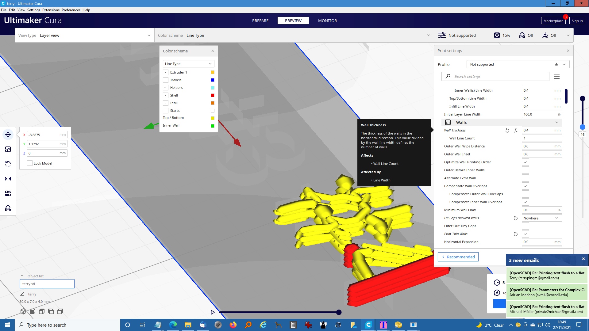

Yes, we see your attachments. The problem is that the object is tiny. Can
you scale it up in x and y by a factor of 2 or 3?

Thanks for testing. That motivated me to install PrusaSlicer and load the
STL.
Attached or here:
https://www.dropbox.com/s/7v84l70rbextg5p/Hollow3and4.stl?raw=1
But when slices and previewed I still don't see the text '#4' on the right
hand
side. It looks almost the same as in Cura. And same after trying the
'Repair'
option. Screenshot attached, or here:
https://www.dropbox.com/s/xoywpxf9o7g3xpt/Prusa-2.jpg?raw=1
So, you do see all the text? Is it possible to export PrusaSlicer
settings? If
so it would be very helpful if you could send me yours please.
I'm rarely able to see my own posts. Could I get confirmation that my
attachments are OK please? Both the one attached and the link?
Terry

Terry:
You cannot realistically print an object of this size with this level of
detail on a regular FDM printer.  If you used an 0.1 mm nozzle, maybe,
but this kind of object is best printed on a resin printer, that can
handle the details required

I'm sorry - I was sloppy with my original test and missed the missing
#4.  In retesting I had to go to 160% to get it all.  Seems the post
mentioning size was correct.  I suspect a little bolder font might work
in the original size.  Current lines are a bit too thin.
My PrusaSlicer settings are the standard supplied for the Prusa Mini.

Going bold helped a bit  - worked at 140%.  You might try other fonts.
Here is what I just used:
text("#4", 4, font="Bitstream Charter:style=Bold");

Thanks Ray. No problem, in fact I'm relieved that it's not down to me or my
settings.
I'll try that and other fonts and styles. I was thinking of changing to a
bolder one anyway, once I'd established the basics.
The 175 mm panel with two rows of 5 labels, and allowing say 15 mm at the
edges, I reckon on 29 mm per label. Not a lot, but they will mostly be
short abbreviations.
