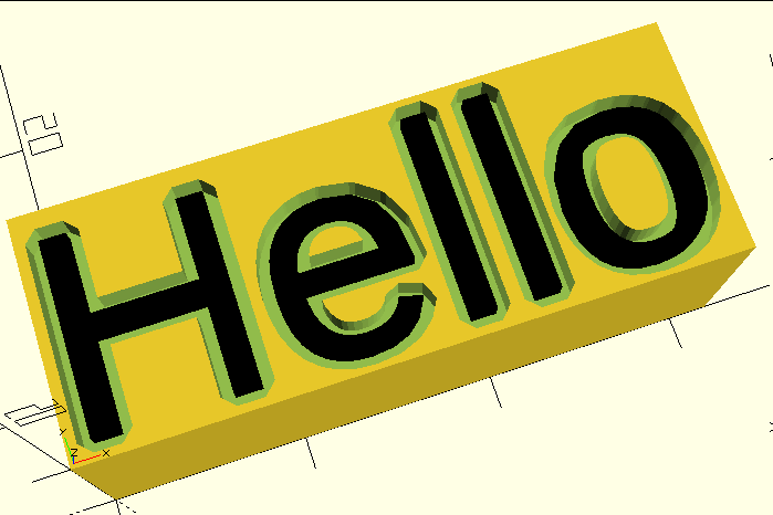

So for now I'm focusing on OpenSCAD/Cura solutions.
With the code shown I can print this hollow example in size 7 text.
It looks fine previewed in Cura.
https://www.dropbox.com/s/tdk9rw3u35ss4un/ArilalNB7Cura.jpg?raw=1
translate([0, 8, 0])
cube([28, 12, 3]); //
translate([0, 11, -0.5])
color("red")
linear_extrude(5)
text(" Off-On ", 7, font="Arial:style=Narrow Bold"); // Size 7 text, empty
But I'd like to try my 'push in' idea next.  So I'm about to add code that will
print the solid text itself, in the same run. Before I do...
Q1: I assume I should make it a tad smaller? Say 6.9?
Q2: I'll obviously soon find out, but will it print isolated letters
successfully, or must I add support?
Q3: If so, would others recommend I keep that to a minimum by coding it myself
rather than using Cura's support options?

David,
As you may have seen from my recent pots I'm leaning towards that method -
push fit. Could you expand a bit on the details please? As I understand it
you do two prints. One for the 'hollow/' text in the base. The other for
the text itself, which is the part I need more details about.
Do you make it smaller than the cavities into which it will be pushed, and
if so how much?
Do you get your slicer to support the individual characters of the string?
What font do you recommend?
What is the smallest text size you use?
Any other tips/pitfalls?

You are going to have to experiment.
You must make the cavities slightly larger than whatever you put into them.
My rule of thumb is that things inserted into other things need 0.25mm of clearance for a tight fit that could end up being permanent. A loose fit is 0.5mm. These numbers are based on regular shapes like cylinders and cubes. Text could be another ball game. It also sounds like your text is quite small.
I would start with the text the size you think you need for the solid text. Then subtract larger versions of that text to make the hollow portion until you get something that fits. I don’t have a clue how OpenSCAD will do scaling in this case or what will happen with the inner parts the lettering. Maybe start by making the text bold when you subtract it. After that, either scale with OpenSCAD scaling or by making the text larger. I really don’t know. This is doable but you will have to experiment.
I’ve only done this with text using dual extrusion, which makes it easy. I’ve made press fit parts but not with text.
Use simple font with lots of vertical and horizontal lines.
You don't want scaling.  You want offset().
Consider a capital O.  You want the outer edge of the O to get larger,
and that sounds like scaling.  But you want the inner edge to get
smaller, and that's not like scaling at all.
Consider "A VERY LONG STRING".  For any single letter, you want the
letter to get (say) 0.4mm wider.  That sounds like scaling.  But you
don't want the overall length of the string to increase by 0.4mm per
letter
.  You want the letters to stay in the same place, and get
larger, with the spacing between them getting smaller.
You want something sort of like this:
// Text to create
str = "Hello";
// Size of block
w = 32;
d = 12;
h = 10;
// Thickness of letters to be pushed into place
t = 1;
// Gap around letter (exaggerated for visibility).
// Used for both X-Y and Z; should perhaps have a
// separate Z value.
gap = 0.6;
// Extend the difference this far above the surface
// to avoid Z-fighting.
epsilon = 1;
    cube([w,d,h]);
    translate([0,1,h-t-gap])
        linear_extrude(height=t+gap+epsilon, convexity=10)
        offset(gap)
        text(str);
color("black")
    translate([0,1,h-t])
    linear_extrude(height=t, convexity=10)
    text(str);
which will yield something like this:
On 11/28/2021 4:39 PM, David Schooley wrote: > I would start with the text the size you think you need for the solid > text. Then subtract larger versions of that text to make the hollow > portion until you get something that fits. I don’t have a clue how > OpenSCAD will do scaling in this case or what will happen with the > inner parts the lettering. You don't want scaling.  You want offset(). Consider a capital O.  You want the outer edge of the O to get larger, and that sounds like scaling.  But you want the inner edge to get *smaller*, and that's not like scaling at all. Consider "A VERY LONG STRING".  For any single letter, you want the letter to get (say) 0.4mm wider.  That sounds like scaling.  But you don't want the overall length of the string to increase by 0.4mm *per letter*.  You want the letters to stay in the same place, and get larger, with the spacing between them getting smaller. You want something sort of like this: // Text to create str = "Hello"; // Size of block w = 32; d = 12; h = 10; // Thickness of letters to be pushed into place t = 1; // Gap around letter (exaggerated for visibility). // Used for both X-Y and Z; should perhaps have a // separate Z value. gap = 0.6; // Extend the difference this far above the surface // to avoid Z-fighting. epsilon = 1; difference() { cube([w,d,h]); translate([0,1,h-t-gap]) linear_extrude(height=t+gap+epsilon, convexity=10) offset(gap) text(str); } color("black") translate([0,1,h-t]) linear_extrude(height=t, convexity=10) text(str); which will yield something like this:

Fortuitous timing, Jordan! I started reading your post while printing the
following 9-minute test. As you see, my tentative ‘solution’ to my sizing
dilemma was different.
