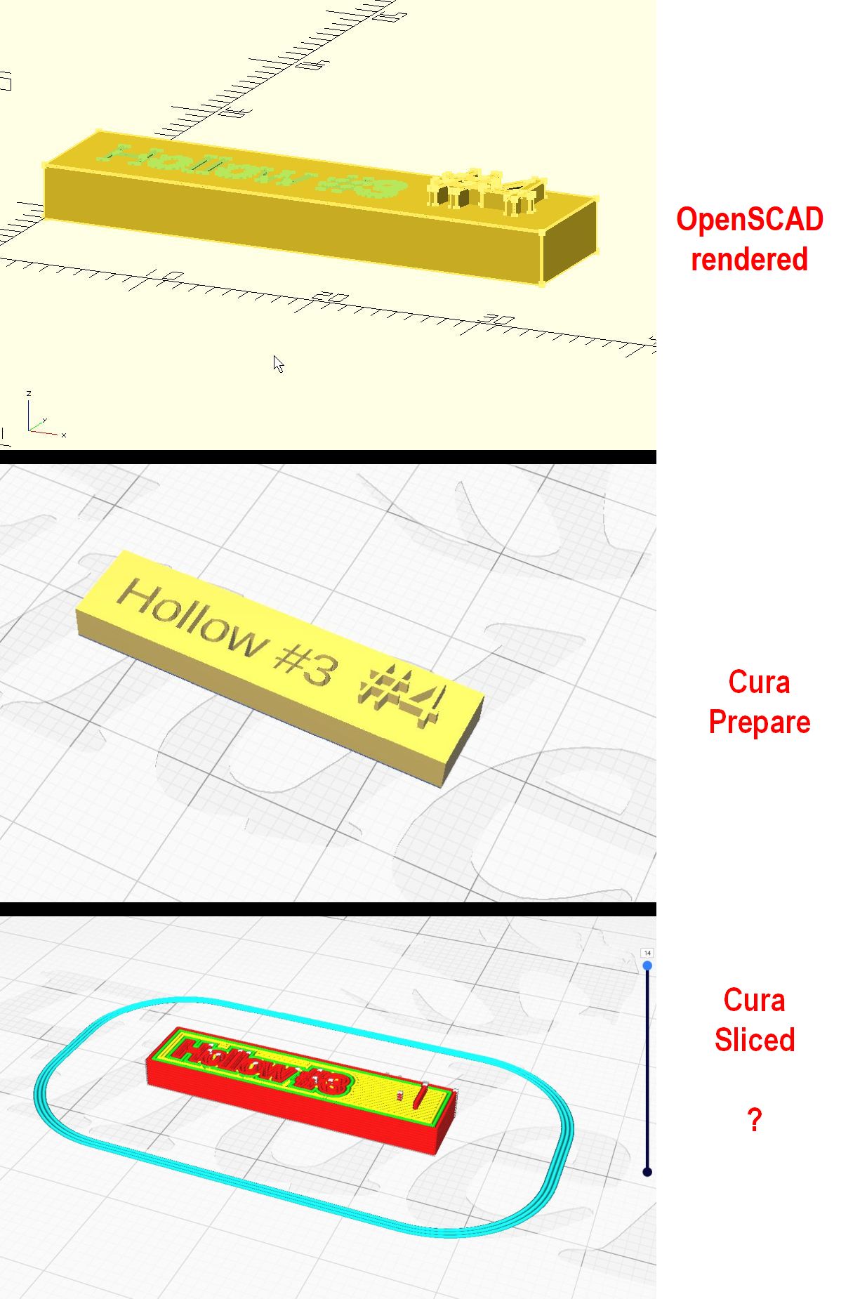

Meanwhile, where am I going wrong with this first very simple (!) test
please. I just wanted to print a small rectangle containing two pieces
of text to:
  1. Give me a feel for font size
  2. Let me try filling some taped hollow text
  3. See what 1 mm high embossed text looks & feels like, prior to
    trying that with white PLA..
But Cura shows that it will at best fail to print the latter, and I
can't spot why?
translate([0, 8, 0])
cube([30, 7, 3]);
translate([2, 10, -0.5])
color("navy")
linear_extrude(5)
text("Hollow #3 ", 3);
translate([22, 10, 1])
color("lime")
linear_extrude(3)
text("#4", 4);

In cura, turn on 'print thin walls - under 'walls' group. For fine
detail, reduce layer height and extrusion width in general.

Found that and enabled it but still the same:
https://www.dropbox.com/s/w50tsac918mg8ok/Hollow-CuraSliced2.jpg?raw=1
Any other settings you see there that might be the culprit?

You might see what happens if you make the letters "thicker" (ie. the walls
thicker). I don't use Cura but suspect whatever you've set the nozzle
diameter to is a limit - you can't print thinner than that

Using a 0.4mm nozzle and enabling "Print Thin Walls", Cura showed me the
text. But, wow, it is tiny.  For this level of detail, you may need to use
a smaller nozzle, or switch to a SLA resin printer.
walls thicker). I don't use Cura but suspect whatever you've set the nozzle
of text to:
can't spot why?
cube([30, 7, 3]);
color("navy")
linear_extrude(5)
color("lime")
linear_extrude(3)
text("#4", 4);

Thanks for testing. That motivated me to install PrusaSlicer and load the STL.
Attached or here:
https://www.dropbox.com/s/7v84l70rbextg5p/Hollow3and4.stl?raw=1
But when slices and previewed I still don't see the text '#4' on the right hand
side. It looks almost the same as in Cura. And same after trying the 'Repair'
option. Screenshot attached, or here:
https://www.dropbox.com/s/xoywpxf9o7g3xpt/Prusa-2.jpg?raw=1
So, you do see all the text? Is it possible to export PrusaSlicer settings? If
so it would be very helpful if you could send me yours please.

turn on the colour scheme, look at the thing sideways, adjust the slider
on rhs to see each layer, you'll see that it is OK. zoom in more, you
can see the filament strands.

Yes, we see your attachments. The problem is that the object is tiny. Can

Scale up the model? I want to print it at the small size I anticipate needing to
fit the 10 labels into the panel described in my initial post,

The wall thickness of the letters is 0.3mm according to the
measurement with "3D tool Free Viewer".  On my Slic3r - I get strange
results until I set the nozzle diameter to a little under 0.2 - then it is
rendered perfectly in the preview.  But that means the printer needs that,
too. And printing the thick parts takes forever.
Just because you have a 3D printer that claims "0.05 mm accuracy" - or
whatever - does not mean you can print shapes at that level. I can vary a
shapes with down to 0.1-ish tolerance, as long as they are a few mm thick,
but I cant draw a 0.1 line. BTW, my experience with hollow letters is that
they "fill up" unless there is ample room. It isn't your model.
Keep trying, tuning and tweaking ... :-)
