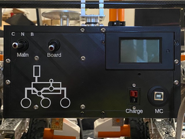

If you want flush text, then print it face down. do the lettering in
white then change to black for the rest of the lid. Probably two g-code
files, keep the heated bed on between filament change. one layer may be
enough.

The solution might be to decide how flush is “flush enough.” One or
two millimeters might get it, but I don’t know the application that
Terry is working on.
Another option might be to print black on top of white. Use a white
base layer and then a millimeter or two of black on top. (However many
layers you need to get good coverage.) The letters would cut out of
the black to allow the white to show through. You could then either
leave it alone or use a clear filler if having it flush was a
requirement. I’m guessing a clear filler would be less troublesome
than white.

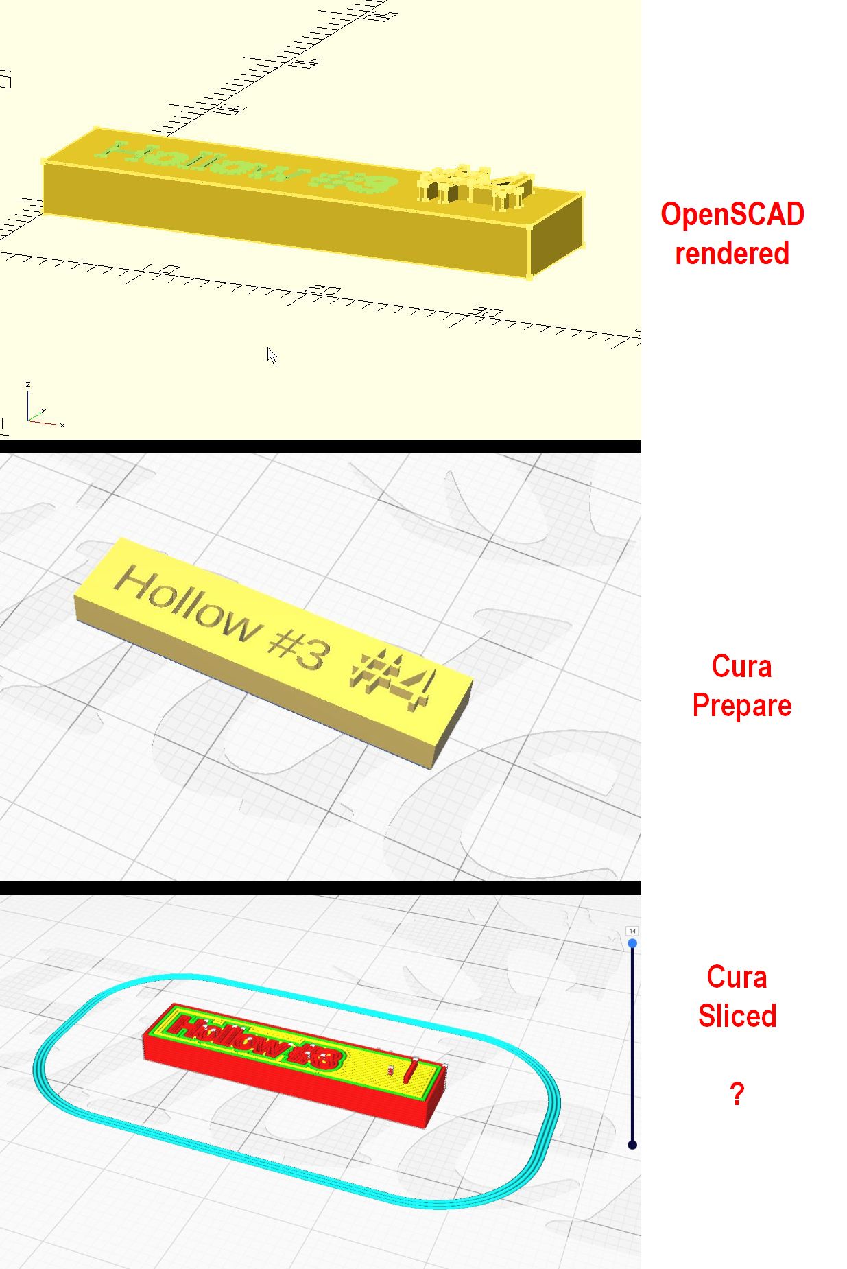

     On Fri, Nov 26, 2021 at 12:06 PM Terry
     <terrypingm@gmail.com> wrote:
         This is largely a '3D printing' post, but hope I'm not
         too far OT.
         I've not yet made a print including text with my Ender 3
         V2. But I'll soon need
         to do so and would appreciate some advice on a few
         practical points from more
         experienced users please.
         The 10 text labels will be on the top surface of a
         rectangular box lid, which
         has dimensions of 175 x 95 x 3 mm. Maybe a bit thicker
         if necessary. The labels
         (like On/Off, Up, Down, etc) will be near holes made for
         various buttons and
         switches. Each label will therefore be fairly small. I
         want them to appear flush
         with the surface, white on my black PLA filament.
         One option might be to fill with something like 'Hard As
         Nails' glue/filler,
         wiping the surface clean before leaving the filler to set.
         But ideally I'd like to do it by stopping the printer
         just once, changing to
         white filament, and resuming (something else I've not
         yet tried). If I go that
         route, what changes do I have to make in OpenSCAD and/or
         Cura, so that the stop
         occurs at exactly the right place?
         Would another idea be to make each label say 1 or 2 mm
         high and push them into
         place? On reflection I suppose they could be printed as
         one object joined by a
         thin, easily removed line?
         All suggestions/tips/advice will be much appreciated.
         Terry
If you want flush text, then print it face down. do the lettering in white then change to black for the rest of the lid. Probably two g-code files, keep the heated bed on between filament change. one layer may be enough. On 26/11/2021 19:38, David Schooley wrote: > The solution might be to decide how flush is “flush enough.” One or > two millimeters might get it, but I don’t know the application that > Terry is working on. > > Another option might be to print black on top of white. Use a white > base layer and then a millimeter or two of black on top. (However many > layers you need to get good coverage.) The letters would cut out of > the black to allow the white to show through. You could then either > leave it alone or use a clear filler if having it flush was a > requirement. I’m guessing a clear filler would be less troublesome > than white. > >> On Nov 26, 2021, at 1:11 PM, Leonard Martin Struttmann >> <lenstruttmann@gmail.com> wrote: >> >> David, No, my method would not. I guess I misread the original and >> did not get that they needed to be flush.  My mistake. >> >> On Fri, Nov 26, 2021 at 12:45 PM David Schooley >> <dcschooley@gmail.com> wrote: >> >> He wants to make the text flush. Will your method work for that? >> >>> On Nov 26, 2021, at 12:42 PM, Leonard Martin Struttmann >>> <lenstruttmann@gmail.com> wrote: >>> >>> This assumes that you extrude the text and place it just above >>> where you want it to be seen. >>> >>> I use this method for making Plant ID signs for my garden. >>> >>> >>> On Fri, Nov 26, 2021 at 12:40 PM Leonard Martin Struttmann >>> <lenstruttmann@gmail.com> wrote: >>> >>> Since you using Cura + Ender, you should be able to pause >>> the print using a Cura supplied script. >>> >>> When you are slicing, add this script: >>> >>> Extensions -> Post-processing -> Modify g-code >>> >>> Select "Add a script" and select "Filament Change". >>> >>> Change the "Layer" value to the layer where you want to >>> change the filament. >>> >>> I have used this often and works well. >>> >>> >>> >>> On Fri, Nov 26, 2021 at 12:06 PM Terry >>> <terrypingm@gmail.com> wrote: >>> >>> This is largely a '3D printing' post, but hope I'm not >>> too far OT. >>> >>> I've not yet made a print including text with my Ender 3 >>> V2. But I'll soon need >>> to do so and would appreciate some advice on a few >>> practical points from more >>> experienced users please. >>> >>> The 10 text labels will be on the top surface of a >>> rectangular box lid, which >>> has dimensions of 175 x 95 x 3 mm. Maybe a bit thicker >>> if necessary. The labels >>> (like On/Off, Up, Down, etc) will be near holes made for >>> various buttons and >>> switches. Each label will therefore be fairly small. I >>> want them to appear flush >>> with the surface, white on my black PLA filament. >>> >>> One option might be to fill with something like 'Hard As >>> Nails' glue/filler, >>> wiping the surface clean before leaving the filler to set. >>> >>> But ideally I'd like to do it by stopping the printer >>> just once, changing to >>> white filament, and resuming (something else I've not >>> yet tried). If I go that >>> route, what changes do I have to make in OpenSCAD and/or >>> Cura, so that the stop >>> occurs at exactly the right place? >>> >>> Would another idea be to make each label say 1 or 2 mm >>> high and push them into >>> place? On reflection I suppose they could be printed as >>> one object joined by a >>> thin, easily removed line? >>> >>> All suggestions/tips/advice will be much appreciated. >>> >>> Terry >>> _______________________________________________ >>> OpenSCAD mailing list >>> To unsubscribe send an email to >>> discuss-leave@lists.openscad.org >>> >>> _______________________________________________ >>> OpenSCAD mailing list >>> To unsubscribe send an email to discuss-leave@lists.openscad.org >> >> _______________________________________________ >> OpenSCAD mailing list >> To unsubscribe send an email to discuss-leave@lists.openscad.org >> >> _______________________________________________ >> OpenSCAD mailing list >> To unsubscribe send an email to discuss-leave@lists.openscad.org > > > _______________________________________________ > OpenSCAD mailing list > To unsubscribe send an email todiscuss-leave@lists.openscad.org

Yes! This video is an example: https://www.youtube.com/watch?v=KV2AjyowXX4

Thanks Ray. G-code files? As a novice I was hoping for a very simple way to: 1. Code my Surface object in OpenSCAD 2. Code my Text object 3. Union or difference 4. Add some clever code, so that after slicing in Cura the print would stop, I would change filament, taking care not to move the partial print, and resume to finish it. Over naive I guess ;-) But I’m surprised that what I’d have thought a commonplace requirement (printing text in a different colour to its background surface, with a single extruder) is not the no-brainer I’d expected. -- Terry > On 26 Nov 2021, at 22:23, Raymond West <raywest@raywest.com> wrote: > >  > If you want flush text, then print it face down. do the lettering in white then change to black for the rest of the lid. Probably two g-code files, keep the heated bed on between filament change. one layer may be enough. > > On 26/11/2021 19:38, David Schooley wrote: >> The solution might be to decide how flush is “flush enough.” One or two millimeters might get it, but I don’t know the application that Terry is working on. >> >> Another option might be to print black on top of white. Use a white base layer and then a millimeter or two of black on top. (However many layers you need to get good coverage.) The letters would cut out of the black to allow the white to show through. You could then either leave it alone or use a clear filler if having it flush was a requirement. I’m guessing a clear filler would be less troublesome than white. >> >>> On Nov 26, 2021, at 1:11 PM, Leonard Martin Struttmann <lenstruttmann@gmail.com> wrote: >>> >>> David, No, my method would not. I guess I misread the original and did not get that they needed to be flush. My mistake. >>> >>> On Fri, Nov 26, 2021 at 12:45 PM David Schooley <dcschooley@gmail.com> wrote: >>>> He wants to make the text flush. Will your method work for that? >>>> >>>>> On Nov 26, 2021, at 12:42 PM, Leonard Martin Struttmann <lenstruttmann@gmail.com> wrote: >>>>> >>>>> This assumes that you extrude the text and place it just above where you want it to be seen. >>>>> >>>>> I use this method for making Plant ID signs for my garden. >>>>> >>>>> >>>>> On Fri, Nov 26, 2021 at 12:40 PM Leonard Martin Struttmann <lenstruttmann@gmail.com> wrote: >>>>>> Since you using Cura + Ender, you should be able to pause the print using a Cura supplied script. >>>>>> >>>>>> When you are slicing, add this script: >>>>>> >>>>>> Extensions -> Post-processing -> Modify g-code >>>>>> >>>>>> Select "Add a script" and select "Filament Change". >>>>>> >>>>>> Change the "Layer" value to the layer where you want to change the filament. >>>>>> >>>>>> I have used this often and works well. >>>>>> >>>>>> >>>>>> >>>>>> On Fri, Nov 26, 2021 at 12:06 PM Terry <terrypingm@gmail.com> wrote: >>>>>>> This is largely a '3D printing' post, but hope I'm not too far OT. >>>>>>> >>>>>>> I've not yet made a print including text with my Ender 3 V2. But I'll soon need >>>>>>> to do so and would appreciate some advice on a few practical points from more >>>>>>> experienced users please. >>>>>>> >>>>>>> The 10 text labels will be on the top surface of a rectangular box lid, which >>>>>>> has dimensions of 175 x 95 x 3 mm. Maybe a bit thicker if necessary. The labels >>>>>>> (like On/Off, Up, Down, etc) will be near holes made for various buttons and >>>>>>> switches. Each label will therefore be fairly small. I want them to appear flush >>>>>>> with the surface, white on my black PLA filament. >>>>>>> >>>>>>> One option might be to fill with something like 'Hard As Nails' glue/filler, >>>>>>> wiping the surface clean before leaving the filler to set. >>>>>>> >>>>>>> But ideally I'd like to do it by stopping the printer just once, changing to >>>>>>> white filament, and resuming (something else I've not yet tried). If I go that >>>>>>> route, what changes do I have to make in OpenSCAD and/or Cura, so that the stop >>>>>>> occurs at exactly the right place? >>>>>>> >>>>>>> Would another idea be to make each label say 1 or 2 mm high and push them into >>>>>>> place? On reflection I suppose they could be printed as one object joined by a >>>>>>> thin, easily removed line? >>>>>>> >>>>>>> All suggestions/tips/advice will be much appreciated. >>>>>>> >>>>>>> Terry >>>>>>> _______________________________________________ >>>>>>> OpenSCAD mailing list >>>>>>> To unsubscribe send an email to discuss-leave@lists.openscad.org >>>>> _______________________________________________ >>>>> OpenSCAD mailing list >>>>> To unsubscribe send an email to discuss-leave@lists.openscad.org >>>> >>>> _______________________________________________ >>>> OpenSCAD mailing list >>>> To unsubscribe send an email to discuss-leave@lists.openscad.org >>> _______________________________________________ >>> OpenSCAD mailing list >>> To unsubscribe send an email to discuss-leave@lists.openscad.org >> >> >> >> _______________________________________________ >> OpenSCAD mailing list >> To unsubscribe send an email to discuss-leave@lists.openscad.org > _______________________________________________ > OpenSCAD mailing list > To unsubscribe send an email to discuss-leave@lists.openscad.org
Fri, Nov 26, 2021 11:28 PM
I have done this in the past simply by noting at what layer I need to
pause the print and manually pausing the printer, swapping filament
colors, and then resuming.  It is a little time consuming, but it works
fine.
If you use PrusaSlicer, the ability to insert a Pause is built into the
slicer:

Fri, Nov 26, 2021 11:51 PM
Here is an example where I did almost the exact thing you are talking about except that I didn’t make the text flush, but I could have. (I think I have other examples where I kept the interior color flush with the surface.) It follows your first three steps below. Letting the text protrude a bit actually makes life a bit easier for OoenSCAD. Step 4 is to bring the two stl or 3mf files into Cura, select the proper extruder for each object, and merge the objects. Given that the text isn’t exactly flush with the background this could be done with a single extruder using the techniques described earlier. I would probably be unwilling to do it that way more than once. Dual extruders are in that category of things that seem unnecessary until you have a need for them.
Sent from my iPhone

Here is an example where I did almost the exact thing you are talking about except that I didn’t make the text flush, but I could have. (I think I have other examples where I kept the interior color flush with the surface.) It follows your first three steps below. Letting the text protrude a bit actually makes life a bit easier for OoenSCAD. Step 4 is to bring the two stl or 3mf files into Cura, select the proper extruder for each object, and merge the objects. Given that the text isn’t exactly flush with the background this could be done with a single extruder using the techniques described earlier. I would probably be unwilling to do it that way more than once. Dual extruders are in that category of things that seem unnecessary until you have a need for them. Sent from my iPhone > On Nov 26, 2021, at 5:03 PM, terrypingm@gmail.com wrote: > >  > Thanks Ray. > > G-code files? As a novice I was hoping for a very simple way to: > 1. Code my Surface object in OpenSCAD > 2. Code my Text object > 3. Union or difference > 4. Add some clever code, so that after slicing in Cura the print would stop, I would change filament, taking care not to move the partial print, and resume to finish it. > > Over naive I guess ;-) > > But I’m surprised that what I’d have thought a commonplace requirement (printing text in a different colour to its background surface, with a single extruder) is not the no-brainer I’d expected. > -- > Terry > >>> On 26 Nov 2021, at 22:23, Raymond West <raywest@raywest.com> wrote: >>> >>  >> If you want flush text, then print it face down. do the lettering in white then change to black for the rest of the lid. Probably two g-code files, keep the heated bed on between filament change. one layer may be enough. >> >> On 26/11/2021 19:38, David Schooley wrote: >>> The solution might be to decide how flush is “flush enough.” One or two millimeters might get it, but I don’t know the application that Terry is working on. >>> >>> Another option might be to print black on top of white. Use a white base layer and then a millimeter or two of black on top. (However many layers you need to get good coverage.) The letters would cut out of the black to allow the white to show through. You could then either leave it alone or use a clear filler if having it flush was a requirement. I’m guessing a clear filler would be less troublesome than white. >>> >>>> On Nov 26, 2021, at 1:11 PM, Leonard Martin Struttmann <lenstruttmann@gmail.com> wrote: >>>> >>>> David, No, my method would not. I guess I misread the original and did not get that they needed to be flush. My mistake. >>>> >>>> On Fri, Nov 26, 2021 at 12:45 PM David Schooley <dcschooley@gmail.com> wrote: >>>>> He wants to make the text flush. Will your method work for that? >>>>> >>>>>> On Nov 26, 2021, at 12:42 PM, Leonard Martin Struttmann <lenstruttmann@gmail.com> wrote: >>>>>> >>>>>> This assumes that you extrude the text and place it just above where you want it to be seen. >>>>>> >>>>>> I use this method for making Plant ID signs for my garden. >>>>>> >>>>>> >>>>>> On Fri, Nov 26, 2021 at 12:40 PM Leonard Martin Struttmann <lenstruttmann@gmail.com> wrote: >>>>>>> Since you using Cura + Ender, you should be able to pause the print using a Cura supplied script. >>>>>>> >>>>>>> When you are slicing, add this script: >>>>>>> >>>>>>> Extensions -> Post-processing -> Modify g-code >>>>>>> >>>>>>> Select "Add a script" and select "Filament Change". >>>>>>> >>>>>>> Change the "Layer" value to the layer where you want to change the filament. >>>>>>> >>>>>>> I have used this often and works well. >>>>>>> >>>>>>> >>>>>>> >>>>>>> On Fri, Nov 26, 2021 at 12:06 PM Terry <terrypingm@gmail.com> wrote: >>>>>>>> This is largely a '3D printing' post, but hope I'm not too far OT. >>>>>>>> >>>>>>>> I've not yet made a print including text with my Ender 3 V2. But I'll soon need >>>>>>>> to do so and would appreciate some advice on a few practical points from more >>>>>>>> experienced users please. >>>>>>>> >>>>>>>> The 10 text labels will be on the top surface of a rectangular box lid, which >>>>>>>> has dimensions of 175 x 95 x 3 mm. Maybe a bit thicker if necessary. The labels >>>>>>>> (like On/Off, Up, Down, etc) will be near holes made for various buttons and >>>>>>>> switches. Each label will therefore be fairly small. I want them to appear flush >>>>>>>> with the surface, white on my black PLA filament. >>>>>>>> >>>>>>>> One option might be to fill with something like 'Hard As Nails' glue/filler, >>>>>>>> wiping the surface clean before leaving the filler to set. >>>>>>>> >>>>>>>> But ideally I'd like to do it by stopping the printer just once, changing to >>>>>>>> white filament, and resuming (something else I've not yet tried). If I go that >>>>>>>> route, what changes do I have to make in OpenSCAD and/or Cura, so that the stop >>>>>>>> occurs at exactly the right place? >>>>>>>> >>>>>>>> Would another idea be to make each label say 1 or 2 mm high and push them into >>>>>>>> place? On reflection I suppose they could be printed as one object joined by a >>>>>>>> thin, easily removed line? >>>>>>>> >>>>>>>> All suggestions/tips/advice will be much appreciated. >>>>>>>> >>>>>>>> Terry >>>>>>>> _______________________________________________ >>>>>>>> OpenSCAD mailing list >>>>>>>> To unsubscribe send an email to discuss-leave@lists.openscad.org >>>>>> _______________________________________________ >>>>>> OpenSCAD mailing list >>>>>> To unsubscribe send an email to discuss-leave@lists.openscad.org >>>>> >>>>> _______________________________________________ >>>>> OpenSCAD mailing list >>>>> To unsubscribe send an email to discuss-leave@lists.openscad.org >>>> _______________________________________________ >>>> OpenSCAD mailing list >>>> To unsubscribe send an email to discuss-leave@lists.openscad.org >>> >>> >>> >>> _______________________________________________ >>> OpenSCAD mailing list >>> To unsubscribe send an email to discuss-leave@lists.openscad.org >> _______________________________________________ >> OpenSCAD mailing list >> To unsubscribe send an email to discuss-leave@lists.openscad.org > _______________________________________________ > OpenSCAD mailing list > To unsubscribe send an email to discuss-leave@lists.openscad.org

Thanks for all the help so far, much appreciated and will keep my busy for
some time.
Meanwhile, where am I going wrong with this first very simple (!) test
please. I just wanted to print a small rectangle containing two pieces of
text to:
  1. Give me a feel for font size
  2. Let me try filling some taped hollow text
  3. See what 1 mm high embossed text looks & feels like, prior to trying
    that with white PLA..
But Cura shows that it will at best fail to print the latter, and I can't
spot why?
[image: MissingText.jpg]
translate([0, 8, 0])
cube([30, 7, 3]);
translate([2, 10, -0.5])
color("navy")
linear_extrude(5)
text("Hollow #3 ", 3);
translate([22, 10, 1])
color("lime")
linear_extrude(3)
text("#4", 4);
