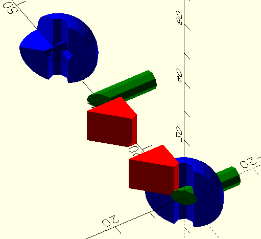

O, so the color parametr for themdissapearsn 24/12/2025 01:02, Jordan
Brown via Discuss wrote:
Today's OpenSCAD color processing does face coloring.  It is perfectly
possible to have the six faces of a cube have six different colors,
and if you union two shapes of different colors there's nothing known
about the color of the overlap area.
That scheme is fine, more or less, for visualization, but it doesn't
work well for actual 3D printing where you need to know what color (or
material) the interior of a shape is to be.
What you need is volumetric color, so that there are no overlapping
shapes and you always know what color the interior of a shape is.
I mentioned this need as part of a discussion of color semantics, and
one of the responses was that we didn't know how to do volumetric
color.  I'd done an OpenSCAD demonstration of volumetric color and was
pretty sure that it was straightforward to come up with appropriate
processing, so I said I'd recreate that proof-of-concept for discussion.
And here it is.
Note:  this is not the most efficient possible implementation.  It
re-evaluates the model many times, when it really only needs to be
evaluated once.  There should probably be a few more render()s
scattered around to try to get subtrees to be cached.  But it looks
like it works.
Implementations of hull(), minkowski(), et cetera, and of the 2D
operations, left as an exercise for the reader.
Here's the result of this particular model, both in assembled form and
exploded by color:
// Volumetric color proof of concept
// Jordan Brown,openscad@jordan.maileater.net
// There are four relevant modules in this POC:
// col - replacement for color()
// uni - replacement for union()
// dif - replacement for difference()
// int - replacement for intersection()
// In this POC, the list of possible colors needs to be known in advance;
// in a built-in implementation it would either be collected during the
// evaluation phase or managed entirely dynamically.  It would be
// straightforward to build a version of this POC that would be
// driven by an external script that would first run it in a
// "list colors" mode and would then run it once for each color.
// Similarly, in this POC the model is encapsulated in a module main(),
// while in a built-in implementation the final "step through the colors"
// loop would be implied and the model could be at the top level.
// This POC steps through the colors, generating the parts for one color,
// then the next, then the next.  A built-in implementation could do
// that, or could do roughly the same operations across all colors at once.
// The model.  A couple of unions, a difference, and an intersection
// to do a cutaway so that you can see the internal colors.
module main() {
int() {
uni() {
col("green") rotate([90,0,0]) cylinder(h=30, d=5, center=true);
dif() {
uni() {
col("red") cube(10);
col("blue") sphere(10);
rotate(-45) translate([0,-20,-20]) cube([40,40,40]);

module col(c) {
union() {  // work around #6456.
// $color=undef means that we want all colors - in particular,
// for the second-and-later children of dif() and int().
if (is_undef($color) || c == $color) {
// Union the children.
// What this does is to draw the first child, then draw the second child
// less the first child, then the third less the first and second, and
// so on.  Note that the negative components have $color=undef so that
// the entire subassembly, of all colors, gets subtracted out.
module uni() {
for (i=[0:1:$children-1]) {
// Add this child, less the children before it.  Note that
// because of col() processing this might be only part
// of the logical subtree, but that's OK; what's important
// is that we mask it all colors of the previous children.
children(i);
children([0:1:i-1], $color=undef);
// Difference the children.
// The only novel thing that this does is to set $color=undef
// for the second-and-later children, so that all colors are
// subtracted away from the first child.  Again, because of
// col() processing the first child might only be a fraction of
// the logical subtree; it'll all get reassembled in the final
// multiple passes.
module dif() {
children(0);
children([1:$children-1], $color=undef);
// Intersect the children.
// Think of this as taking the first child, and subtracting
// parts of it that are not in common with the later children.
// That neatly answers the question of what color the result
// should be, and makes everything consistent:  the first child's
// color wins.
module int() {
intersection_for(i=[0:1:$children-1]) {
if (i == 0) {
children(i);
} else {
$color = undef;
children(i);
// As noted above, this list of colors needs to be
// known in advance; in a built-in implementation (or even
// in a script-driven userspace implementation) this list
// would be dynamically derived.
colors = [ "red", "green", "blue" ];
// Build the model.
for (c = colors) {
$color=c;
color(c) render() main();
// Build an exploded set so that you can see
// what the individual colored parts look like.
for (i = [ 0:len(colors)-1 ]) {
c = colors[i];
$color=c;
translate([20+i*20,0,0]) color(c) render() main();

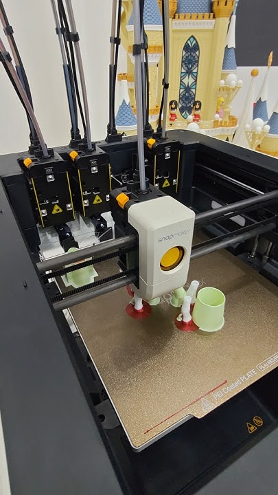

The amount of time needed to withdraw the current color, and refeed a different one, purge until, just to color a traffic light lens seems to be a huge time killer, one that would be a wasted time multiplier to me.
Recently, tool changing printers like the Snapmaker U1 are emerging that mitigate a lot of that.
oardefault.jpg🤯 The Snapmaker U1 Changes Tools 👌
youtube.com
-Revar
