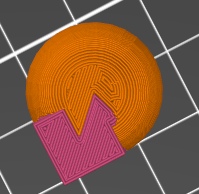

Hmm.  Do slicers really support "painting" the model?  I know it looks
like that from the UI, but what does it really mean depth-wise?  If you
have a cube, and paint it all blue, what does that mean for the
interior?  My assumption had always been that the paint-like UI  was
only an approximation, and that really it was going to take that paint
and apply it throughout the model, until it ran into some other paint.
Do they really support the concept of "just change the outermost little
bit of this shape, but leave the interior alone"?
A quick experiment later... PrusaSlicer's "multimaterial painting"
feature does indeed paint the interior.  I created a cube(10);
sphere(10); and painted the cube.  The resulting slice carries the
cube's color throughout the cube, though the exact boundary is ...
strange. Here's pictures taken at a couple of different layers.
Still, that does seem like a plausible feature so that's an argument for
supporting it.

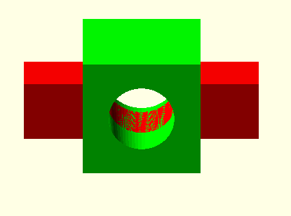

I mentioned earlier, the complexity of mixing 2d with 3d, which openscad
tries to do. If the surface is treated as a thin solid, then everything
is solved by dealing with colour of a solid. That applies to 3d
printing, and even a painted surface.
If you want a pattern on the surface, then that is merely individual
extruded solid tris, but too many to think about.
For objects with solid colours, they can exist and retain their
individual colours, unless unioned. You need rules for booleans and
colour. but, you can leave the result of boolean colours as neutral, and
assign a colour to the final object, if required. You cannot add
colours, not usually in practice, since more than two or three unions
will usually end up as a brown mess.
If you generate the rules, and adhere to them, anything else can adapt
to them. When rules are inconsistent, that is where the problems occur.
Consider normal? fdm printing in plastic. Most slicers allow painting of
colours onto the object, since the earlier slicers had to do something
with stl files. obj files can have an axillary colour file, but I've
never seen that used, and ply files have colour built in, but orca and
many slicers do not import that. 3mf has a colour extension, but bbl
does not always conform. It seems that slicers do their own thing wrt
colour for the current crop of multicolour fdm printers. Resin and other
printers, probably no colour involved. My opinion, is that trying to put
colour into an object, and hoping that all slicers will interpret it, is
a bit pointless, unless the user can't change it in the slicer, which
they all can. You may as well not let the user scale or rotate the
object. (If you are running a print farm, then you may want one file
that isn't modified, but that will be the gcode/sliced file unless you
have different printer types, and if it is a business, you need to pay
for your cad!).
The other aspect that crops up is the use of colour to signify the type
of line, in laser cutting, say. In most cases, a colour fill will do the
same job in 2d, as a solid colour in 3d. since openscad does not have an
effective gui interface, it is probably not the best 2d drawing package
to use.
This sort of reminds me of the 1960's when diy and black and decker
drills became popular. Folk, not knowing much about power/bearings etc.,
began  attaching grinding discs, circular saws and the like to the
drills, which then began to disassemble. The solution was to develop a
range of tools to do specific jobs.
The image, the red and green cubes placed overlapping, not unioned, and
tapered hole differenced. Since the part in the middle is both red and
green, you get some 'fighting', which to my mind is exactly as it should
be. If it is unioned, then it is one object, so the colour is grey,
unless assigned to whatever.

Hmm.  Do slicers really support "painting" the model?  ...

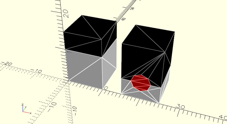

Instead, with face coloring (but we should specify what to do with
coincident faces with different colors... I don't think that came up
in our color spec conversation), I should be able to:
Theoretically, I think the answer should be the same as for volumes,
which means either first-wins or last-wins, and for me that coin came
down on first-wins.
Sadly, it does not do that. I'm, uh, not sure exactly this is. F6 w/
Manifold (duh, because color).
union() { color("white") cube(10);
translate([0,0,5]) color("black") cube(10);
translate([15,0,0]) union() {
translate([5,0,5]) rotate([-90,0,0]) color("red") cylinder(d=5,h=10);
