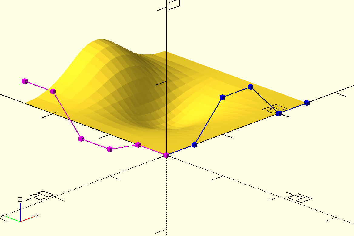

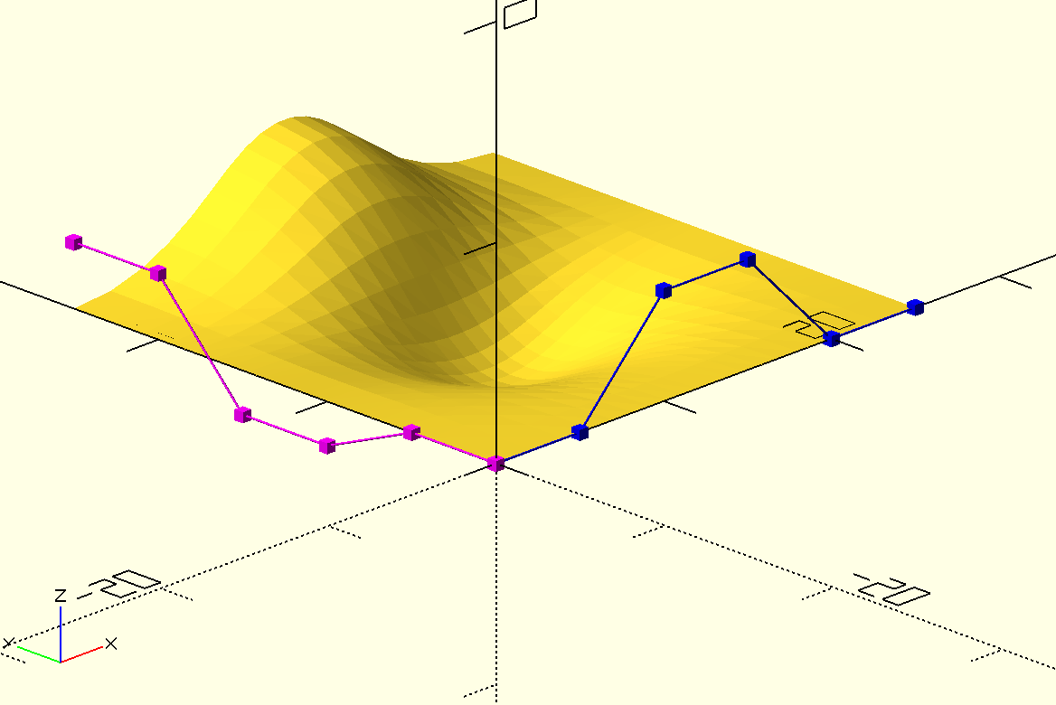

On Aug 10, 2024, at 9:03 PM, William F. Adams via Discuss discuss@lists.openscad.org wrote:
On Saturday, August 10, 2024 at 11:14:40 PM EDT, Sanjeev Prabhakar via Discuss discuss@lists.openscad.org wrote:
I have written a function to compute bspline curves purely in openscad.
This could be useful many here
Flat out amazing!
Is there a mechanism for interpolating between multiple such curves so as to create a surface?
A couple years ago I wrote some B-Spline code that we were considering for inclusion into BOSL2.  It had some code fiddling around with making B-spline surface patches:

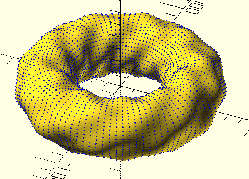

Blue dots are patch control points:
  • Revar
> On Aug 10, 2024, at 9:03 PM, William F. Adams via Discuss <discuss@lists.openscad.org> wrote: > > On Saturday, August 10, 2024 at 11:14:40 PM EDT, Sanjeev Prabhakar via Discuss <discuss@lists.openscad.org> wrote: > >> I have written a function to compute bspline curves purely in openscad. >> This could be useful many here > > Flat out _amazing_! > > Is there a mechanism for interpolating between multiple such curves so as to create a surface? > A couple years ago I wrote some B-Spline code that we were considering for inclusion into BOSL2. It had some code fiddling around with making B-spline surface patches: include <BOSL2/std.scad> function bspline(path, closed=false, splinesteps=8) = assert(is_path(path) && len(path)>3) assert(is_finite(splinesteps)) assert(floor(ln(splinesteps)/ln(2)) == (ln(splinesteps)/ln(2)), "splinesteps must be an integer power of 2.") let( lev = max(0, ceil(ln(splinesteps) / ln(2)) ), path = closed? path : concat([path[0]], path, [last(path)]) ) _bspline_recurse(path, closed=closed, lev=lev); function _bspline_recurse(path, closed=false, lev) = lev == 0 ? path : let( endknots = [ [1.0, 0.0, 0.0, 0.0], [0.5, 0.5, 0.0, 0.0], [0.0, 0.75, 0.25, 0.0], [0.0, 0.1875, 0.6875, 0.125], ], midknots = [ [0.5, 0.5, 0.0 ], [0.125, 0.75, 0.125], ], plen = len(path) ) closed ? _bspline_recurse([for(i=idx(path), j=[0,1]) midknots[j] * select(path,i,i+2)], closed, lev=lev-1) : _bspline_recurse( [ for(i=[0:1:min(3,plen-3)]) endknots[i] * select(path,0,3), for(i=[3:1:plen-4], j=[0,1]) midknots[j] * select(path,i-1,i+1), midknots[0] * select(path,-4,-2), for(i=[min(3,plen-2):-1:0]) endknots[i] * select(path,[-1:-1:-4]), ], closed, lev=lev-1 ); function bspline_patch(patch, splinesteps=8, col_wrap=false, row_wrap=false) = let( bswall1 = [for (i = idx(patch[0])) bspline([for (row=patch) row[i]], closed=col_wrap, splinesteps=splinesteps)], bswall2 = [for (i = idx(bswall1[0])) bspline([for (row=bswall1) row[i]], closed=row_wrap, splinesteps=splinesteps)] ) vnf_vertex_array(bswall2, col_wrap=col_wrap, row_wrap=row_wrap); rsteps = 96; csteps = 48; hreps = 10; vreps = 4; ssteps = 2; r_maj = 50; r_min = 20; patch = [ for (i = [0:1:rsteps-1]) [ for (j = [0:1:csteps-1]) let( u = i/rsteps, v = j/csteps, r_var = sin(v*360*vreps) * sin(u*360*hreps) * 2, m = zrot(u*360) * right(r_maj) * yrot(-v*360) ) apply(m, [r_min+r_var, 0, 0]) ] ]; color("blue") move_copies(flatten(patch)) sphere(0.5,$fn=8); vnf = bspline_patch(patch, splinesteps=ssteps, col_wrap=true, row_wrap=true); vnf_polyhedron(vnf); Blue dots are patch control points:  - Revar

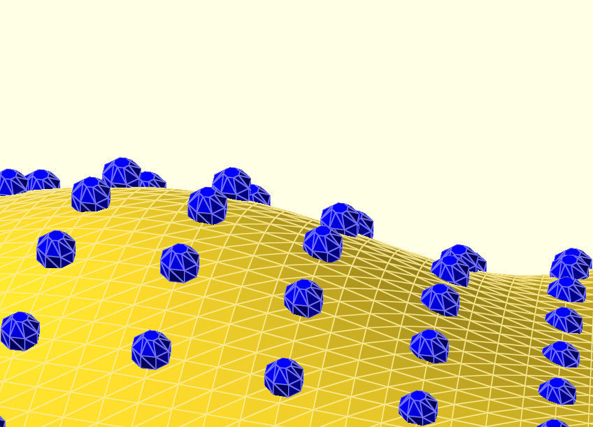

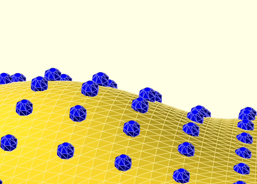

Sun, Aug 11, 2024 8:38 AM
A more detailed view of the surface:

On Aug 11, 2024, at 1:31 AM, Revar Desmera revarbat@gmail.com wrote:
<Screenshot 2024-08-11 at 1.29.21 AM.png>
  • Revar
A more detailed view of the surface:  - Revar > On Aug 11, 2024, at 1:31 AM, Revar Desmera <revarbat@gmail.com> wrote: > > > >> On Aug 10, 2024, at 9:03 PM, William F. Adams via Discuss <discuss@lists.openscad.org> wrote: >> >> On Saturday, August 10, 2024 at 11:14:40 PM EDT, Sanjeev Prabhakar via Discuss <discuss@lists.openscad.org> wrote: >> >>> I have written a function to compute bspline curves purely in openscad. >>> This could be useful many here >> >> Flat out _amazing_! >> >> Is there a mechanism for interpolating between multiple such curves so as to create a surface? >> > > A couple years ago I wrote some B-Spline code that we were considering for inclusion into BOSL2. It had some code fiddling around with making B-spline surface patches: > > include <BOSL2/std.scad> > > function bspline(path, closed=false, splinesteps=8) = > assert(is_path(path) && len(path)>3) > assert(is_finite(splinesteps)) > assert(floor(ln(splinesteps)/ln(2)) == (ln(splinesteps)/ln(2)), "splinesteps must be an integer power of 2.") > let( > lev = max(0, ceil(ln(splinesteps) / ln(2)) ), > path = closed? path : > concat([path[0]], path, [last(path)]) > ) > _bspline_recurse(path, closed=closed, lev=lev); > > function _bspline_recurse(path, closed=false, lev) = > lev == 0 ? path : > let( > endknots = [ > [1.0, 0.0, 0.0, 0.0], > [0.5, 0.5, 0.0, 0.0], > [0.0, 0.75, 0.25, 0.0], > [0.0, 0.1875, 0.6875, 0.125], > ], > midknots = [ > [0.5, 0.5, 0.0 ], > [0.125, 0.75, 0.125], > ], > plen = len(path) > ) > closed > ? _bspline_recurse([for(i=idx(path), j=[0,1]) midknots[j] * select(path,i,i+2)], closed, lev=lev-1) > : _bspline_recurse( > [ > for(i=[0:1:min(3,plen-3)]) endknots[i] * select(path,0,3), > for(i=[3:1:plen-4], j=[0,1]) midknots[j] * select(path,i-1,i+1), > midknots[0] * select(path,-4,-2), > for(i=[min(3,plen-2):-1:0]) endknots[i] * select(path,[-1:-1:-4]), > ], > closed, > lev=lev-1 > ); > > function bspline_patch(patch, splinesteps=8, col_wrap=false, row_wrap=false) = > let( > bswall1 = [for (i = idx(patch[0])) bspline([for (row=patch) row[i]], closed=col_wrap, splinesteps=splinesteps)], > bswall2 = [for (i = idx(bswall1[0])) bspline([for (row=bswall1) row[i]], closed=row_wrap, splinesteps=splinesteps)] > ) > vnf_vertex_array(bswall2, col_wrap=col_wrap, row_wrap=row_wrap); > > rsteps = 96; > csteps = 48; > hreps = 10; > vreps = 4; > ssteps = 2; > r_maj = 50; > r_min = 20; > > patch = [ > for (i = [0:1:rsteps-1]) [ > for (j = [0:1:csteps-1]) > let( > u = i/rsteps, > v = j/csteps, > r_var = sin(v*360*vreps) * sin(u*360*hreps) * 2, > m = zrot(u*360) * right(r_maj) * yrot(-v*360) > ) > apply(m, [r_min+r_var, 0, 0]) > ] > ]; > > color("blue") move_copies(flatten(patch)) sphere(0.5,$fn=8); > vnf = bspline_patch(patch, splinesteps=ssteps, col_wrap=true, row_wrap=true); > vnf_polyhedron(vnf); > > Blue dots are patch control points: > <Screenshot 2024-08-11 at 1.29.21 AM.png> > > - Revar
[image: Screenshot 2024-08-11 at 1.37.33 AM.png]
let(
lev == 0 ? path :
let(
endknots = [
midknots = [
[0.5,  0.5,  0.0  ],
plen = len(path)
closed
: _bspline_recurse(
select(path,0,3),
closed,
lev=lev-1
row_wrap=false) =
let(
rsteps = 96;
csteps = 48;
hreps = 10;
vreps = 4;
ssteps = 2;
r_maj = 50;
r_min = 20;
patch = [
let(
u = i/rsteps,
v = j/csteps,
r_var = sin(v360vreps) * sin(u360hreps) * 2,
m = zrot(u360) * right(r_maj) * yrot(-v360)
row_wrap=true);
  • Revar

I did a small test of efficiency
following surface is created using 2 lines (blue and magenta, 6 control
points each) with 2 methods
  1. converted both lines to bspline curves and created a surface by adding
    the points (time: 0.015s)
  2. by directly using the formula for bspline surface (time: 0.53s)
method 1 is around 35 times faster.
Maybe the algorithm written is not efficient, but this is a very small
surface with only 400 points overall
[image: Screenshot 2024-08-11 at 6.55.26 PM.png]

I am not sure I understand what method 1 is.  A surface could easily
require 100 points along each edge, which means 10k points in total.  I
know that for bezier surfaces run time was a concern.  It got slow with
surfaces that had a lot of points, and since the bezier calculations cannot
be cached you take that run-time hit every time you do anything with your
model, so run time performance was important.  Implementing beziers using
matrix multiplication was a 10x-20x speed improvement compared to
recursively using the de casteljau algorithm.  The problem with b-splines
is that the knots create a bunch of variability in the structure of the
shape.  I guess your implementation assumes uniformly spaced knots?
