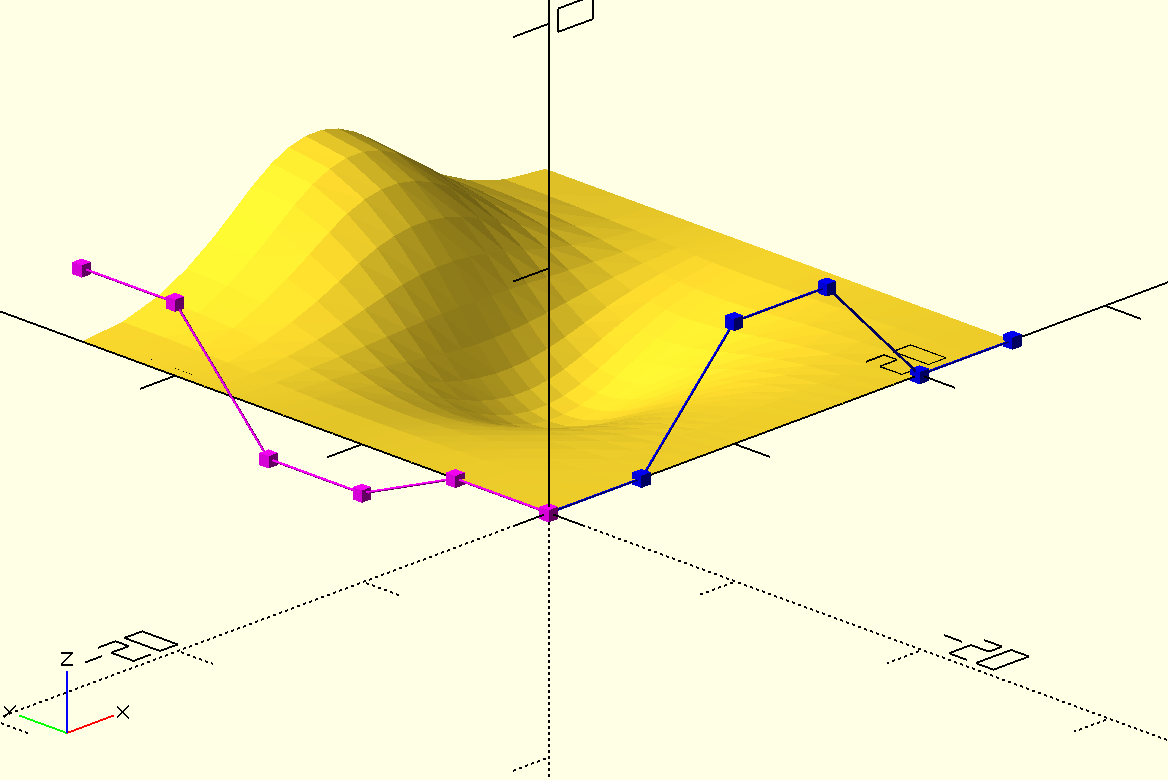

I did a small test of efficiency
following surface is created using 2 lines (blue and magenta, 6 control points each) with 2 methods
  1. converted both lines to bspline curves and created a surface by adding the points (time: 0.015s)
  2. by directly using the formula for bspline surface (time: 0.53s)
method 1 is around 35 times faster.
Maybe the algorithm written is not efficient, but this is a very small surface with only 400 points overall

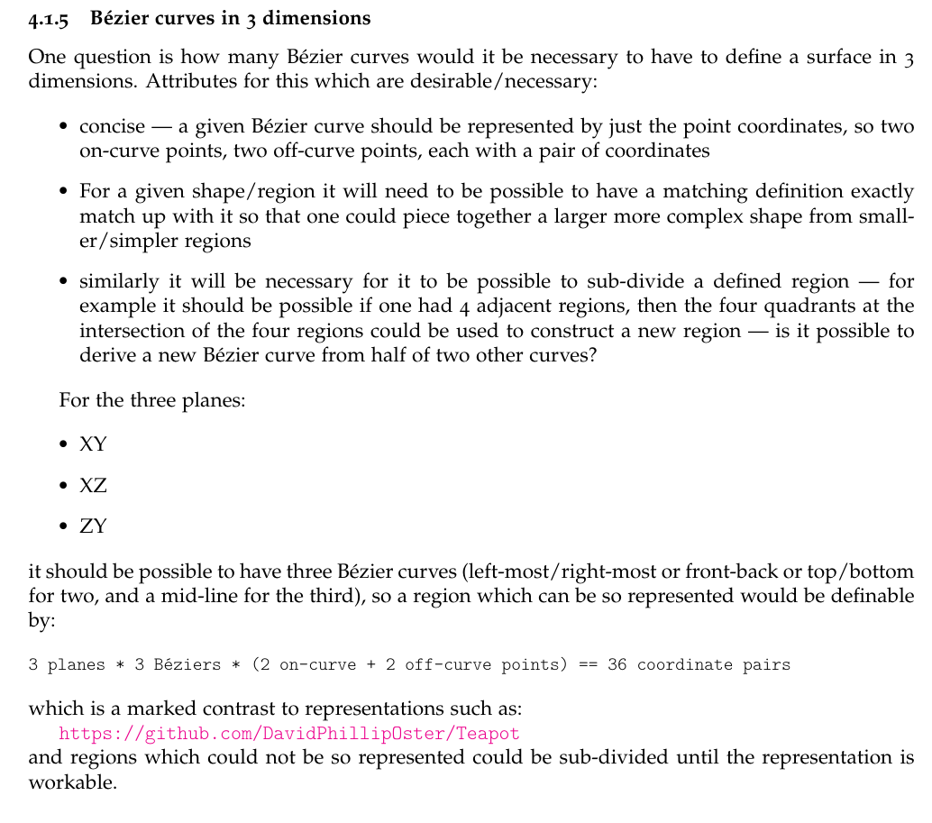

That is exactly the sort of thing I was reaching for when I wrote the below, and I thank you for validating that.
\subsubsection{Bézier curves in 3 dimensions}
One question is how many Bézier curves would it be necessary to have to define a surface
in 3 dimensions. Attributes for this which are desirable/necessary:
\begin{itemize}
\item concise --- a given Bézier curve should be represented by just the point coordinates,
so two on-curve points, two off-curve points, each with a pair of coordinates
\item For a given shape/region it will need to be possible to have a matching definition
exactly match up with it so that one could piece together a larger more complex shape
from smaller/simpler regions
\item similarly it will be necessary for it to be possible to sub-divide a defined region ---
for example it should be possible if one had 4 adjacent regions, then the four quadrants
at the intersection of the four regions could be used to construct a new region --- is it
possible to derive a new Bézier curve from half of two other curves?
\end{itemize}
\begin{samepage}
For the three planes:
\begin{itemize}
\item XY
\item XZ
\item ZY
\end{itemize}
\noindent it should be possible to have three Bézier curves (left-most/right-most or front-back or
top/bottom for two, and a mid-line for the third), so a region which can be so represented would
be definable by:
\begin{verbatim}
3 planes * 3 Béziers * (2 on-curve + 2 off-curve points) == 36 coordinate pairs
\end{verbatim}
\end{samepage}
\noindent which is a marked contrast to representations such as:
\url{https://github.com/DavidPhillipOster/Teapot}
\noindent and regions which could not be so represented could be sub-divided until the
representation is workable.

I think the basis function in bspline consumes most of the time as it
checks the condition if parameter value lies with in 2 consecutive knots
and switches 1 or 0.
In case of 2 lines method it is checked only sum of 2 bspline line points
whereas in case of surface it gets multiplied and therefore such
inefficiency

On Sun, Aug 11, 2024 at 9:35 AM Sanjeev Prabhakar <
[image: Screenshot 2024-08-11 at 6.55.26 PM.png]

What better ways than bspline exist for creating surfaces?  I had the
impression that NURBS were the tool for this out in the big world, and they
are just a slight generalization of bspline.  I'm planning and
implementation of bspline/NURBS at some point, but efficient implementation
in OpenSCAD may be difficult, compared to beziers, which can be done very
fast as a matrix multiply.
