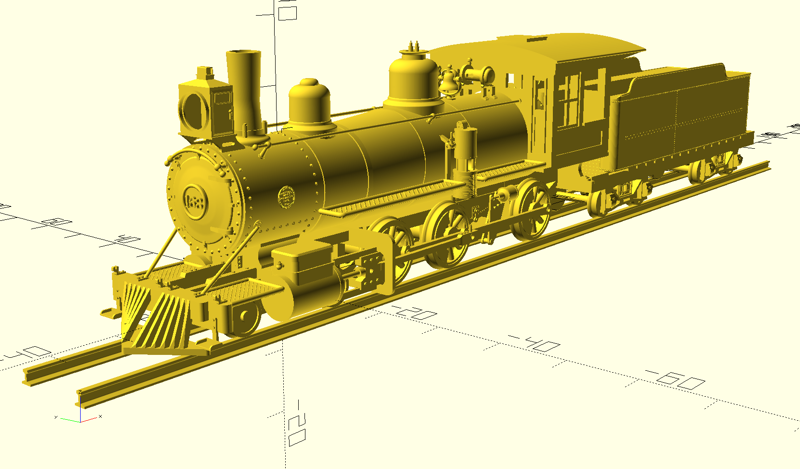

Indeed.  For 3d printing of scale model parts, all I care about is that
at a given point in a layer, at least one object renders a "1" pixel.
With that thinking, I defined and translated enough cubes, cylinders,
and extruded polygons to model this:

Mon, Oct 30, 2023 1:04 AM
Wow
Wonderful work, especially if it is all done in openscad
Wow Wonderful work, especially if it is all done in openscad

Master Class work on that train model!
  • Revar

Mon, Oct 30, 2023 1:51 AM
Every bit of it is OpenSCAD.  I've posted all of it to a Github repo
with a Creative Commons license:
https://github.com/butcherg/DRG_168
Made a lot of it with extrusions of polygons rounded with the
Round-Anything polyround() module.
From an engineering standpoint, OpenSCAD is an excellent environment
for such.  The design is clearly communicated in the scripts; the only
thing I wish I could do would be to generate drawings from the model.
To be noted is that this is a scale model, not a CAD representation of
the real article.  Many, many abstractions and compromises in order to
print a model that's only about six inches long.  Some scale dimensions
are up to twice that of the corresponding prototype, in order to
accommodate the resin printing medium.  For example, I kept losing the
handrail stanchions in the alcohol wash, kept increasing the dimensions
until they survived...

Mon, Oct 30, 2023 1:58 AM
Nah, a fair bit of hack code.  Particularly nasty is an unholy amalgam
of polyround() and a path_extrude() routine I found on Thingiverse to
make the bell hangar.
I started this about a year ago, no previous experience with CAD or 3d
printing. I just wanted to build a model of the locomotive, OpenSCAD
appealed to the programmer I am, so I just started beating it until it
puked a locomotive...  :D
