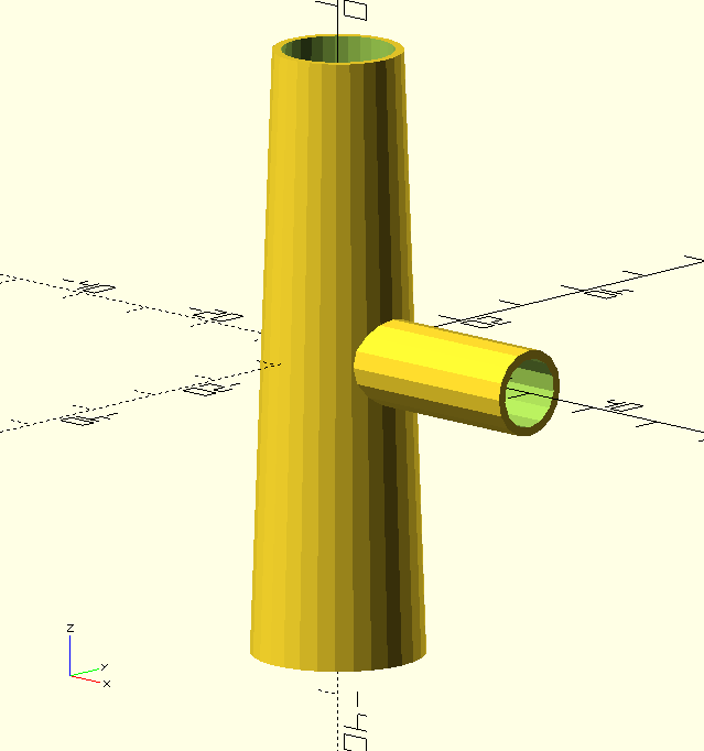

On 8/16/2023 12:22 PM, Sanjeev Prabhakar wrote:
openscad version
[image: Screenshot 2023-08-16 at 9.44.44 PM.png]
#python code to create this:
from openscad1 import *
sec=circle(25)
path=cr(pts1([[0,0,0],[0,15,1],[-6,50,1],[0,18,0]]),10)
sol=prism(sec,path)
sol1=prism(circle(24),path)
sol0=swp_prism_h(sol,sol1)
sec2=circle(15)
path2=cr_3d([[0,0,15,0],[-60,0,40,20],[0,0,30,0]],10)
sol2=path_extrude_open(sec2,path2)
sol3=path_extrude_open(offset(sec2,-1),path2)
sol02=swp_prism_h(sol2,sol3)
fillet1=ip_fillet(sol,sol2,3,3)
sec3=cr(pts1([[0,0],[-2,1,.2],[2,1]]),10)
path3=helix(14,2.5,6,5)
sol4=path_extrude_open(sec3,path3)
sol4=sol2vector([0,0,1,],sol4,[-60,0,70])
with open('/Users/sanjeevprabhakar/iCloud Drive
(Archive)/Documents/Download/openscad/trial.scad','w+') as f:
f.write(f'''
difference(){{
{swp_c(sol0)}
{swp(sol3)}
difference(){{
{swp_c(sol02)}
{swp(sol)}
{swp_c(fillet1)}
intersection(){{
color("blue"){swp(sol4)}
{swp(sol3)}

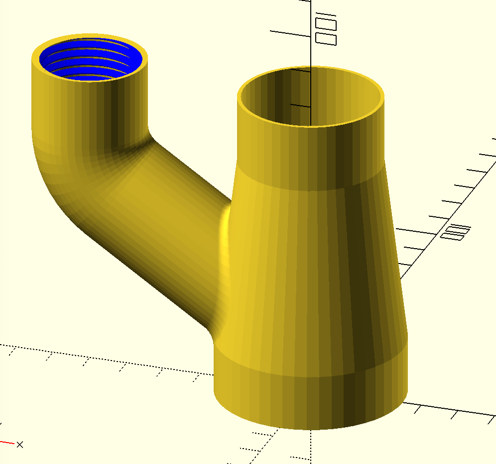

Dear all
I found the enclosed adapter on Thingiverse. Unfortunately nearly all
diameters are not in that size I need it. Did anyone of you created
such
an (similar) object in Openscad? Is it possible to get that file?
Or- if not- how would an expert start with that projects?
Until now I only use Openscad functions and some of the BOSL libraries.
Many thanks in advance
Karl

Hi Karl,
[cylindrical Y-adapter with different diameters on each side, one of the cylinders has an inner thread]
Has your problem been solved?
If not:
(1) Do you require the inner thread of the smaller exhaust cylinder?
(2) is the angle between the two small exhaust cylinders important?
I think the model can be simplified to four cylinders - two outer cylinders add up to the y-shape, two inner cylinders to make it hollow. As a proof of concept, I have attached a sample code and a render image.
Cheers,
Marcus
