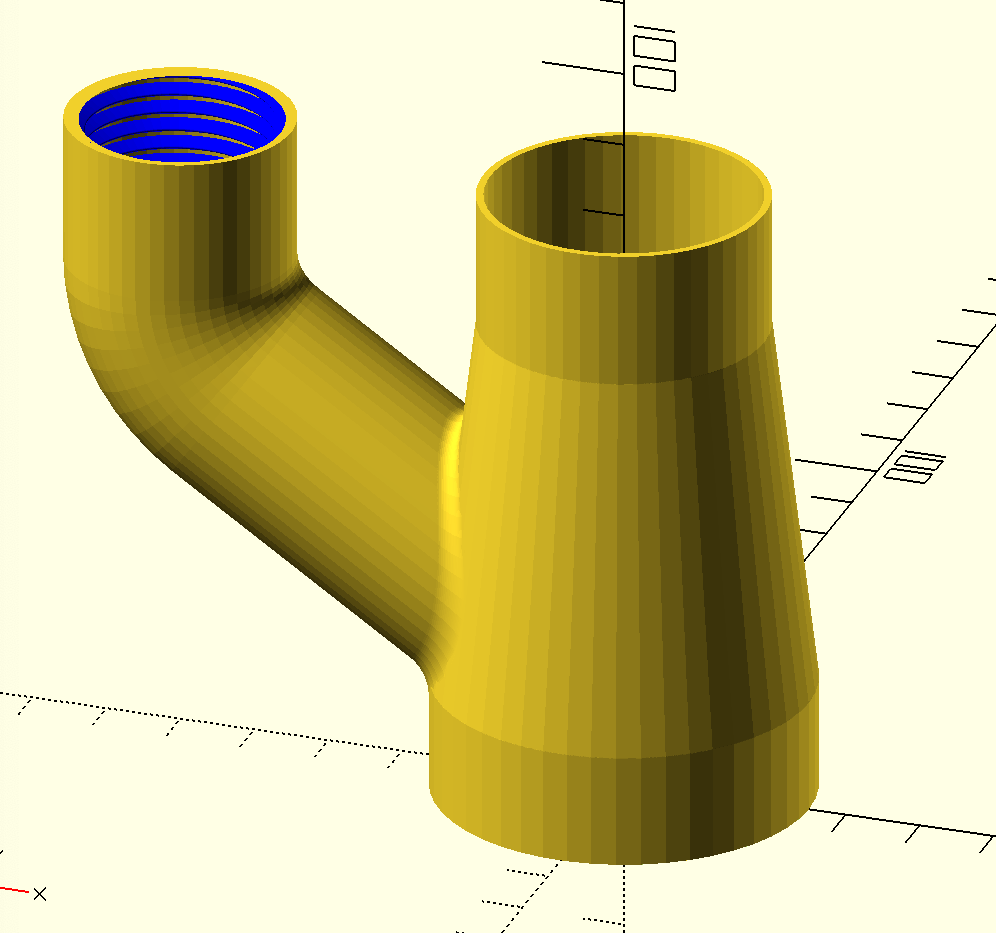

Dear all
I found the enclosed adapter on Thingiverse. Unfortunately nearly all
diameters are not in that size I need it. Did anyone of you created such
an (similar) object in Openscad? Is it possible to get that file?
Or- if not- how would an expert start with that projects?
Until now I only use Openscad functions and some of the BOSL libraries.
Many thanks in advance
Karl

This seems to me as quite a simple case although haven't tried it yet.
As per my understanding it should be easy to do with BOSL library. May be
Adrian can comment.
If you want,  I can make it through my python approach.
It is mainly 2 tubes which needs to be fused together and some easy
filleting.
Threads parts maybe a little tricky, but not too difficult for sure.

I would split it up at least 4 or 5 cilinders, bottom and top straight,
middle  with different r1 and r2, and two cilnders for the left side.
The top with a tread inside from BOSSL or another treads library.
Should be do-able in openscad without the need for python.

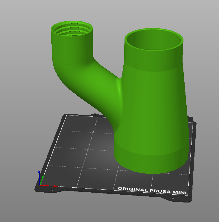

openscad version
[image: Screenshot 2023-08-16 at 9.44.44 PM.png]
#python code to create this:
from openscad1 import *
sec=circle(25)
path=cr(pts1([[0,0,0],[0,15,1],[-6,50,1],[0,18,0]]),10)
sol=prism(sec,path)
sol1=prism(circle(24),path)
sol0=swp_prism_h(sol,sol1)
sec2=circle(15)
path2=cr_3d([[0,0,15,0],[-60,0,40,20],[0,0,30,0]],10)
sol2=path_extrude_open(sec2,path2)
sol3=path_extrude_open(offset(sec2,-1),path2)
sol02=swp_prism_h(sol2,sol3)
fillet1=ip_fillet(sol,sol2,3,3)
sec3=cr(pts1([[0,0],[-2,1,.2],[2,1]]),10)
path3=helix(14,2.5,6,5)
sol4=path_extrude_open(sec3,path3)
sol4=sol2vector([0,0,1,],sol4,[-60,0,70])
with open('/Users/sanjeevprabhakar/iCloud Drive
(Archive)/Documents/Download/openscad/trial.scad','w+') as f:
f.write(f'''
difference(){{
{swp_c(sol0)}
{swp(sol3)}
difference(){{
{swp_c(sol02)}
{swp(sol)}
{swp_c(fillet1)}
intersection(){{
color("blue"){swp(sol4)}
{swp(sol3)}
#for this code to work you would need  file openscad1.py
f.write(f'''
difference(){{
{swp_c(sol0)}
{swp(sol3)}
difference(){{
{swp_c(sol02)}
{swp(sol)}
{swp_c(fillet1)}
intersection(){{
{swp(sol3)}

 openscad version
 sec=circle(25)
 sol=prism(sec,path)
 sec2=circle(15)
     f.write(f'''
 difference(){{
 {swp_c(sol0)}
 {swp(sol3)}
 difference(){{
 {swp_c(sol02)}
 {swp(sol)}
 {swp_c(fillet1)}
 intersection(){{
 {swp(sol3)}

openscad version
sec=circle(25)
sol=prism(sec,path)
sec2=circle(15)
f.write(f'''
difference(){{
{swp_c(sol0)}
{swp(sol3)}
difference(){{
{swp_c(sol02)}
{swp(sol)}
{swp_c(fillet1)}
intersection(){{
{swp(sol3)}
