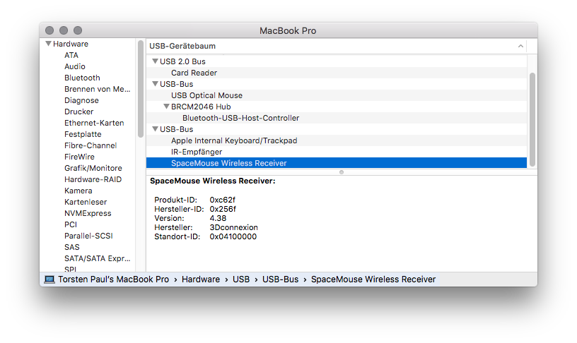

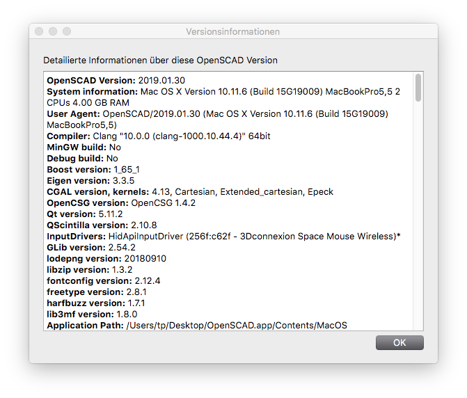

I'd be delighted to help test and document this. So far, I've installed the
2019.1.30 snapshot build. In the Axis preferences pane, there are five
items under "Driver selection." Three are grayed out: SpaceNav, Joystick,
and DBus. The other two, HIDAPI and QGamepad, have no effect when selected.
I tried enabling "input-driver-dbus" on the features pane (and restarted),
but it did not enable DBus on the Axis pane nor have any other noticeable
effect.
Michael Frey suggested that inputdriver "should now be part of the
development snapshots of all operating systems" but I haven't found any
evidence of this in my installation.
I've installed the software/drivers that came with my 3Dconnexion
SpaceMouse, so I know the hardware works. But I haven't been able to get
OpenSCAD to respond to it in any way.
Apart from the above, I don't know what else to try. Anyone have any
suggestions?

For a spacemouse, you should active HIDAPI, stop the 3Dconnexion driver
and restart OpenSCAD.
At least this is how it works under Windows.
The HIDAPI driver directly talks to the SpaceMouse.
If the original driver is also running, the original driver blocks
OpenSCADs low level driver.
To be clear: OpenSCAD is not using an official 3Dconnexion protocol or
driver. OpenSCAD has its own driver and directly talks to the 3D-Mice.
Having the official driver running prevents that.

Wed, Feb 20, 2019 10:50 PM
I just tried with the latest snapshot version on my old MacBook
and the only change required was to enable the "HIDAPI" driver.
Could you please show the USB information of the device? Attached
image shows the info from my SpaceMouse Wireless with the dongle
connected.
It seems there are different receivers and we have some trouble
with the "Universal Receiver"
With the driver enabled and a device detected, it should show
up like in the Help->Library Info screenshot in the InputDriver
section.
