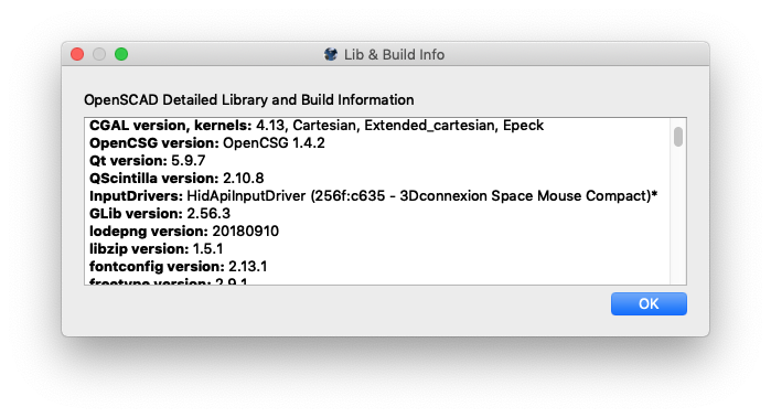

Thanks for your help Torsten!  So I uninstalled the 3DConnexion software and rebooted. The spacemouse is now apparently being treated as a normal mouse everywhere, including OpenSCAD: twist zooms, other gestures pan. In other words, it's not working.
In Lib & Build Info, I see "InputDrivers: HidApiInputDriver" (image attached)
So are you saying that all I should need is the latest snapshot (I have 2019.2.20) and the HIDAPI option enabled? Am I missing something?

Hi Torsten,
In OpenSCAD's Library Info, it does not identify my hardware like it does on yours. And in the Hardware pane of About This Mac, the entry for my spacemouse is similar to yours, but the product ID is different. I have the Spacemouse Compact, not the wireless. Could that be the problem?

Yes, we did not have that device yet. I've added it to the list
hoping it will use the same data as the other devices.
We'll need to check with a new snapshot if it works now. If not,
I have to get the debug stuff in shape for official inclusion
so we can track what's going on...

DA
D. A. Karp
Sun, Feb 24, 2019 12:02 AM
Thanks, Marius. Just tried 2019.02.23 - it now recognizes the Spacemouse (see screenshot) but I get no response whatsoever when I move the mouse. Anything else I can try?
Aww, that means it's sending data different from the other known
devices.
I'll get the tracing code into shape for actually shipping it, so
far it was only meant for some special testing...
So please hold on for a bit, there should be a version shortly that
(hopefully) dumps the info about the device into a file so we can
see how to support this device.
