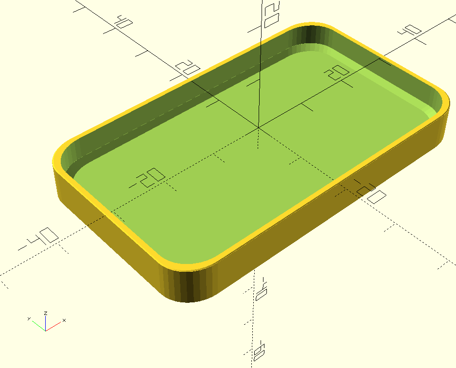

Hello ,
I would like to soften the top inner and outer edges on this figure.  I don't need much.  I just wanted to get rid of the edge.
Thank you
Bob Roos
include <BOSL2/std.scad> //or screws or threading
Wo=34;
Lo=60;
Wi=23;
Li=34;
H=10;
Ro = 8;
Ri = 3;
T=1.4;
Off = 2.0;
union(){
rect_tube(size=[Wo,Lo], wall=(Wo-Wi)/2, rounding=Ro, h=H,irounding=3);
rect_tube(size=[Wo,Lo-(Wo-Wi)/2], wall=(Wo-Wi)/2, rounding=Ro, h=H,irounding=3);
rect_tube(size=[Wo-T,Lo-T], wall=(Wo-Wi)/2-T,h=H-T,irounding=3, rounding=Ro);
#rect_tube(size=[Wo-T2,Lo-T2], wall=(Wo-Wi)/2-T,h=Off,irounding=3, rounding=Ro);
up(Off/2)cuboid([Wo-6T,Lo-6T,Off]);

Hi Bob,
[Aproximation in words] Looks like a stencil for cookies. The cut cookie would look like a picture frame with rounded corners.
Let's discuss your options before choosing either:
(1) The general approach to softening 3d shapes is
minkowski()
and it is veeery calculation intense, especially for generic cases (substract, minkowski, substract, minkowski).
https://en.wikibooks.org/wiki/OpenSCAD_User_Manual/Transformations#minkowski
The not so generic case for your model would be:
(1a) scad the cut-out
(1b) minkowski the cut-out
(1c) scad the outer shape
(1d) minkowski the outer shape
(1e) cut-out the inner shape from the outer shape.
(2) There is a 2d-projection that makes up your shape. Model this in 2d using
  ____
 / __ \
\_/  \_/
Is my understanding ouf your desired shape correct?
You could use this 2D-shape and linear_extrude and rotate_extrude to create a 3D-rectangle.
Does any of the approaches suit you?

You can do that using the offset_sweep() module in BOSL2.  You would need
to replace the rect_tube()'s with differences of offset_sweep() applied to
rect().

Yeah, it seems unlikely there's any way to simultaneously use BOSL2 and
constructive-compiled.
Another strategy for making this in BOSL2 would be to make a U-shaped
2d-path and path extrude it along a rounded rect().

here is a take on it using only constructive lib skin funtionality ( i
like your extrusion approach too)
include <../devlibs/constructive/constructive-all.scad>
Wo=34; Lo=60; Wi=23; Li=34; H=5; Ro = 8; Ri = 3; T=1.4;Off = 2.0;
$skinThick =1.4;
assemble() {
    addRemove(Z(margin(.1)),TODOWN(),height(skin(H)))
            chamfer(down=-1,up=-.15,side=-Ro,fnCorner=40)
                box(skin(Wo),skin(Lo));
i am not quite sure what bobs code was supposed to look like, so this is

On 30.11.23 12:48, Guenther Sohler via Discuss wrote:
Yet another strategy would be to use build123d (cadquery) inside openscad
With OpenCascade you can even create  filltets AFTER the object was
already defined.
This allows for more sophisticated designs and less strategy how to
describe objects correctly ...
https://imgur.com/a/KdZmaxG
On Thu, Nov 30, 2023 at 12:43 PM Adrian Mariano via Discuss <
On Thu, Nov 30, 2023 at 6:26 AM Marcus Poller via Discuss <
Hi Peter,
include <constructive-compiled.scad>
chamfer(4,-2) tube(d=10,h=20,wall=2.5);
