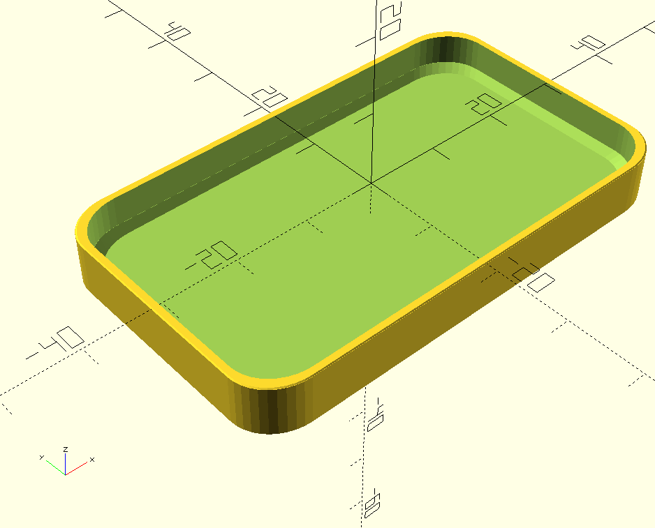

thiscode does prettymuch the same as code below, but might be easier to
understand, by just looking at it:
include <constructive-compiled.scad>
Wo=34; Lo=60; Ro = 8;
$skinThick =1.4; $margin=0;
assemble()
    addRemove(height(skin(5)),
        chamfer(down=-.5,up=-.5,side=-Ro,fnCorner=40))
                box(skin(Wo),skin(Lo));
    //remove the Lid at the top so you can see into the object
    remove(Z(5-1),height(5),chamfer(0,0,side=-Ro,fnCorner=40))
                box(Wo,Lo);
result:

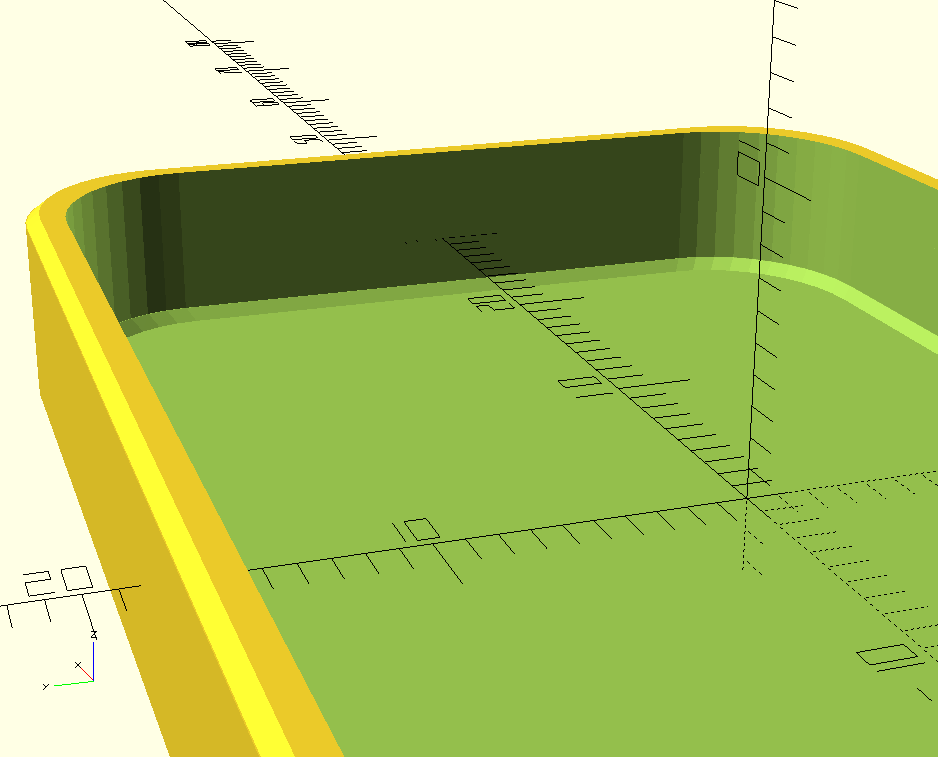

On 30.11.23 13:19, pproj--- via Discuss wrote:
Yes it seems that the namesaces overlap.
here is a take on it using only constructive lib skin funtionality ( i
like your extrusion approach too)
include <../devlibs/constructive/constructive-all.scad>
Wo=34; Lo=60; Wi=23; Li=34; H=5; Ro = 8; Ri = 3; T=1.4;Off = 2.0;
$skinThick =1.4;
assemble() {
    addRemove(Z(margin(.1)),TODOWN(),height(skin(H)))
            chamfer(down=-1,up=-.15,side=-Ro,fnCorner=40)
i am not quite sure what bobs code was supposed to look like, so this
is only a first take.
more on skins in constructive here:
https://github.com/solidboredom/constructive/blob/main/tutorials/tutorial-partIII.md#easily-create-skins-with-skinsize0-skinthickskinthick-walls2-marginmargin

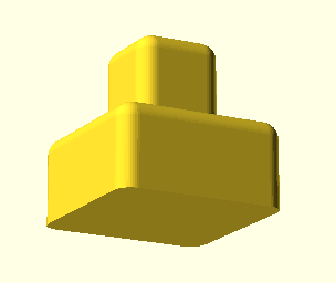

I thought something like that should be doable with minkowski() and came
up with a module in the attached example:
round_edges_except_bottom(radius). It 3D-insets an object, then
minkowskis it back to original size using a cylinder capped with half a
sphere.
