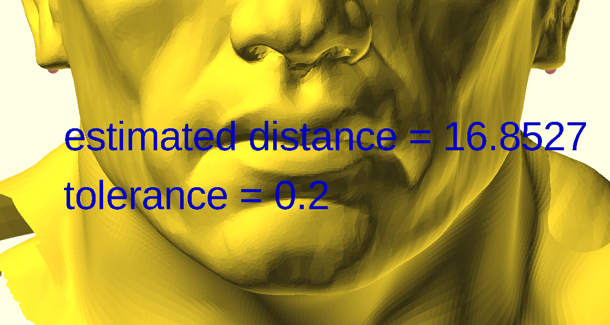

Ray West
Sat, Sep 4, 2021 11:18 AM
Thought I'd try it with an stl. No problem. can easily reduce the
tolerance sphere, once it's located near enough. In this example the
distance between bottom of ear lobes (no idea of scale.) If it takes too
long to render, can always temporarily remove the region that is not
needed for measuring.

Thought I'd try it with an stl. No problem. can easily reduce the tolerance sphere, once it's located near enough. In this example the distance between bottom of ear lobes (no idea of scale.) If it takes too long to render, can always temporarily remove the region that is not needed for measuring. On 03/09/2021 07:39, Rob Ward wrote: > Thanks whosa', I like the sound of that. More logical and easier than > I expected. > Cheers, RobW > > > On 3 September 2021 9:14:01 am AEST, Whosawhatsis > <whosawhatsis@gmail.com> wrote: > > If you use the background modifier (%) for your measurement > object, it won't interact with the rest of your model, so the rest > of the model SHOULD be able to load from cache and not need to be > re-calculated. Sometimes preview is still slower than you'd like > when nothing has changed if the model is particularly complex, but > it will always be faster if the program isn't trying to do boolean > operations involving any of the parts you've modified since the > last preview. > On Sep 2, 2021, 16:01 -0700, Rob Ward <rl.ward@bigpond.com>, wrote: >> Just thinking. But how is it best to position a measurement >> checking object quickly around a model that could take many >> minutes to render? How is it best to cache the model and just >> have the measurement part redrawn each time? It is still "check >> by eye", but I have found repositioning the test object painfully >> slow at times. >> Cheers, RobW >> >> >> On 3 September 2021 7:21:32 am AEST, Jordan Brown >> <openscad@jordan.maileater.net> wrote: >> >> On 9/1/2021 6:04 PM, Ray West wrote: >>> >>> I don't use the customizer, I tend to put the variables i >>> want to change at the top of script. >>> >> >> ... which is what the customizer wants, so there's a decent >> chance that it will just work for you. >> >> _______________________________________________ >> OpenSCAD mailing list >> To unsubscribe send an email to discuss-leave@lists.openscad.org > > > _______________________________________________ > OpenSCAD mailing list > To unsubscribe send an email to discuss-leave@lists.openscad.org
Sat, Sep 4, 2021 11:43 AM
Looks like you are using # rather than %. # will highlight pink but still
be included in the model. % will be transparent grey and not included in
the model.

Ray West
Sat, Sep 4, 2021 1:01 PM
HI Nophead,
I  used your suggestions wrt the alt and up/down arrows, (and the norm)
and it makes the process far more usable, and I've used the % too, but
in this case, it was a bit distracting in the grey, due to transparency,
to locate the spheres where I wanted them, and for the final positioning
I removed the %, and lived with the possibly slightly slower rendering
in this example.
Having revisited it, I find that rendering times for moving a sphere
around in this particular stl file,  seem to be very similar, between
0,036 and 0.079 in both cases (i.e. with and without %.) - removing the
text lines, rendering (based on half a dozen or so alt/arrows)  lies
between 0.038 and 0.043 for the yellow, and 0.026 and 0.042 for the
transparent, which explains why I noticed no difference in speed of
still be included in the model. % will be transparent grey and not
On Sat, 4 Sept 2021 at 12:19, Ray West <raywest@raywest.com
